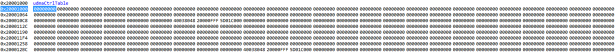

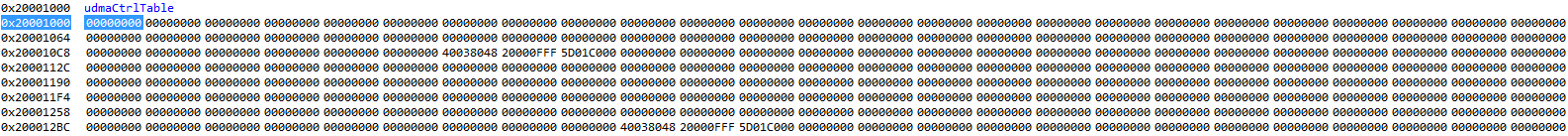

There are quite a few posts already pertaining to using the uDMA with the ADC on the TM4C123GH6PZ. I have gone through and pulled a lot of code from other examples to try and get a working piece of code (specifically here).
I call ADC0Init() from my main and the ADC and uDMA initialize. ADC0IntHandler() is set as the interrupt handler for ADC0. I periodically call GetCPUTemp(). With a breakpoint in that function, I notice that my ADC_OUT values are always 4095. ADC0IntHandler() is called, switching off between the two returning if statements. Is my arbitration size correct (16 * 8 = 128)? Am I missing a configuration setting? Is this the proper way to read the data transferred by the uDMA from the ADC?
I've attached the relevant code and an image containing my uDMA configuration table.
Cam

  • Hello CamK,
    Are you trying to read the temperature from the internal temperature sensor of TM4C or from and external sensor?
    If you are reading from the internal temperature sensor, did you refer the file: "./examples/peripherals/adc/temperature_sensor.c"? This example does not use uDMA, but this be accomplished before using uDMA.
    If you are reading from an external temperature sensor, does the setup work without uDMA?
    And lastly, do you require using uDMA? For most cases the required through put could be achieved by using interrupt. It takes time and effort to set-up the uDMA correctly and could also take up effort to maintain a code that uses uDMA. So please weigh the effort vs benefits of using uDMA before you make a decision.
    Sai
  • Hello Sai,
    Thanks for the reply. I am attempting to read the internal temperature sensor along with some various other analog signal levels. I took a look at the example and I use the same equation for calculating the temperature in degrees C (though it has been converted to a different form). I have completed and tested a version of the code that works using interrupts. I get back realistic values for all of my measurements.
    I'd like to use the uDMA, but this code results in all of the ADC values returning as 4095. I don't see any glaring mistakes and was hoping someone else may see something or offer suggestions. The code is very similar to some previously posted here on the forum (modified to fit my needs).
    Cam
  • Hello CamK,
    Did you make any progress? If not, I can try to use uDMA to read the internal temperature of the MCU and get back.
    Sai
