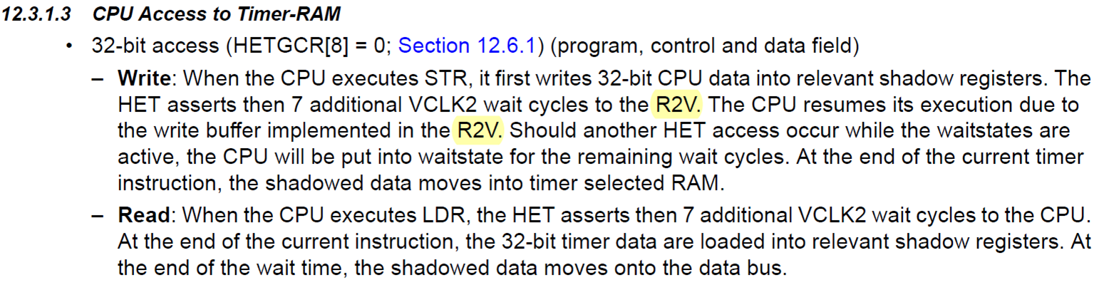

Hello TI,
I was going through the HET section of the TMS470M Series Technical Reference Manual(Rev. C)
On pg. 595, under section "12.3.1.3 CPU Access to Timer-RAM" there is a refrence to 'R2V'. I am unable to track what is R2V and need your support for the same.
The Manual reads:-
