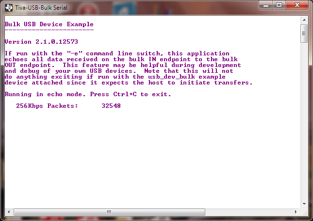

Good Evening everybody,
I have been working on an application that gets data from an ADC chip and streams them over USB using bulk transfers. Much of the effort that relates to this work has been described in this post. Key features of that application are:
  • Data transfer from the ADC to the MCU over SSI (SPI) is performed using an external interrupt on the MCU; the DOUT line of the ADC goes low when a new result is available and this fires an external interrupt whose ISR gathers the data.
  • Data are stored in a multiple buffer in a circular fashion; when that buffer is halfway full, data are sent over USB to the host application of a PC starting from the "top" (the beginning) of the buffer. This has been implemented and tested in another application. USB raw data are observed using a monitoring application.
  • One of the ADC channels is connected to a sinusoidal signal that is supplied by a signal generator. If everything worked properly, a plot of the data would be an exact replica of that signal.
  • Data from all activated channels of the ADC (3 channels) are stored in the following form: <channel 0 data><channel 1 data><channel 2 data><channel 0 data><channel 1 data><channel 2 data><channel 0 data><channel 1 data><channel 2 data>...
But monitoring the USB raw data reveals that what is stored to the host PC's disk is not of that form but some data are lost.
I checked things thoroughly in the debugger and noticed the following:
Each part of the multiple buffer is 192 bytes long. What I do in the MCU's code is that I send data over USB every 192 bytes. I have set BULK_BUFFER_SIZE to 384 bytes instead of 256 bytes, like in the USB bulk example supplied with TivaWare. However, after the 128th byte - or after the 64th byte - data are lost.
What is more strange is the fact that data loss happens when sending those over USB; the data stored in the MCU memory are intact and are copied byte-to-byte to the USB TX buffer correctly. Please refer to the function that performs that task at the end of this post. Moreover, that function does not return the number of bytes that are written to USB but it adds 128 more bytes.
It seems that I have not understood in depth how data are sent over USB using the buffers in the usb_dev_bulk example.
Any ideas, anyone? This might have a simple solution but I have become blind after exhaustive work on this...

  • Hello George,
    Did you check the value of the parameter "ui32MsgValue" when the callback function assigned for the transmit data channel is called? In the USB Device Bulk example this call back function is called "TxHandler".
    Also who calls the function "SendDatatoHost"? What is the value passed to the parameter "ui32NumBytes"?
    Sai
  • Hello Sai,
    I checked the value of ui32MsgValue and it is equal to 64. The TxHandler() function is entered twice before returning to SendDataToHost(). That's why SendDataToHost() returns 128 more bytes than what I expected to.
    Here is the code for TxHandler():

  • Hello Geroge,
    One issue I saw in the function "SendDataToHost" is that irrespective of the space available in the buffer "g_pui8USBTXBuffer", "ui32NumBytes" bytes are copied into it. The variable "ui32Count" (which has the available space in the buffer) is not used to decide how many bytes should be copied into "g_pui8USBTXBuffer".
    Not sure if that is the cause of your error, but can you correct that and then try and see if the error is resolved?

  • Hi George,
    Didn't read through your program but know we had to up it to 2048 bytes or lost data at the PC side. You can enable the bulk flow transfer message to print your flow rate achieved in the USB pipe. Ours was topping 256Kbps sending text message strings at continuous default buffer rate may have been 192 chars/sec or so and been some time ago.
  • BP101 and Sai, thank you for your contributions.
    I made the following changes in SendDataToHost() and now the samples of the sinusoidal signal that is connected to one of the 3 ADC channels seem to match a signal without discontinuities:

    I checked things both with low and high sampling rates and with all 3 channels enabled; in all cases, the samples of the sinusoidal signal show no discontinuities.
    Thanks again for helping me towards the right direction.
  • We scrapped that function and write bulk USB ring buffer directly testing for overflow buffers each pass.
    Keeping the buffer hand shake fairly simple.
