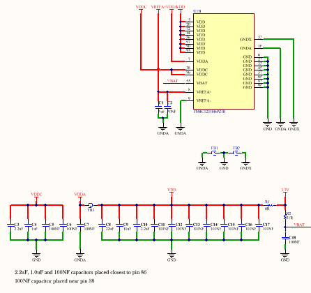

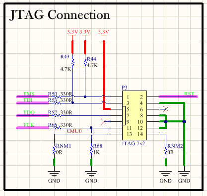

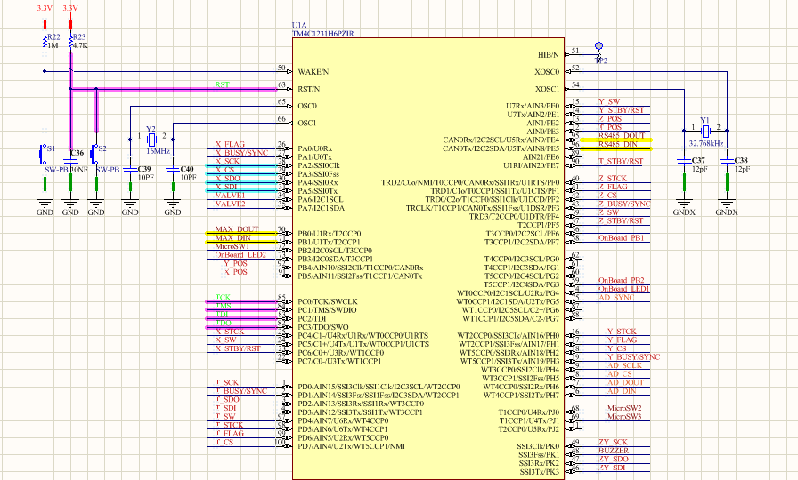

Hello Ti's experts,

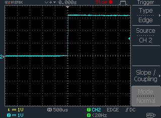

It is about one year that I am using TIVA microcontroller in all of my boards, I didn't have any problem with them at all. but these days strange event occurred with my new boards, after several programming microcontroller doesn't work, but it is work when debugger is connected. I checked RESET PIN it is pulled low by microcontroller about 0.5v but when this problem doesn't occurred it was 3.3V and worked normally. also I changed 4.7k pull up resistor and used stronger pull up about 1K and its begun to work but after several programming microcontroller doesn't work at all even with debugger, in this situation I checked VDDC is 1.8V but microcontroller doesn't work.
about five microcontroller burnt with this behaviour in two boards about one week.
this is my first experience with TM4C1231H6PZIR before that I used TM4C1294, 1230,123 and ... without any problem with similar circuit.
attached is the schematic.
any help would be greatly appreciated,
