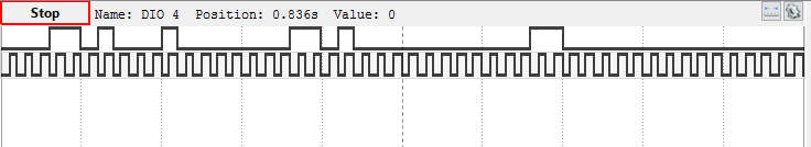

I am using TivaC TM4C123 MCU. I am trying to send data serially through one pin and a synchronized clock through another pin. Here is an illustration:
I used Timer0 module for the serial data and Timer1 for the clock. The frequency of the clock should be twice the data. Here is the important part of the code:

There is a problem in this code, which is both of the data and the clock have the same frequency, which means that Timer0 or Timer1 are disabled.
To make my problem more clear and easy to understand. I wrote two simple codes with a graph for each of them. Here is the first code: I am using While loop
  int main()
    GPIO_INIT();
    TIMER_INIT();   //Timer0= 1/2 Timer1
    while (1){
     while((TIMER0->RIS & 0x00000001) != 1){}   //Wait for TIMER0 to time out
     GPIOF->DATA ^= (1<<1);   //Toggle PF1
     TIMER0->ICR |= (1<<0);   //Reset TIMER0 flag
     while((TIMER1->RIS & 0x00000001) != 1){}    //Wait for TIMER1 to time out
     GPIOF->DATA ^= (1<<2);    // Toggle PF2
     TIMER1->ICR |= (1<<0);    //Reset TIMER1 flag
Here is the output I got:
Here is the 2nd code: I am using If condition
int main(){
GPIO_INIT();
while (1){
if((TIMER0->RIS & 0x00000001) == 1){    //If TIMER0 out timed out
  if((TIMER1->RIS & 0x00000001) == 1){   //If TIMER1 timed out
  GPIOF->DATA ^= (1<<2); //Toggle PF2
Here is the output:
Conclusion: When I used the if condition the two timers are working normally, but when I used While loop only one timer is working and the other timer is just using the same counts of the other.
