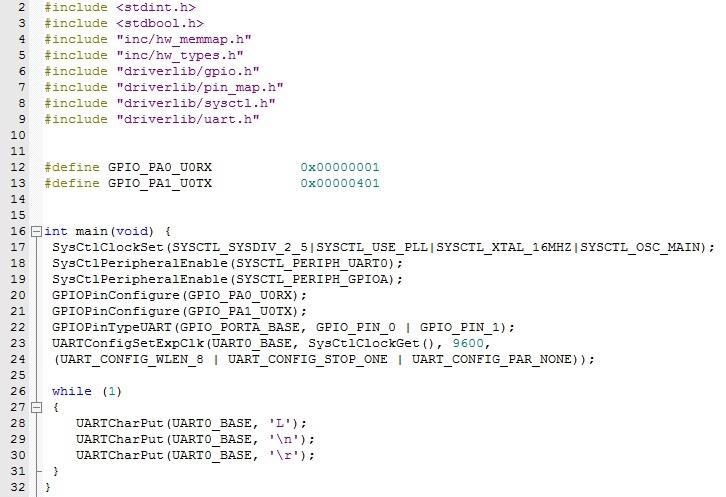

Hello All,
I made some modifications to the Tivaware UART application to send an integer value to the PC (A test program). It is working fine with 115200 baud rate (115200, 8bits, no parity, no flow control, 1 stop bit). When I changed the baud rate to 9600, some weird characters started appearing on the screen. I tried with Hyperterminal and Putty  with same result. Even if I get the desired output, it changes after pressing the reset button on TIVA C LaunchPad. Program and screenshot is attached for your reference.

    Your code listing reveals your changed baud rate w/in TM4C - but you don't confirm that you made that same shift to 9600 at your PC.   Did you?   And did that change - if you made it - impact any other of your PC's serial settings?

    The code configures the UART in the Tiva device and then enters a loop which transmits characters continuously as quickly as possible.
    When the Tiva device is reset the UART Tx pin will be left as tri-state until the software initializes the UART. When the Tiva UART Txx pin is tri-state, the receiving UART may not see a valid input which means when the Tiva starts transmitting means the receiver may correctly synchronize to the start bit.
    Try one of the following to see if that allows the correct characters to be received by the PC:
    1) Attach an external pull-up resistor to the Tiva UART Tx pin.
    2) Change the software in the Tiva to insert a delay, say at least two character times, between initializing the UART and starting to transmit.
    Either of these changes should hopefully allow the UART receiver to see the Tiva Tx as idle before the transmission of characters starts.

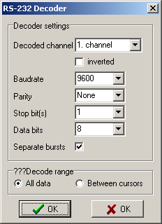

    To demonstrate this, I put your code in a launchpad and used a LSA to capture the UART transmission. The launchpad was left continuously outputting characters and a capture started on the LSA. The LSA was set to decode the UART stream with 9600 baud, 8 data bits, no parity and one stop bit:
    On some captures the LSA decoded the expected character sequence:
    On other captures the LSA decoded an unexpected character sequence, without detecting any error, since remained incorrectly synchronized:
    Another variation was a stop bit error, invalid character but then synchronized to the expected sequence of characters:
