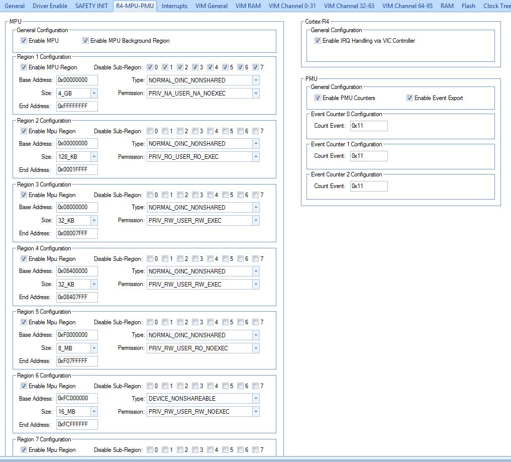

I am trying to configure the MPU of TMS570LS0332 in HALCOGEN.  I do not see the following lines of code in sys_startup.c file in the generated code even though i enabled the MPU in R4-MPU_PMU tab of HALCOGEN.
#include "sys_mpu.h"
/* MPU initialisation as per the HALCoGen GUI */
_mpuInit_();
Please find the attached file for R4-MPU_PMU tab settings of HALCOGEN.
Thanks in advance.

    I think this query was about if the _mpuInit_() function gets called in the HALCoGen generated code for _c_int00() or not.
    E.g. with HALCoGen 04.05.02 found that:
    1) When create a project for a RM46L852PGE on the "R4-MPU-PMU" tab the MPU is enabled by default. However, the _mpuInit_()  function isn't called by the HALCoGen generated code for  _c_int00() in sys_startup.c
    2) When create a project for a TMS570LC4357 on the "R5-MPU-PMU" tab the MPU is enabled by default. The _mpuInit_()  function is called by the HALCoGen generated code for  _c_int00() in HL_sys_startup.c
    Is it intentional that for Cortex-R4 devices HALCoGen has the MPU enabled by default on the "R4-MPU-PMU" tab, but omits to automatically call the  _mpuInit_()  function during the system startup?
    I wasn't sure if the reason _mpuInit_()  function get called automatically during system startup for the Cortex-R5 devices was tied into the use of the processor caches.
  • Hi Chester Gillon
    We are using HALCoGen 04.05.02.  This is not same for 2 Cortex-R4 devices as well.
    We have another HALCoGen project for TMS570LS0232 in which the mpuInit_()  function is called by the HALCoGen generated code.  TMS570LS0232  and TMS570LS0332  are  Cortex-R4 devices with change in flash size.
