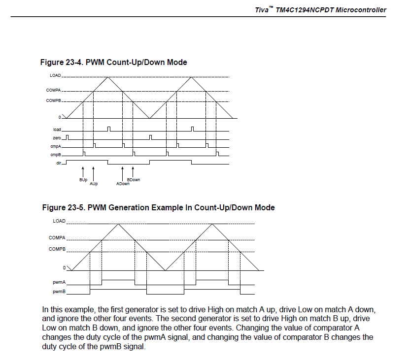

Is it possible if the PWM modules generators duty cycles or pulse width (if different values) are not staggered in descending monotonic order (Fig 23-5) PWMnCMPB might ignore synchronous updates of this register?
Notice datasheet 23-5 suggest center aligned overlapping signals and illustrates CMPB has roughly 20% more duty cycle than CMPA.
What happens if CMPB match value is higher than CMPA match value and how does that monotonic reversal affect dead band generators performance?

    Bravo - the door (now) opens - possibly admitting the fact that individual coding sequences - and/or functions - (may) explain the difficulties you've (oft) reported.
    I do not believe that the example (23-5) imposes ANY (at all) "linkages" between PWM_A & PWM_B.  Instead - as my past scope-caps prove - it is, "When and only when" - Deadband is Enabled/Imposed  - that any such linkages occur.  Further - that 20% "difference" you note - is purely (and entirely) the result of deadband parameters - active only when deadband is enabled.   There is NO/ZERO such "20%" "PWM difference" - established via design.
    What myself - and others suspect - is that (somehow) you've missed the fact that PWM_B (fully) loses its independent duty cycle control - upon the simple enabling of deadband.  (even when (both) deadband parameters are set to zero.)  Instead - again as my multiple (past) scope-caps reveal/confirm - the imposition of deadband forces PWM_B into an "Inverted form" of PWM_A - yet w/the presence of (parameter dictated) deadband (guardbands) upon PWM_B's (leading & trailing) edges.
    Thus - whenever PWM_A is logic high - PWM_B must be logic low.   And if deadband parameters are non-zero - dual guardbands will "bracket" PWM_B's leading and trailing edges.
    As many here have long suspected - it is likely that your methods and/or sequencing of  deadband functions - have caused (or at least been major contributors) to your reported issues.
    Such explains why MANY here have requested your presentation of the shortest code block - which causes/confirms your issue - so that your peers may fully/properly (and maybe) duplicate your findings...   Or not...
    Note: there are many possible code sequences - it may just be that the "one" you've chosen - has caused you such distress - and the opportunity to enlist the aid & support of multiple others - should (many believe) receive your full & prompt attention...

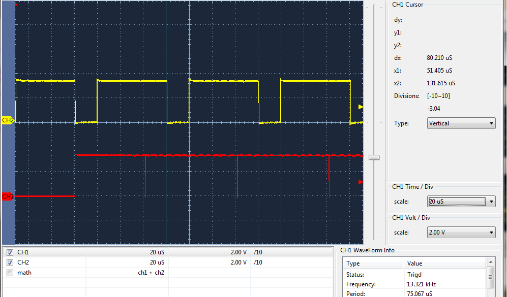

    As the author of the above writing - I plead "temporary insanity" - and note that "shock treatment" (legal, my state) "may" have worked.
    What I intended to write was that the difference between, "duty cycles" (PWM_A vs. PWM_B) as illustrated w/in 23-5 - resulted entirely from the different duty cycle values - programmed into that pair.  (PWM_A & PWM_B)   I would wager a large (even huge) sum - that even two identical such duty cycles may be programmed into that pair - and that identical and overlapping pulse outputs would result!
    Again - PWM_B is an entirely "independent, PWM operator" and becomes "bound/linked" to PWM_A - only when "Deadband is enabled."   That 20% difference in duty cycle - which you noted - is due ENTIRELY to the "duty cycle" values programmed into PWM_A & PWM_B.   There is absolutely NO/ZERO ~20% (offset) or deviation which exists by deliberate MCU design!
    When the deadband becomes enabled - and "large" parameter values exist - PWM_B "loses its independent duty cycle capability" instead becoming the "inversion of PWM_A - and differing from a "pure" inversion by the magnitude of the 2 (leading/trailing) deadband parameters.

  • Occurs if dead band is disable and the resulting pulse width pwmB should closely match pwmA with added edge delays. As stated there is never ever a delay being added to the pulse width of pwmB. Something in the architecture of 3 phase commutation is causing HW failures.
    Seemingly monotonic order of a timers count slope and comparator reactance to matches in that slope are tied together.

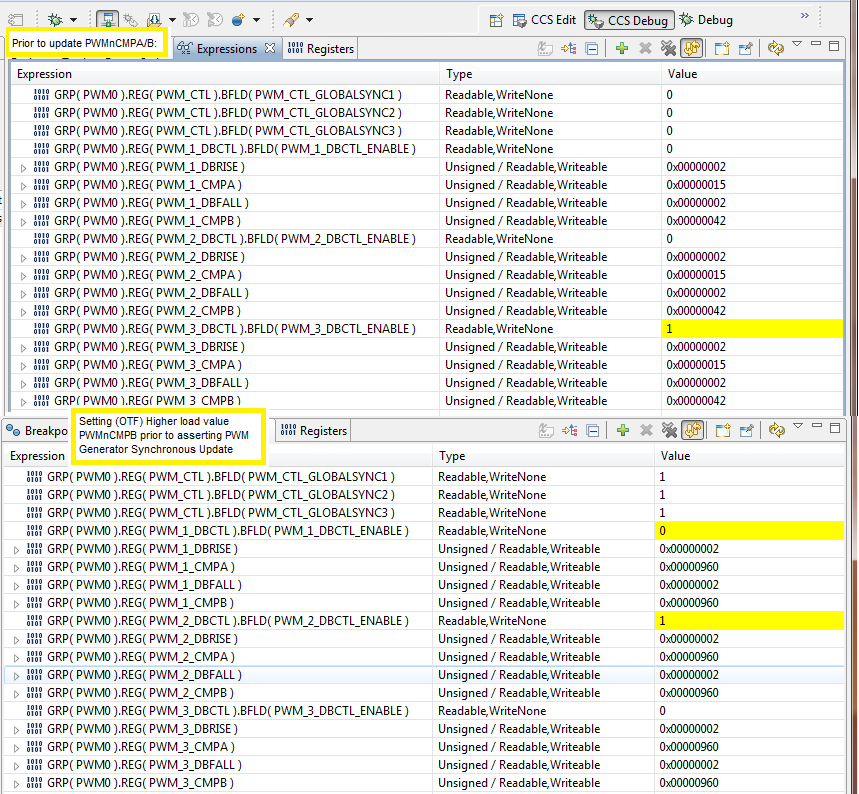

  • Again PWMnCMPB match value is higher than PWMnCMPA lower match value in the incrementing and higher decrementing timer count values respectively.
    That is a complete reversal to figures 23-4/5 which seem to infer but never elaborate in text that CMPA should never be less than CMPB in up counts. Likewise CMPB match value should never be more than CMPA match values in down counts.
    Very hard to elaborate and keep confusing match value to the resulting pulse width and duty cycle that occurs as a result of reverse monotonic orders.
    Notice CMPB(42) value is higher than CMPA in (1st monitor) yet a narrow pulse/width (75% duty) results CMPB and (40% duty) results from CMPA(15). From that point on and forever more CMPB(960) (2nd monitor) results after a PWM synchronous update, timer refuse to use the new value CMPB(960).
    CH2-CMPA, (1st/2nd register monitors) CH1-CMPB (2nd register monitor)

  • Today reversed the 3 PWM GEN-A/B in HW and SW; same thing occurs opposite comparator, CMPA drops or toggles the falling edge during the dead band delay period yet CMPB delivers a crisp rising edge delay added to each synchronous pulse width update.
    The odd thing is the pulse width CMPA never seems to get a synchronous update after transitioning into fast decay. Other words it retains the divided period (purposefully) set in slow decay after switching into fast decay mode.  Recently added (PulseWidthSet-B/2 and C/3) as a marker for the scope captures to know if fast decay had preformed a synchronous update during the transition. UARTpintf statements placed in each decay mode confirms entry to each mode retains rock solid.

    You might notice the synch update of unused GEN0 (required) or commutation stalls during decay mode transition. That seems to indicate GEN0 is some how the master for synchronous updates. Noticed the CCS debug register view disabled GEN0 had a zero count interrupt and ADC trigger enabled after POR, repower. After configuring GEN0 and disabling the trigger and zero interrupt the PWM0CTRL was returned to POR defaults of 0x0.
  • The issue and past posted for TI engineers a sample DB test example. That example added synch updates, shows failure to add PWMnCMPA pulse width to pwmB dead band generator pulse width and static duty cycle. Later discovery reveals that occurs  when CMPB match value during sync update is far less than CMPA match value.
    This find tends to infer either the tool chain is bugged or the HW is not capable to (properly) distribute dead bands in 3 phase motor commutation of near equal pulse widths of the duty cycle not the minimum pulse width.  Again the release SW into public domain did not ever enable HW dead band generators and instead created a (MOCK delay period) and seemingly somehow jams the match count of CMPB  register. The same exact condition occurs CMPA in the reversal of 3 PWM generators low side moved to high side respectively in  SW and HW.  Benefit of patch is the minimum pulse width never drops to the MOCK dead band delay period as it once did.
    The SW patch posted Robert's reply removes  jam condition produces near equal (minimum) pulse widths CMPA/B. However the duty cycle % between CMPA and CMPB is highly uneven at any given time after transition to fast decay mode in synchronous updates. The duty cycle % should become near equal in fast decay but only the minimum pulse width remains equal being set in slow decay. The duty cycle  % CMPB produces very small changes even when both PWM dead band generators are disabled allowing PWM0 pass through matched values in the synchronous update. Updates CMPB are being ignored by the timer and never produce a wave form pulse equal to the actual match value loaded (960) even in the pass through dead band untouched.
    Agree it seems that DBG is always enabled. Yet CCS register watch shows it is not even after several updates the wave form never matches CMPB match value and today CMPA after reversing the low for high sides architectures.

    Again to reiterate the base problem: The low side pulse width (required to start MUT in sensorless mode) set even to 85% duty and some minimum pulse width, CMPB refuses any post updates causing a fixed duty cycle at the minimum pulse width setting. Same issue occurs in the reverse scenario using CMPA near 85% causes a fixed duty cycle of LO. Again the duty cycle of LO must be set near 85% to develop smooth phase current which results in post updates of either comparator from receiving duty cycle changes. That scenario occurs even when dead band is completely disabled at all times. While leaving dead band enabled produces near equal but inverted duty cycles HO/LO can not be used to start the MUT in sensorless mode being slow decay is required to get the rotor to even move in open loop commutation.
    And setting dead band all 3 generators in fast decay mode has no effect to stop a static duty of either CMPA or CMPB which ever is used to produce LO.
    A no win scenario since LO must be initially set much higher duty % than HO to get the rotor to even move. That directly causes either comparator as LO to ignore synchronous updates and the duty cycle remains static as set in slow decay.
    The only time pass through dead band seems to occur is when the PWM zero interrupt is being delayed in the synchronous update process. Hence this some kind of timing NVIC issue between PWM0 and the dead band generators refusing to decouple while the PWM zero load interrupt is being serviced.  That was the reason for posting the interrupt priority table being the PWM zero interrupt has been discovered to play some part in the PWM sync update failure.
  • BTW the only time dead band generators decoupled from PWM0 in synch updates is when ADC0 interrupt handler was reprogramming GPTM1A, a one shot FOC commutation timer. That brief DB decoupling was highly disruptive and often lead to MUT stalling just after entering closed loop commutation.
    Had to move the DB control code out of the update and back into 6 step PWM output drive function. That stops dead band decoupling PWM0 when GPTM1A is being reprogrammed and transition of open to closed loop commutation remains 85% static LO.

  • My friend - for the Nth time - PWM_B - when deadband is enabled - appears ONLY and ALWAYS - as an inverted replica of PWM_A.   (and may include both leading & trailing "guard-bands" - equal to the deadband parameters)   Thus - you have NO/ZERO direct control over PWM_B when deadband is enabled!

  • There is no miracle fix for CMPB in setting an initial low match value and CMPA much higher match value during synchronous updates. Lock condition CMPB (partially) self corrects allowing pwmA dead band pulses to propagate during gen global sync updates when DBENABLE bits might be set or cleared during PWMENBLES (local sync update) individual pin states only by the following methods.
    1. Subtract a minimum pulse width value from CMPB load matches during synchronous updates.
    2. Use CMPA value as a constraint and control over the (wide range) of duty cycle changes during global synchronous updates.
    Results in pwmB producing low side PWM pulses in nearly equal value to pwmA steady state pulse width. The goal is to achieve balance in the PWM distribution of inverter bridge phase drive outputs and keeping fairly equal high and low side phase pulses during steady state. One can not judge inverter pulse width balance by scoping pwmA/B gate drives as the PWM produced differs.
    Note the (JAM) load of CMPB match results in stopping PWMnDBFALL synchronous updates of the immediate, zero count, or global type from naturally occurring.
