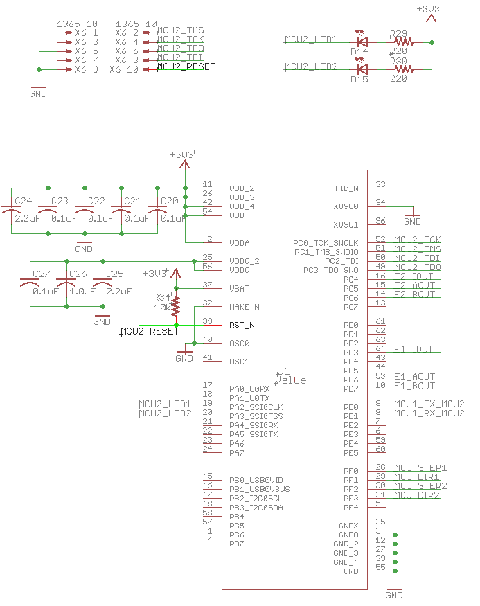

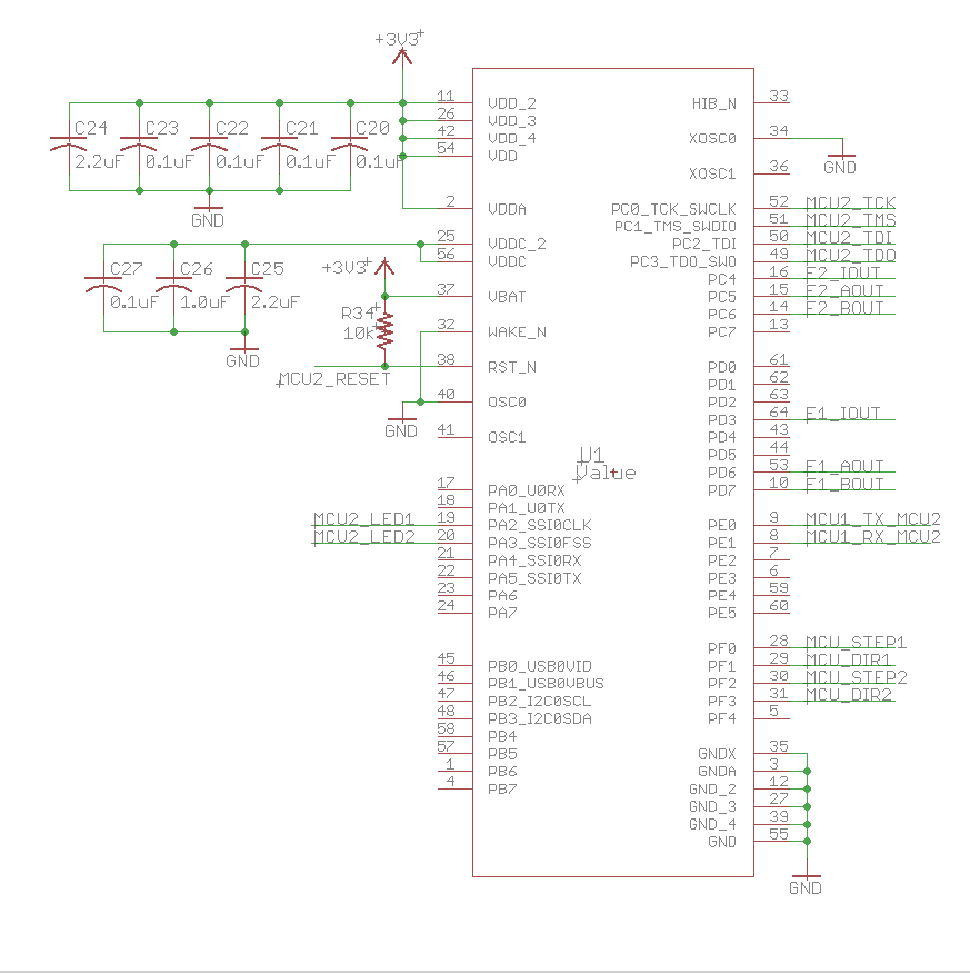

I am attempting to bring up a custom board which has one TM4C1294NCPDT and one TM4C123GH6PM. I am attempting to program these devices using the 'debug out' feature of the TM4C1294 launchpad. Attempting to program either device results in a "CORTEX_M4_0: Error connecting to the target" message.
To keep things simple, I am focusing on the TM4C123 device for now. Here is what I checked so far:
  • VDD is at 3.3V, with about 100-200mV ripple observed at decoupling caps. All VDD pins are connected.
  • VDDC is at 1.2V, with about 100-200mV ripple observed at decoupling caps. This net is not shared with any other devices. All VDDC pins are connected.
  • All GND pins are connected.
  • RESETn is pulled up to 3.3V with a 10K resistor.
  • Continuity check between the following JTAG signals on target board and X1 header on the Launchpad showed a good connection: TMS, TCK, TDO, TDI, RESET, GND.
  • All resistors were removed from the X1 header on the Launchpad; R40 was removed as well.

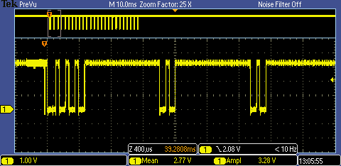

  • Brief activity is observed on TMS, TCK, TDO, TDI on the target side when attempting to program the device.
Here is what the activity on TDO looks like. Except for the first burst of activity, all subsequent bursts have the pattern seen in bursts 2 and 3. This continues for about 30 milliseconds.
This is how the TM4C123 hardware is set up. My intention is to run the device from PIOSC.
I am using CCSv6.1.3.00033. I haven't had any problems programming TM4C chips on launchpads before, but this is the first time trying to use the 'debug out' feature.
Any suggestions on what I should investigate next?
    I recommend to add 10k pull-up resistors for TCK and TMS. The external pull-up resistors are not required if the JTAG connections are short. But if the JTAG signals are greater than 2 inches, TCK should be pulled up with a 10k resistor to prevent any transitions.
    QJ
  • Hello QJ,
    I soldered 10k pull-ups from 3.3V  to TCK and TMS, but it did not help. The rise time and amount of noise on the JTAG signals looks accepatble with or without the pull-up resistors (max 1us rise, a few hundred millivolts noise), although there is quite a bit of overshoot and undershoot - as much as +/- 1V!
    The connection between the ICDI emulator and the target is simply a SAM8219-ND cable from X6 on the Launchpad to an identical header on the target board, about 1 cm from the target microcontroller. The SAM8219-ND cable is 1 foot in length, unshielded. The JTAG nets are connected directly to the target microcontoller over fairly short and straight paths. They are not connected to any loops, long traces, or test points.
    Oliver

    I have attached a screen capture of the schematic for the TM4C123GH6PM and it's JTAG header. Let me know if you need a more complete schematic; I will need to check on legal restrictions.
    We neglected the VTARGET connection for pin 1, since the design was based on (and intended for use with) the Launchpad ICDI circuit. However, we can easily make this connection manually between the 20-pin header of the XDS100 and a test point for the 3.3V supply on the target board.
    Thanks again,
    Oliver
  • Hello Oliver,
    You are using ARM10-pin header but referring to 20 pin header on the XDS100. Do you intent to wire the JTAG manually?
    I would suggest soldering a wire for Vtref.
    Amit
