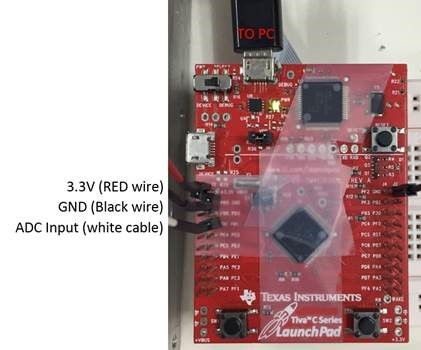

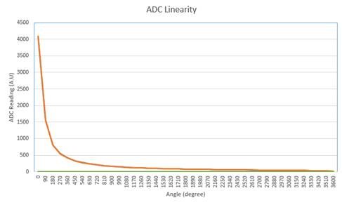

  In my design with TM4C123GH6PM, I met below problem, please advise how to solve the issue?

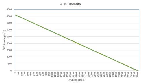

1. I used GPIO PD1 (AIN6) as ADC input to read potentiometer value (0-3.3V). Everything work well, the potentiometer reading is linear.
2. After I configure another port (GPIO B7) as PWM output (M0PWM1), The ADC reading become non-linear.
3. If I disable the PWM configuration, then everything become normal. Any advice for this?
   By the way, I use VisualStudio with tivaware library TivaWare_C_Series-2.1.0.12573. And Same behaviour when I switch to Code composer studio.

  • weiji jiang said:
    GPIO PD1 (AIN6) as ADC input ...  Everything work well, the potentiometer reading is linear ...  configure port (GPIO B7) as PWM output (M0PWM1) ADC reading become non-linear.
    While vastly superior to (famed), "Does not work!" would not (some) mention of the degree/extent of reported, "non-linearity" prove helpful?
    Further - might PB7 be driving a load which produces noise/spikes - or which "challenges" your board's power supply - either of which may disrupt the ADC's operation?
    Usually it proves helpful to employ another (different) ADC channel - and similarly - MCU PWM output pin/port.   Should the issue remain - a power disturbance is likely - if the issue clears - there may be an (unwanted) signal coupling (or leakage) between (chosen) ADC & PWM pins.

  • Hi Robert,
      Good day to you.
    1. The testing is done in the Tiva-C Launchpad. So I don't think there is filter problem. If I am wrong, please correct me.
    2. If didn't active PWM (To comment off Line 51-64 in the attached main.c), ADC result is linear when changing the potentiometer.
    3. If turn on PWM but no connecting to load (To uncomment Line 51-64 in the attached main.c), ADC result is Non-linear when changing the potentiometer.
    The ADC value did not fluctuate (+/- 2), so this finding is not caused by noise, and ADC operate normally. I tried other PWM0 GPIO and observe this issue too.
    4. See the main.c which used for testing.
    I don't believe the launchpad has any filtering so, yes, that is an issue.  In addition you need to have impedance matching on the input. Follow my earlier advices of searching the tags, the TI workshops were quite good.
    That is an overoptimistic assessment. There is a phenomenon called noise rectification.
