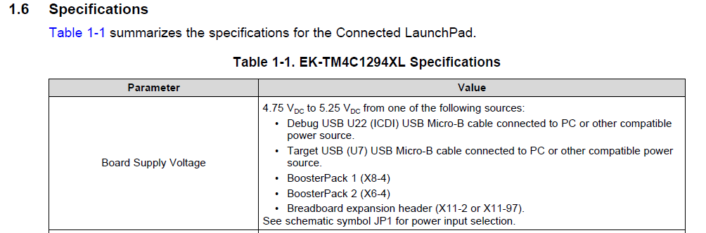

I've read most of the threads regarding powering a TM4C129x Launchpad from external power; but, I still can not communicate with the board once I re-wire for external power.     Some of the threads speak of the looking at the "lower left corner" or "VBUS" or "PB1 & VBUS" to attach power to.  I'd like to understand this in terms of the 98 X11 Connector Pins at the bottom of the board.
Setup...
1. Move JP1 (Power Select) from ICD1 to BoosterPack.  Correct?
2. Attach 5V external supply connected to X11 Pin 60 (VBUS) and Ground X11 Pin 62 (GND).
Questions:
I. Did I select the correct Pins to attach power to or
    (a) are there different X11 Pins that I should be using?  If so, what Pins are they?    similarly.....
    (b) Is there a completely separate two pins that I should be using?  IE. They are not a part of the 98 X11 Connector Pins at the bottom of the board.
          If so, what are they?
II. Did I miss something?  Need to use 3.3V?  JP3?  Other?
Thank you.
Rick

  • Hello Rick,
    You may also want to have a look at the connected launchpad user guide located at this link: www.ti.com/.../spmu365. Specifically, you may want to review section 2.2 on power management. The user guide also has the schematic of the board in it as well.
    Finally, there are a lot of threads within the E2E forum on this topic so a search may prove beneficial as well.

  • Hello Rick:
    It's not presented in as obvious a manner as you are looking for but I think this should answer your question ...
    Additional pinout information for X11 (breadboard connector) can be found on p.26 of the launchpad user guide.
  • Hi Chuck:
    If I hadn't spent time on the schematics per cb1- and yourself, this would not have made as much sense.
    The board is now powered up with no smoke coming from it. Thank you. This is very much appreciated.
