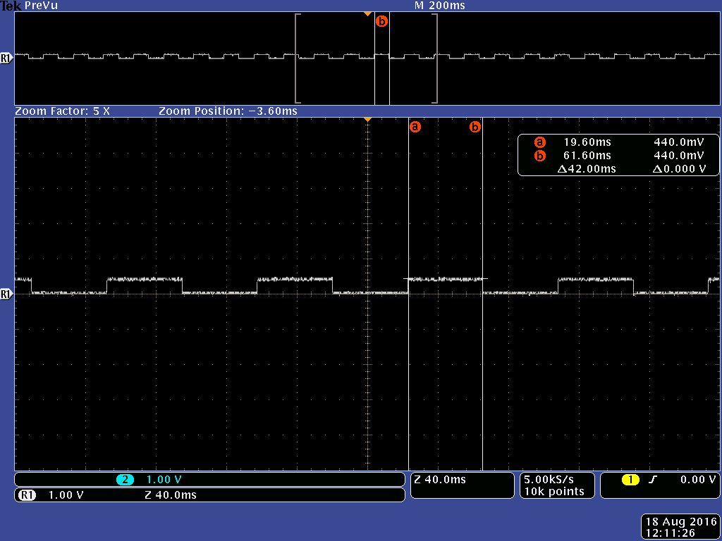

  • Hi Chuck,
    I added a piece of test code in the bitband example project from TivaWare_C_Series-2.1.3.156.
    The system clock is set as:
    // Set the clocking to run directly from the crystal at 120MHz.
    g_ui32SysClock = MAP_SysCtlClockFreqSet((SYSCTL_XTAL_25MHZ |
    SYSCTL_OSC_MAIN | SYSCTL_USE_PLL |
    SYSCTL_CFG_VCO_480), 120000000);
    The test code as:
    while(1)
    // Turn on the LED.
    GPIOPinWrite(GPIO_PORTN_BASE, GPIO_PIN_0, GPIO_PIN_0);
    Delay(2);
    // Turn off the LED.
    GPIOPinWrite(GPIO_PORTN_BASE, GPIO_PIN_0, 0x0);
    Delay(2);
    I measured the LED frequency as:  (The interval between on and off is 42 ms, it is not correct according to the delay setting)
  • Hi Henry,
    I agree that there seems to be something wrong with the delay/system tick interrupt period. Give me a bit to look into it and get back with you with a more definitive answer about what it happening.
  • Hello Henry,
    The problem lies in the initialization of the SysTick reload value. As it states in the driver library user guide and in the header of the flash version, the max value that can be programmed/passed is 16, 777, 216 since the SysTick counter is a 24-bit counter. The example is passing the value returned by SysCtlClockFreqSet which will be 120000000. This results in the incorrect value being programmed into the reload register and thus an incorrect time for the roll over of the counter.
    Note that the value of 1000 used in the Delay function for the compare of the return value of ROM_SysTickValueGet in the while loop is arbitrary since the main goal of this code is to delay for one wrap around cycle without using interrupts. Certainly this could be improved by enabling the SysTick interrupt but for the simplicity of this example it did not make sense to do so.
    To resolve the issue, I changed the reload register init to divide the system clock by 10 changing the reload value to 12,000,000 which is now within the acceptable range. This, however, changes the timer from a seconds timer to a 0.1 seconds timer so all values passed would need to be multiplied by 10 to get 1 second.

  • Hi Chuck,
    Thanks for your answer. I have verified that your code works well.
    Henry Xin
