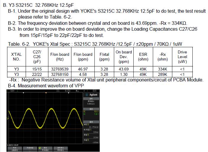

Dear Experts
Could you help me to check if this oscillator working for TM4C1294?
In the TM4C1294 datasheet, the DC level VIH is 0.8X3.3V=2.64V and VIL is 0.2X3.3V=0.6V.
We also tested the oscillator on EK-TM4C1294XL and the result is
480mV P-P with DC level +240mV ~ - 240mV
We tested below oscillator and the result is
325mV P-P with DC level +160mV ~ - 165mV
So is there any problem to use this oscillator for TM4C1294?
