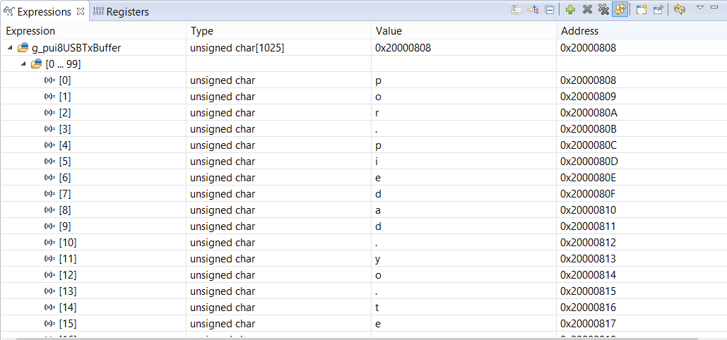

Hello every one,
I have made some modifications to the Bulk example code from Tiva_Ware, i want to send a simple word : "odiame", and I want to get from the TM4C a complete sentence "por piedad yo te lo pido, odiame sin medida, ni clemencia!!!!!!".
The problem is that when I send the word "odiame" who has 6 characters, I only get from the MCU the first six characters "por pi", not the complete sentence. and If you can se in the figure the sentece is complete in "g_pui8USBTxBuffer".
I dont understand why I only can receive the same number of character that I send. Obviously it was the first intention of the USB BULK example, but I have made some modifications:

//    strcpy(prueba,"equi ku");
//    ulLength = strlen(prueba);
    while(ui32Loopr)
        receptor[index] = g_pui8USBRxBuffer[ui32ReadIndex];
        ui32ReadIndex++;
        ui32ReadIndex = (ui32ReadIndex == BULK_BUFFER_SIZE) ? 0 : ui32ReadIndex;
        ui32Loopr--;
        index++;
    index = 0;
    strcpy(cmp,"odiame");
    if (strcmp(receptor,cmp) == 0)
    	strcpy(prueba,"por piedad yo te lo pido, odiame sin medida, ni clemencia!!!!!!");
    else
    	strcpy(prueba,"nada");
	while(ulLength)
		g_pui8USBTxBuffer[ui32WriteIndex] = prueba [index];
		ui32WriteIndex++;														// Move to the next character taking care to adjust the pointer for the buffer wrap if necessary.
		ui32WriteIndex = (ui32WriteIndex == BULK_BUFFER_SIZE) ? 0 : ui32WriteIndex;
		ulLength--;
		index++;
    USBBufferDataWritten(&g_sTxBuffer, ui32Count);
    memset(prueba,0,ulLength);
    return(ui32Count);

Thanks in advance
