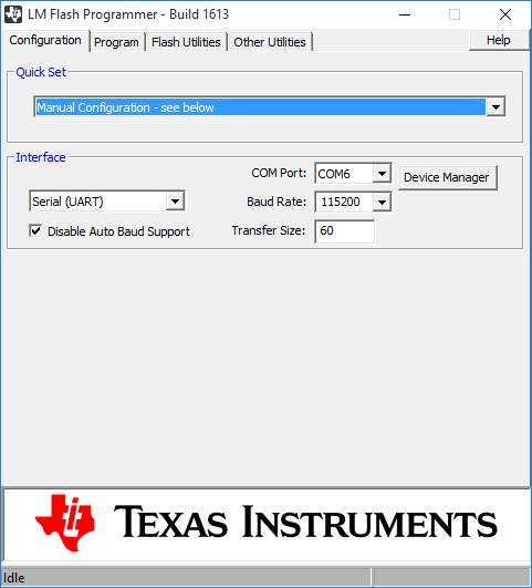

    3. Open LM Flash Programmer. Parameters:
    Manual Configuration
    Interface: Setial (UART)
    Disable Auto Baud Support - checked (if unchecked, the same result)
    COM Port: COM6 (Stellaris Virtual Serial COM Port)
    Baud Rate: 115200
    Transfer Size: 60
    .bin file: boot_demo1\Debug\boot_demo1.bin
    Program Address Offset: 0 (BTW, is this correct?)
    Click Program. button Error:

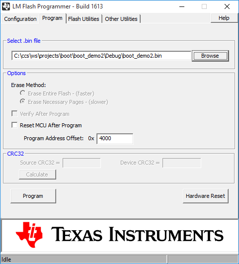

  • Thank you, got it working. The problem was in Erase Method Flash Programmer option. By default it is "Erase entire flash", so when I burn one program, I erase another program. I change it to "Erase necessary pages", and it started to work.
    In the beginning, I can burn boot loader and boot_demo1 using LM Flash Programmer JTAG interface, addresses 0 and 0x4000, Erase necessary pages. Then I reboot the device, LED is blinking. Press SW1, and not I can use LM Flash Programmer with UART interface, Auto Baud disabled, to burn boot_demo2.
    The same erase method should be selected in CCS project properties to burn the project from CCS.
  • Hello Alex,
    Can you please share a snap shot of the first 2 tabs of LMFlashProgrammer when selection boot_demo2.bin
    Amit
  • Hello Alex
    Yes, it looks correct. Did you make any change to the original project?
    Also try the same with the bin files already provided in the project folders.
