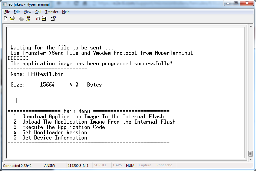

I am trying to get the TI bootloader (by QJ Wang) to work on the RM48 USB with a rm48l950. It runs, and accepts my .bin file but hangs on executing the binary file. The example code seems to have changes made at different times. And the wiki is a bit short.
I have downloaded spna190 & spna196. I am using spna196, actually bundled as the CAN Bootloader, because it was updated by QJ in Feb 2016.
I have edited the bl_config.h to match the other examples and to keep everything consistent with 0x20000 as the bootloader space.

After fixing the overwrites that were initially happening, the bootloader will now download the code, say successfully downloaded, and hang at execute.
Any ideas where I am going wrong?
