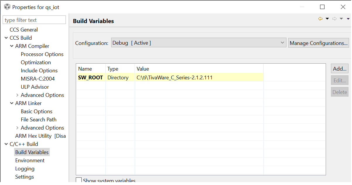

Hi everyone, I´ve been having this problem since a lot of time ago, when I want to import the CCSProjec example qs_iot from the TivaWare_C_Series-2.1.2.111 folder I get the following errors:
I think these errors may be caused by the following including options:
I've tried to add paths just like:
C:\ti\TivaWare_C_Series-2.1.2.111\examples\boards\ek-tm4c1294xl
etc...
But the issues carry on.
Probably the troubles are very easy to solve but the fact is that I just can't get it.
I would apreciate somehelp! thanks in advanced!
Martin
  • Hello Martin
    In the include option snapshot replace the second line with "${SW_ROOT}"
    Amit

  • Hello Martin
    What is the SW_ROOT variable defined as? In the Build Settings, select Build and then Variables in side-menu.
    If it is not defined then define it with the path to the TivaWare installed on your PC.
    Amit
  • Hi Amit, I've done what you said. Most of the errors have dissapear, howewer few of them remains:
    Do you know how can i solve them?
    Thanks in advanced
  • Hello Martin
    You would need to import the C files in CCS. It looks like all paths to the C files are broken.
    Amit

  • I've just re-installed the new version of the TivaWare_C_Series-2.1.3.156, the new version of the Lab files, the CCS and finally I leave the original workspace path proposed by the CCS. So when I compile the project, I modified the SW_ROOT build variable targeting it to the current TivaWare_C_Series-2.1.3.156 path and it works!
    Thanks Amit for your help.
