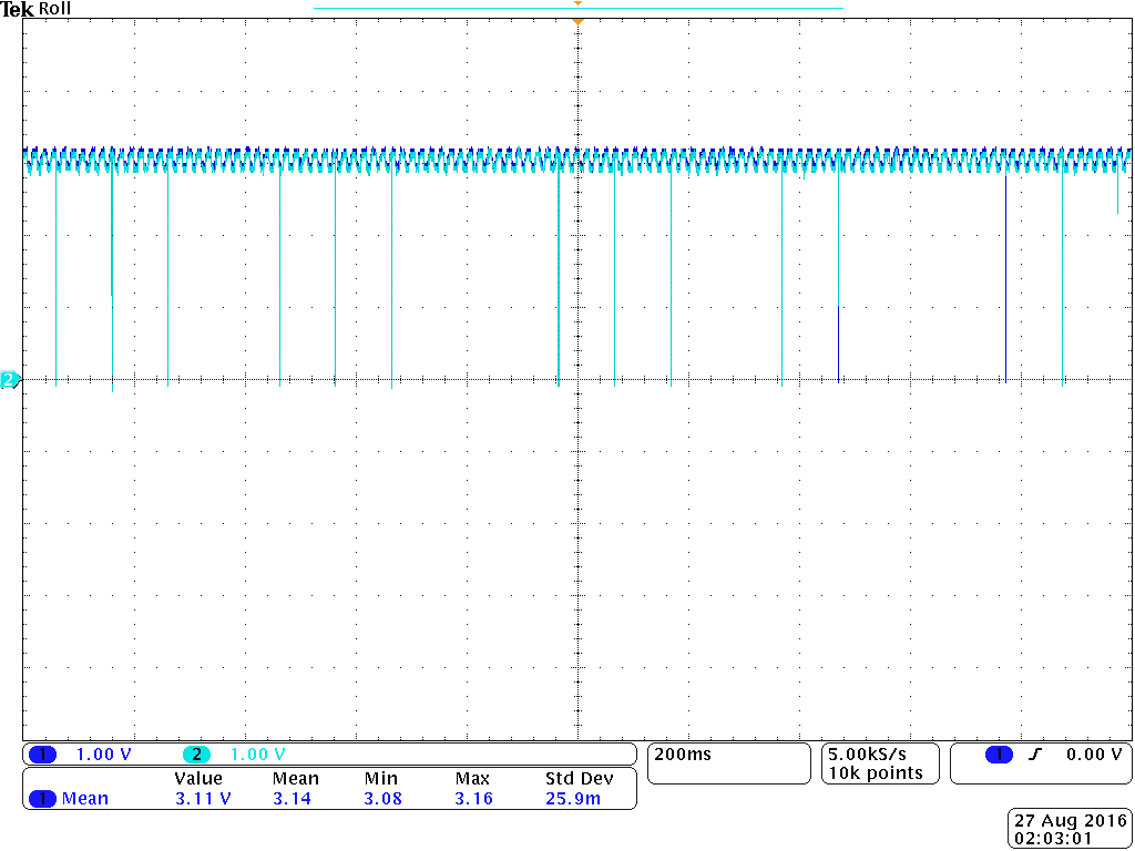

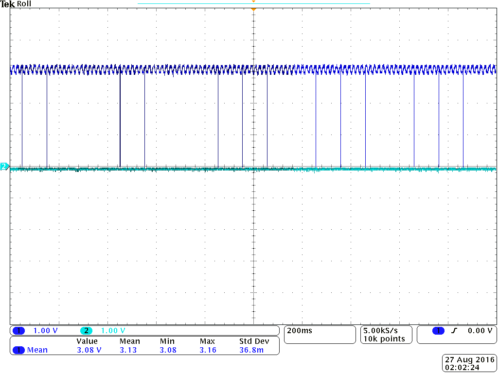

I'm trying to communicate with the chip FT5306, which is a Capacitive Touch Panel Controller. It already came pre-assembled on a controller board, and I used a 6-pin ribbon cable to connect the launchpad to that controller board witt the FT5306 on it. The 6 pins are: 1) VDD; 2) GND; 3) SCL; 4) SDA; 5) INT; 6) RESET. When I press down on the touch panel, the INT signal goes LOW, showing detection, so I know that that part is connected properly. However, when I try to send and read data to the touch panel, it doesn't seems to be doing anything. Thus, I believe that if I can solve my problem with the I2C communication, my other problem should also go away as well.

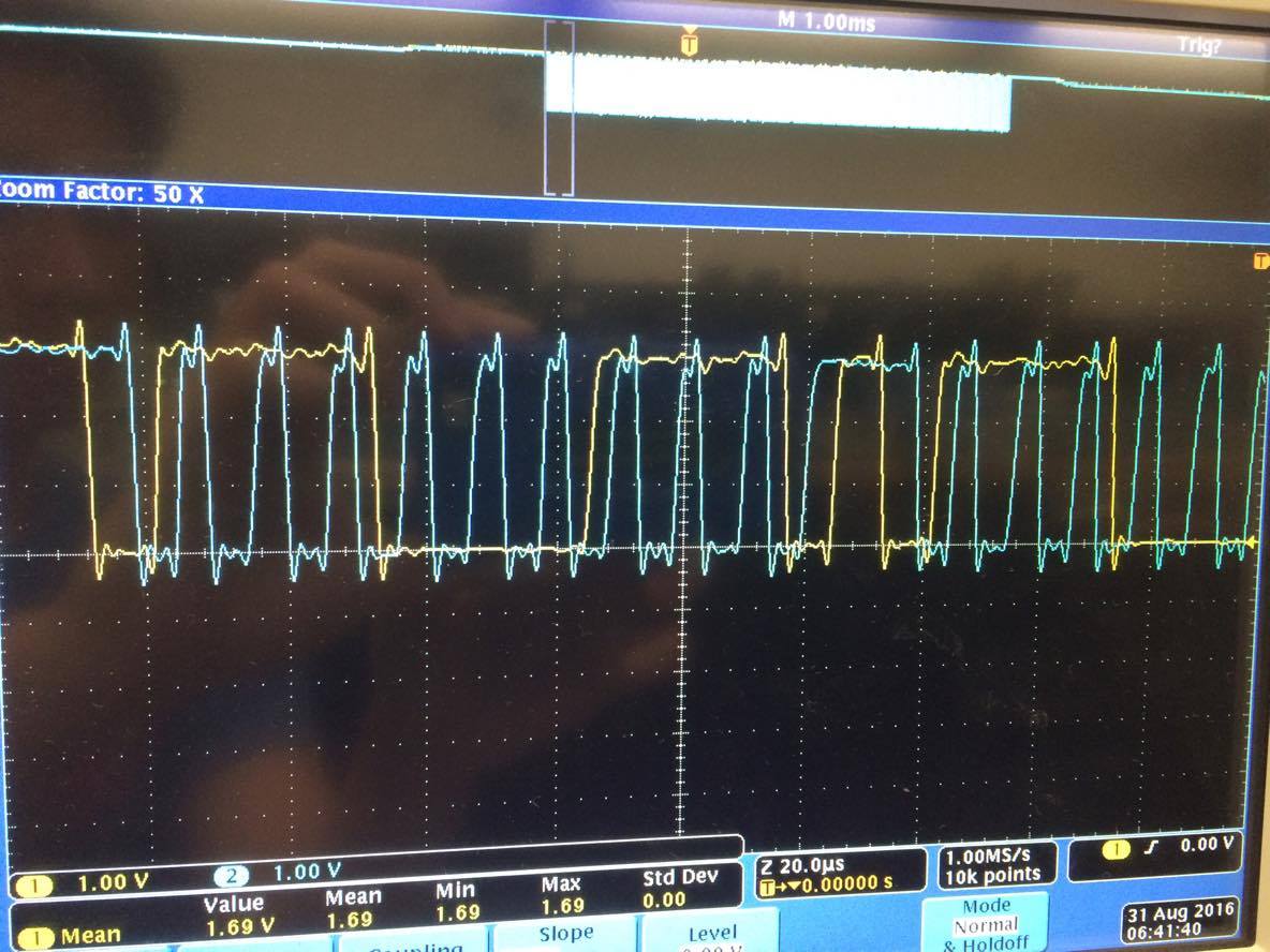

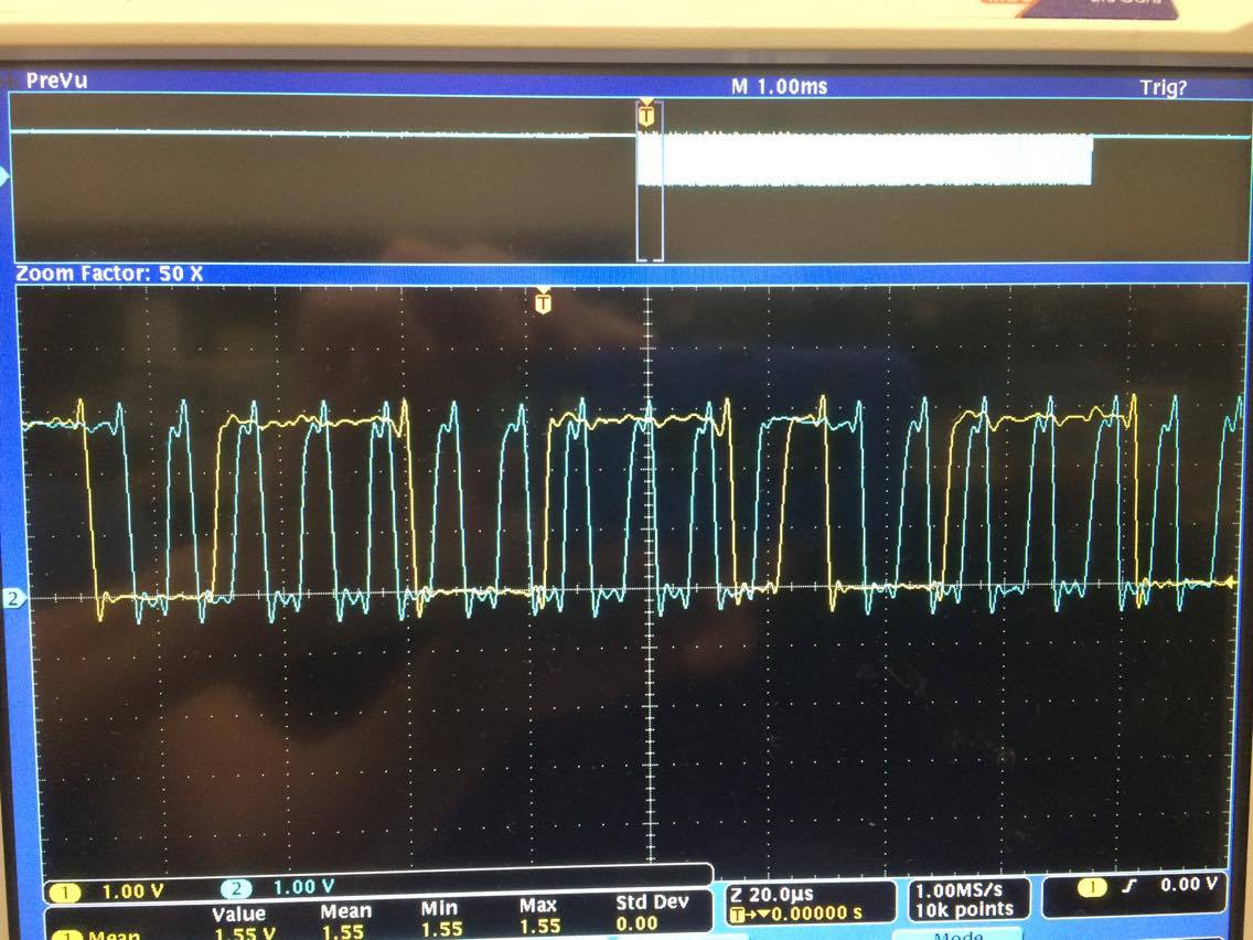

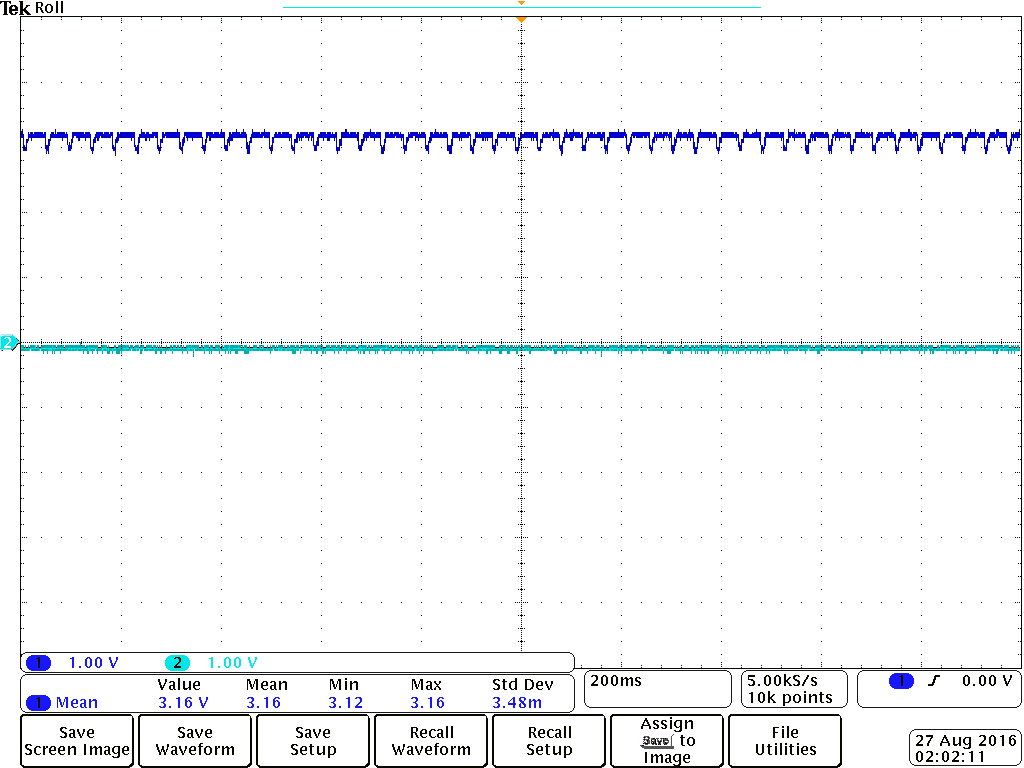

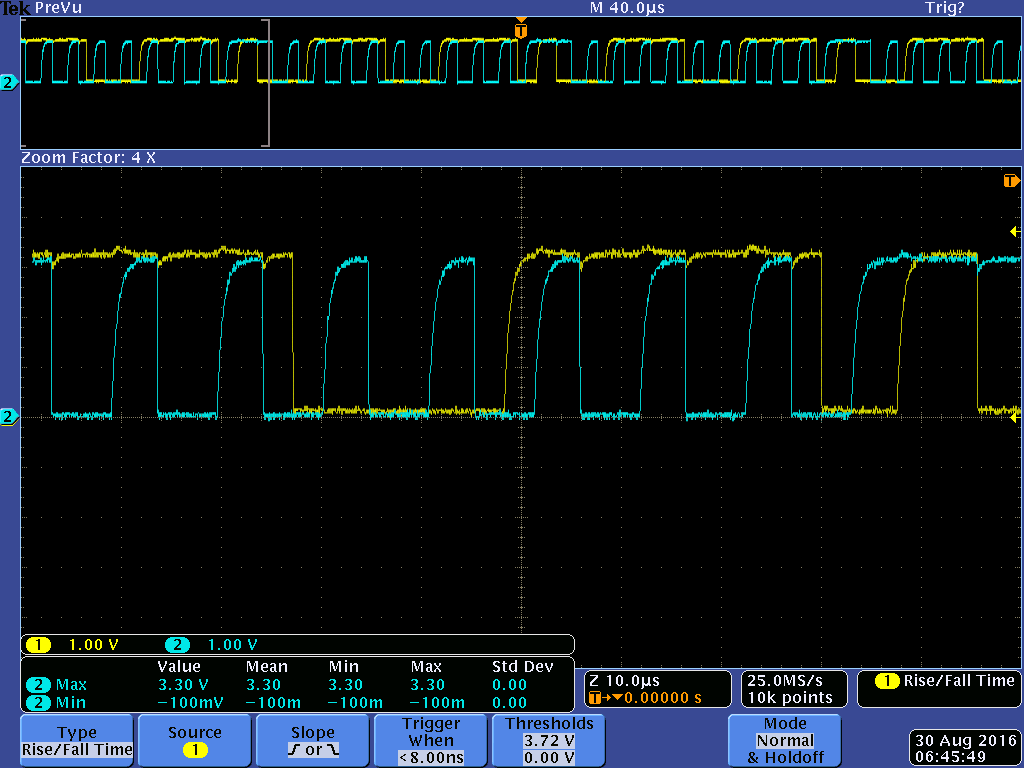

I hooked up an oscilloscope and attached 2 probes, one to the SDA signal and one to the SCL signal. The waveform looks.....wack. It doesn't look like a normal I2C waveform (based on the pictures I've seen online; I'm very new to I2C). Also, I would like to mention that I have a 4.7 kOhm pull-up resistor on both SDA and SCL (not sure if that's an okay resistance). So below are the 4 pics that I took of the oscilloscopes. The dark blue is SDA, while the teal is the SCL. The picture will be in the following order: 1) Probe on SDA, not touching the touch panel; 2) Probe on SDA, touching the panel; 3) Probe on SDA & SCL, no touch; 4) Probe on SDA & SCL, touch.
