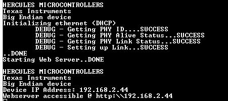

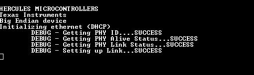

I'm having trouble getting the lwIP demonstration to work on the DRV8301-LS12-KIT. I have tried both version 2 and 3 of lwIP. The supplied source code compiles and loads into the board, and gets as far as "Setting Up Link"....SUCCESS, but no further. I verified my DHCP server is working with same cable and another computer. I then applied the patch to version 3, but it didn't get any farther. BTW - applying the patch to version 3 led to 2 compile errors with the ls12: PHY_LINK_PARTNER_SPD undefined and undefined symbol on Dp83640PartnerSpdGet(). Both easily fixed.
I also tried configuring the version 3 lwip(both patched and unpatched) for static IP, and I get as far as "Webserver accessible @ http:\\192.168.2.44" in both cases, but I cannot connect to the webserver from any of my computers. (I also cannot ping that address, FYI).  I have no problem with same cable pinging between my computers - both of which are configured with static IP's for this test, and all firewalls and anti-virus programs turned off.

  • Hi Anthony - I am doing most of my testing now with static IP instead of messing with DHCP, it seems one less thing to worry about. On the PC, my static IP Is 192.168.2.45. The board has static IP 192.168.2.44. I left default gateway blank on the PC.
    Also, after looking at the VIM setup, I realized my breakpoints may not have been on the right ISR's, so I added breakpoints at EMACCore0RxIsr() and EMACCore0TxIsr() in lwip_main.c, and still not hitting the Rx interrupt, although the yellow Rx/Tx LED flashes when I try to reach 192.168.2.44 with the brower, or if I ping it. I do hit the Tx interrupt one time during or just after initialization.
