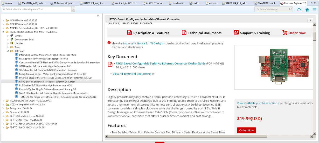

    I note that the revamped Resource Explorer in CCS 6.2.0 now contains links to the TI Designs for the TM4C devices, albeit doesn't currently include the Audio Communication With Power Over Ethernet (PoE) Reference Design which Amit provided a link for. E.g.:
    So, it does look like improvements are being made to provide links to the available information.

    For those without CCS the Resource Explorer is available on the web. E.g. see http://dev.ti.com/tirex/#/?link=TM4C%20ARM%C2%AE%20Cortex%C2%AE-M4F%20MCU%2FTI%20Designs
