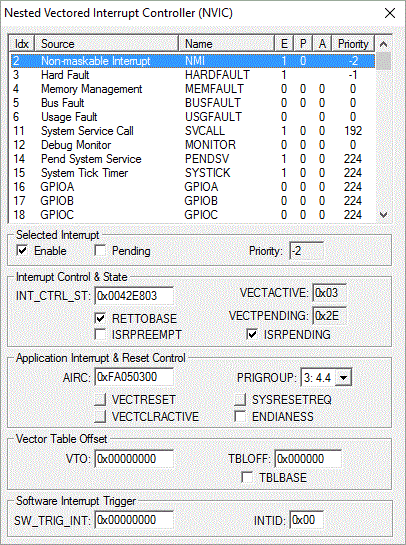

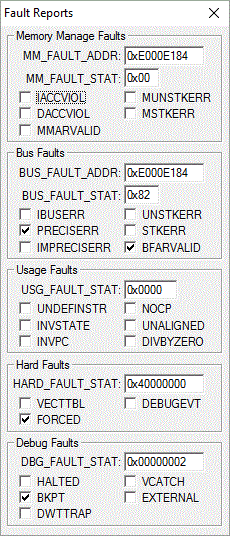

  • Hi Amit,
    Here is the fault register and the NVIC registers.
    Khaled.
  • Hello Khaled
    Since the PRECISE bus fault is triggered and BFARV is also set, check the Bus Fault Address register for the address that has caused the bus fault
  • Hi Amit,
    I'm not sure what you are asking me to do or how to do it. Please elaborate.
    thanks.
    khaled
  • Hello Khaled
    When the Fault Status is set as PRECISE and BFARV is set then the address which caused the Bus Fault is registered in FAULTADDR register
  • Hi Amit,
    The address is 0xE000E184 which point to nothing: no code section nor a data section.
    The problem has to do with the sequence of command that I use to put the EPI registers into a default know values before re-initialize the interface.

  • Hello Khaled,
    My 2 cents on the fact the FAULTADDR register at 0xE000ED38 will have the address of EPI register....
  • Amit
    found it. Its the NVIC register/DIS1 Interrupt32-63 clear enable.
    But it brings nothing new, since I already know that the hardfault is caused by the IntDisable( INT_EPI0) (see code in the previous post of Sept 6th)
    The question, is why? and do I fix it?
    Khaled.
