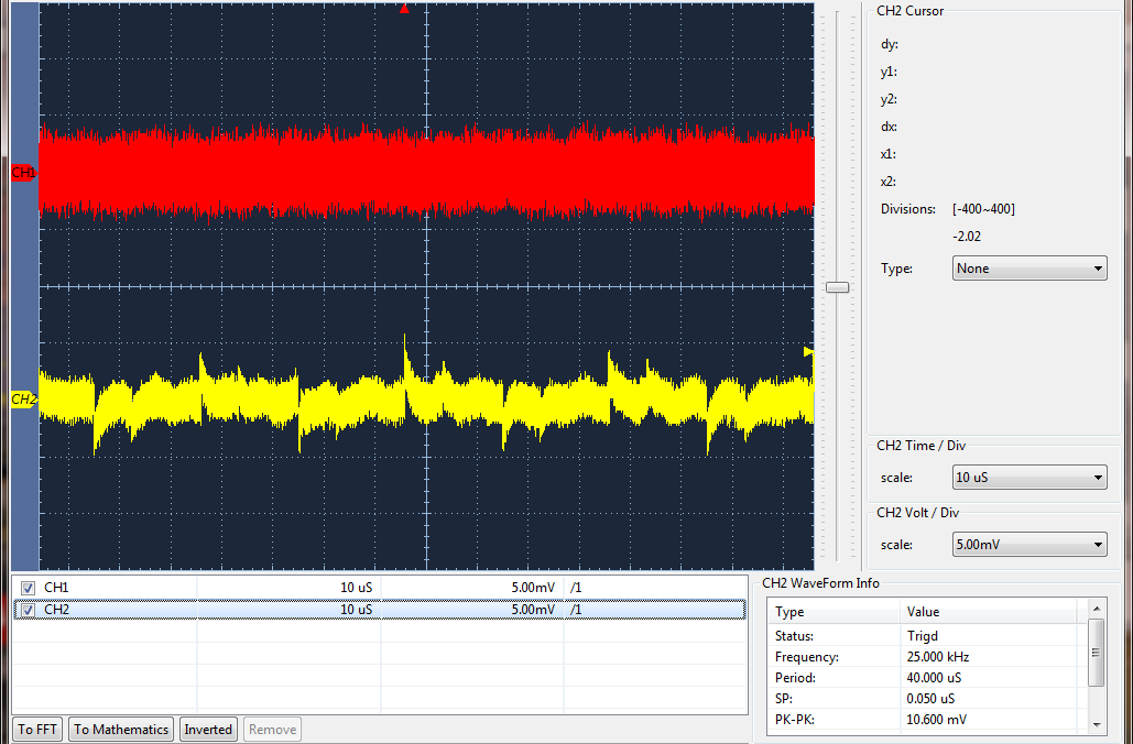

    The DIVSCLK signal X11-Pin93 is only 200mv peak but only in various places in wave form and the frequency is moving all over, 4.5Mhz up to 25Mhz.
    Does that DIVSCLK wave form behavior sound correct?
  • Hello BP101
    No, it does not seem right. Check the scope setting and time base. I am using it to generate 8MHz to 24Mhz clocks without issues.

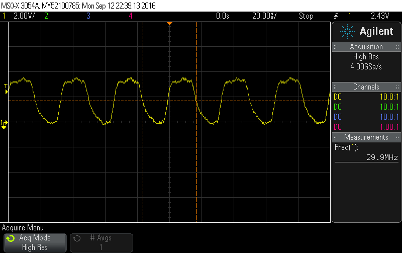

  • Hi Amit,
    The scope is 30Mhz 10K samples depth 50mv/cm^2, channel set for x10 probe yet the frequency is not stable. Was expecting DIVSCLK amplitude close to TTL level being driven by GPIO port set 2ma drive strength. Seems there is something wrong in the DIVCLK configuration?
  • Hello BP101
    And AC or DC bias. Did you try other settings for the Divided clock?
  • Hi Amit,
    Good points - adding WPU or set the divisor 4 makes no difference to output frequency or amplitude remain the same.

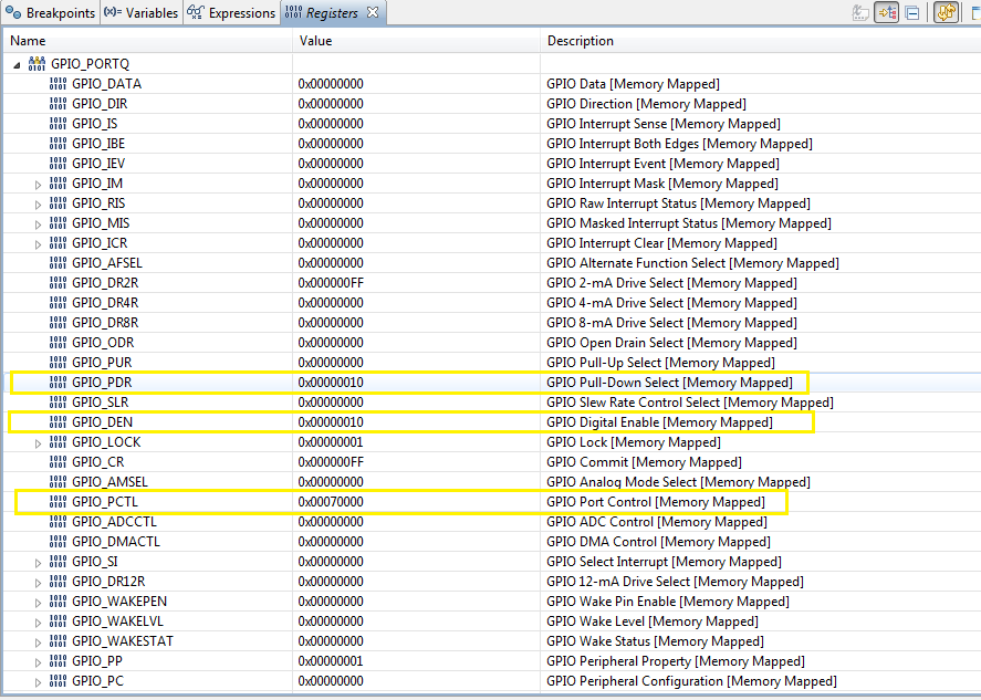

    Must be the GPIO MUX digital 7 (DIVSCLK) PQ4 is not actually being configured? The port configurations are right in the middle of other ports proven as being configured. There are only 2 digital selections 1 & 7 on PQ4 and digital 1=U1RX.
  • Hello BP101
    Debug.... Check the PCTL, AFSEL, DEN and ODR values.

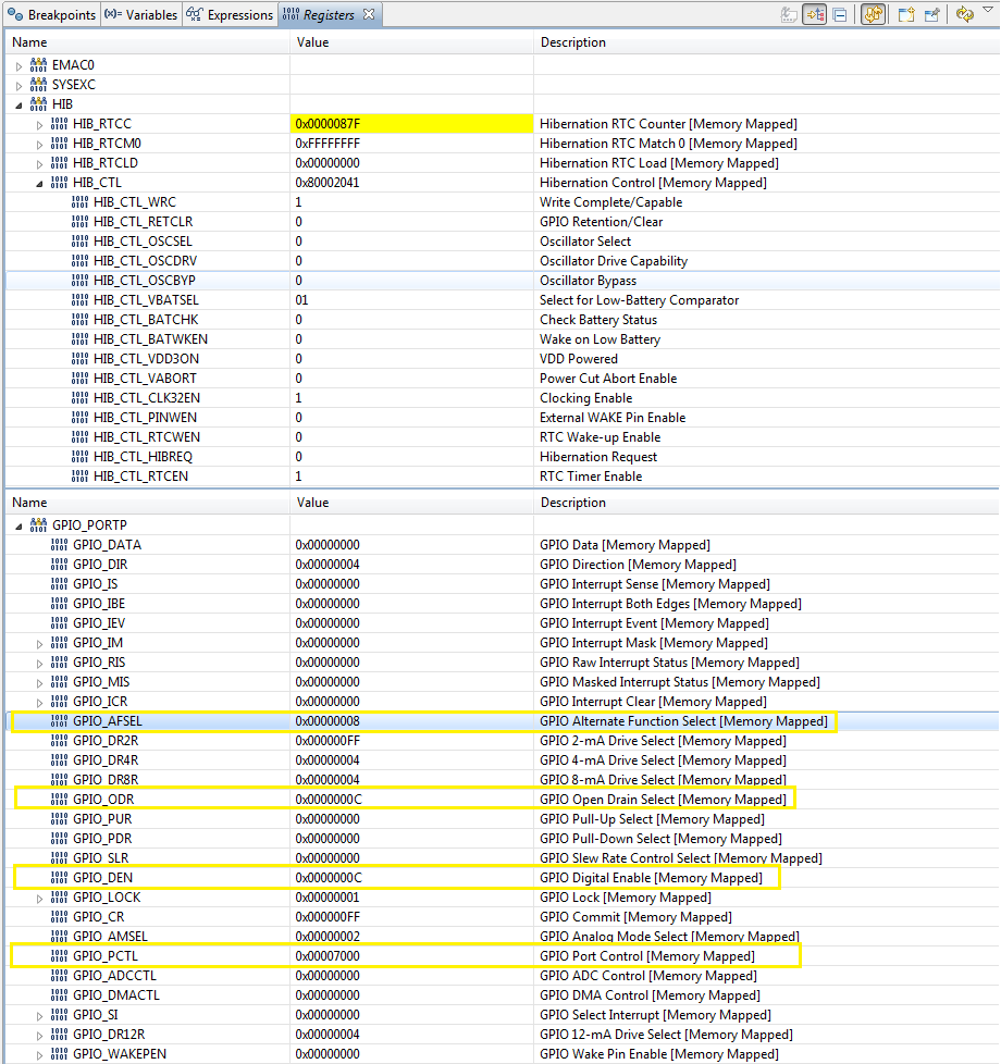

    Is that PCTL/PMC3=0x00007000 decode correct bit pattern for RTC on PP3?

  • Hello BP101
    GPIOODR for the corresponding pin must be 0 and not 1 as per the snapshot image of the GPIO Port P Pin-3
  • Hi Amit,
    RTCCLK is on pin (PP3/0x8) and pin DIR you see is another configured GPIO pin (PP2/0x4) but also tested both PP3/PQ4 as OD. Good thing I enabled RTC as it has revealed some more oddness in DIVSCLK and RTCCLK.
    Oddly both external pins DIVSCLK, RTCCLK PCTL decodes = (7). Dividing 25Mhz MOS DIVSCLK % 4 = 25kHZ ?? on PQ4 after configuring 32Khz RTCCLK.
    CH1= PP3 RTC frequency ?? and CH2=PQ4 DIVSCLK%4=25Khz ....  Something possibly not correct in the PCTL decodes??
    Debug GPIO of PQ4 :

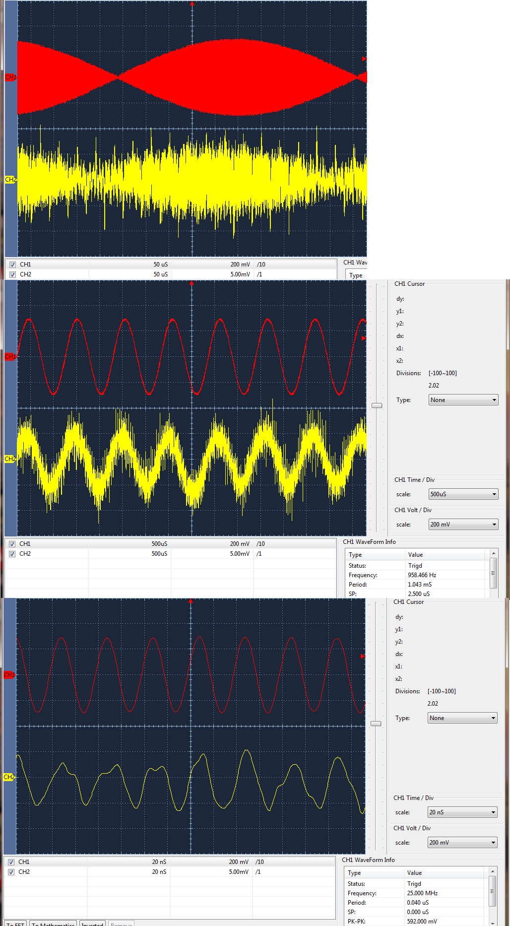

    It seems DIVSCLK may be configured properly after all but still not working. Oddly Y3 - 32kHz HIB clock appears stable yet may be injecting 830-870Hz harmonics into MOSC some where along the clock tree chain.  These two LP are recent purchased EK-TM4C1294NCPDTi3-XL few months ago.
    Have discovered MOSC has 958Hz harmonics (top/center) captures show sine wave riding Y1 25Mhz frequency (CH1).
    Oddly when X10 scope probe (CH1) is place one side of C44 the 25Mhz MOSC output to DIVSCLK (CH2) frequency occurs yet is distorted with harmonic noise, (bottom) capture. The scope then captures 25Mhz but the MOSC frequency is very unstable. Hard to imagine 480Mhz PLL being any where close to stable in this scenario let alone PLL actually locking if this harmonic 2nd fundamental frequency is present.

    Seems you have missed the point that  Y1 is not oscillating correctly and seemingly has 830-870hz harmonics.  Holding scope probe on C44 makes the DIVSCLK then produce a 25Mhz MOSC yet still produces those unstable harmonics. Otherwise DIVSCLK is a highly chaotic signal wave form removing the scope probe from C24 C44.
    According to LP schematic C44/45 should be 12pf. Question is might the MOSC clock configuration have some issue causing the Y1 behave badly?
    Current clock configuration: With or without 1st line HWREG, the same harmonic is present.

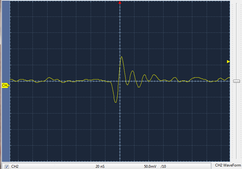

    Attached is a simplified project which configures the DIVSCLK and the associated snapshot of the clock capture on a scope.
    tm4c1294_divsclk.zip
    The clock is not a perfect square or sine, with some reflections evident (but nothing in the Hz range). Since, there is not much I can do other than provide any reference data, I can consider the post closed with proof of code and observations.
  • Hi Amit,
    The first MOSC capture provided above certainly does not represent a properly running oscillator when being chopped by low frequency.
