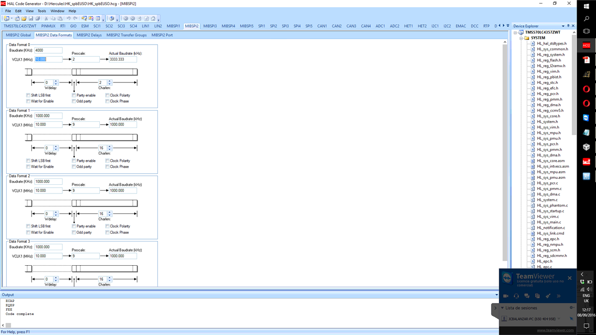

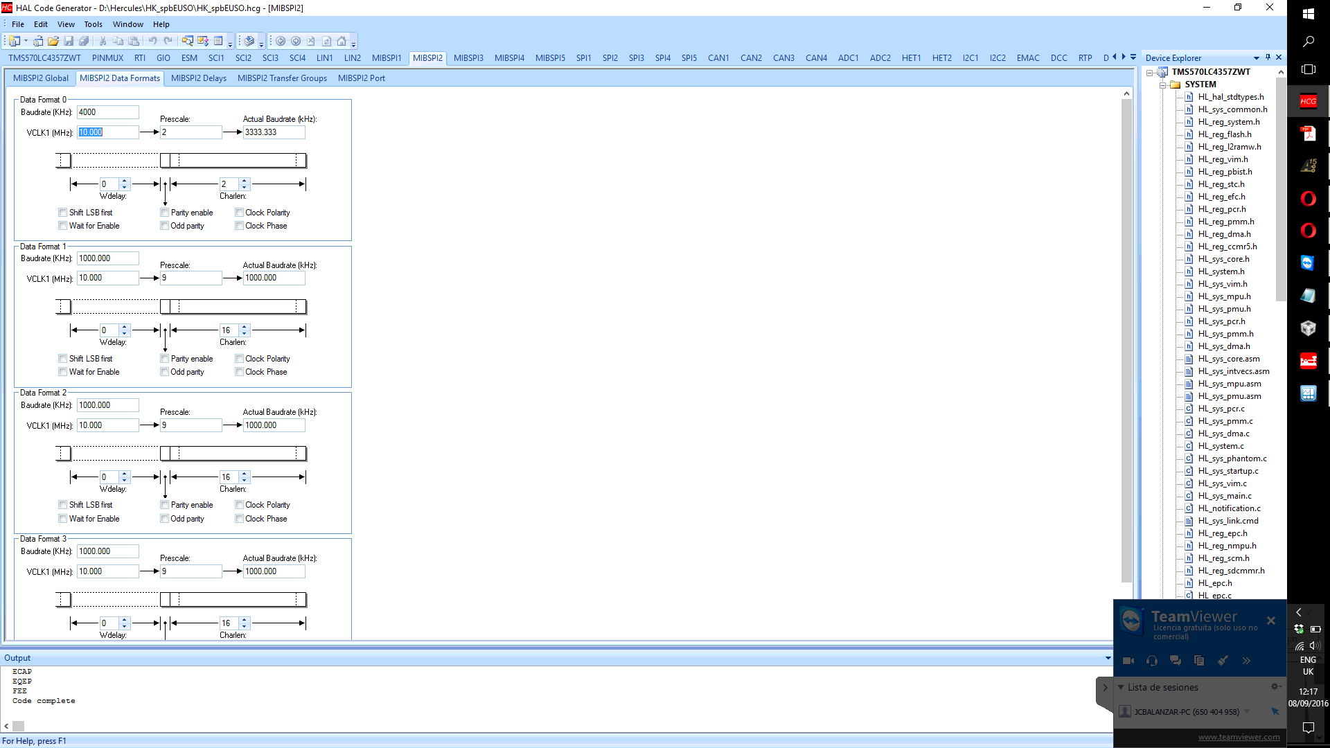

Dear all,
I'm trying to change de baudrate in the HALCoGEN 4.05.02, but I can't configurate a baudrate that the final result will be 4MHz, Could you help me about this problem o exists a documentation with a equation to establish the correct values? I write differents values in the box of baudrate but I only obtain 3.3MHZ or 5MHz
Thank you
Juan Carlos
  • Juan Carlos,
    You have VCLK1 frequency set to 10MHz which is lower than normal for this part. (normally 100Mhz).
    If you have 10Mhz and /2 this gives 5MHz. If you /3 this gives 3.33MHz.
    If you want 4MHz you need to increase VCLK1 to something that is an integer mulitple of 4MHz.
    The divider only supports integer divider values.
