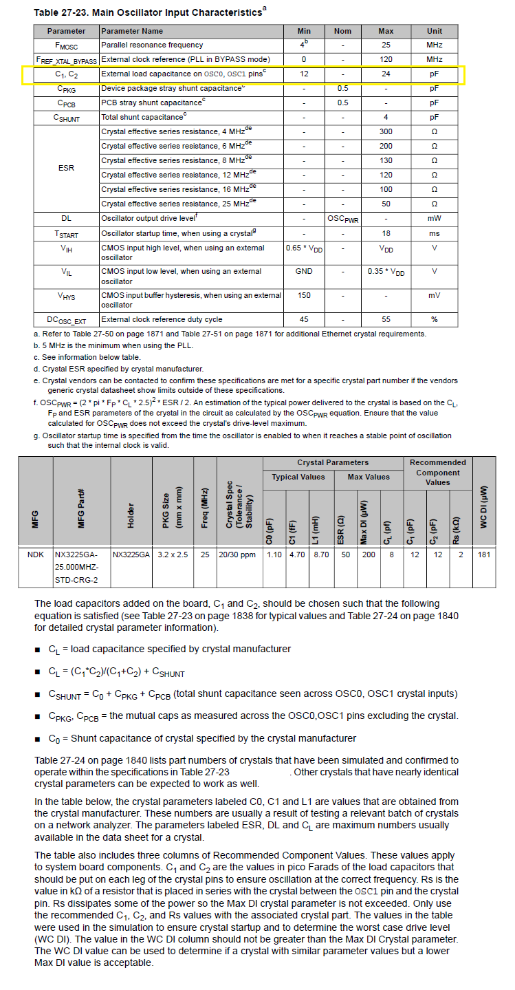

  • Data sheet NDK crystal has a 9-50Mhz fundamental fixed (primary) frequency order by value.  Must insure desired fundamental remains the primary frequency with little to no secondary harmonics in the final wave form. Seems the trim pull down capacitors might dictate crystals harmonic behavior.
    /cfs-file/__key/communityserver-discussions-components-files/908/Crystal-NDK_2D00_NX3225GA_2D00_STD_2D00_CRG_2D00_2.pdf
  • Seems odd but 24pf is having an GOOD impact on the EMAC being more stable though suggest 18-20pf not the maximum 24pf. The top & center scope captures (2nd posted) are not showing the correct measured signal frequency. However the 1st capture 892Hz (1st post) is showing the results of the suspected secondary harmonic and again the bottom capture showing near 25Mhz DIVSCLK is only present when scope probe is placed on C44.
    Rs is the next part of the equation that could impact RTCCLK (HIB driven) and DIVSCLK (MOSC driven) may reduce frequency magnitude necessary to drive the clock tree gate block input stages.  That seems to infer the RTTCLK/MOSC gate blocks are being under driven by each crystal????
    Is it possible scope probe is some how enabling single ended crystal bypass, NOXTAL (1) register RST=1 cleared 0 and scope probe injects gate bias??
    Clearing both by a single register write as data sheet suggested (MOSCPWR/NOXTAL=0) left a new launch pad inoperative. Yet in Run mode CCS debug shows NOXTAL=0.
  • > CL = (C1*C2)/(C1+C2) + CSHUNT:
    Seems someone might have made a mistake calculating MOSC total CL:
    CL formula divides (C44, C45) total CL (product/sum) is half or 6pf + shunt 4pf we get 10pf =CL. And when CL= 10pf (C44,C45) crystal load capacitance, DL and Rs factors would also be miscalculated. When crystal load caps are each  24pf (C44,C45) the actual CL=16pf including 4pf shunt before any PCB capacitance is added.
    (24pf *24pf / 24pf +24pf) or  576/48=12pf + 4pf shunt = CL 16pf

  • Again this post regards the values of C44,C45 made 12pf on launch pad and table 27-3 shows 24pf 25Mhz maximum MOSC. Who knows how accurate the XTAL tolerance is %PPS at the fundamental and likely the formula has some tweaking factor.
    Helpers who only point out error versus suggesting any possible value changes SW or HW are not helping so much here. Must fully rectify failure of DIVSCLK, RTCCLK may help correct NVIC divergence in MOSC/SYSCLK driven GPTM interrupt handlers with triggered 1 shot timers constrained to certain clock domains.
    That NVIC or global interrupt controller has noticeable slow down in 1 second interval timer interrupts diverging from edge counts timer interrupts. Now the counts in the edges per second are far less diverged in the same second 1 shot GPTM driven by PIOSC versus MOSC. SYSCLK GPTM for Edge count interrupts speed 423 edges/second (102Hz) produce 1 interrupt for every 423 edges, fan produces 2 pulses every revolution up to (213Hz) or 6300RPM. No extreme edge timing pushing NVIC to the brink of priority overdrives @1 second one shot GPTM. Yet it does most badly if one shot 1 second GPTM clock source is SYSCLK versus PIOS that constrain total edge counts to maximum of 6800 RPM. Otherwise the input edge speed ends up reporting 30KRPM or higher for MOSC clock source feeding same 1 shot timer for the very same 1 second interval calculation. Something in the clock domains is going Koo Koo and effecting NVIC.
    The divergence of GPTM edge counts/sec do not occur until other GPTM timers, PWM generators and ADC interrupts are tasking NVIC in higher priority interrupts.
