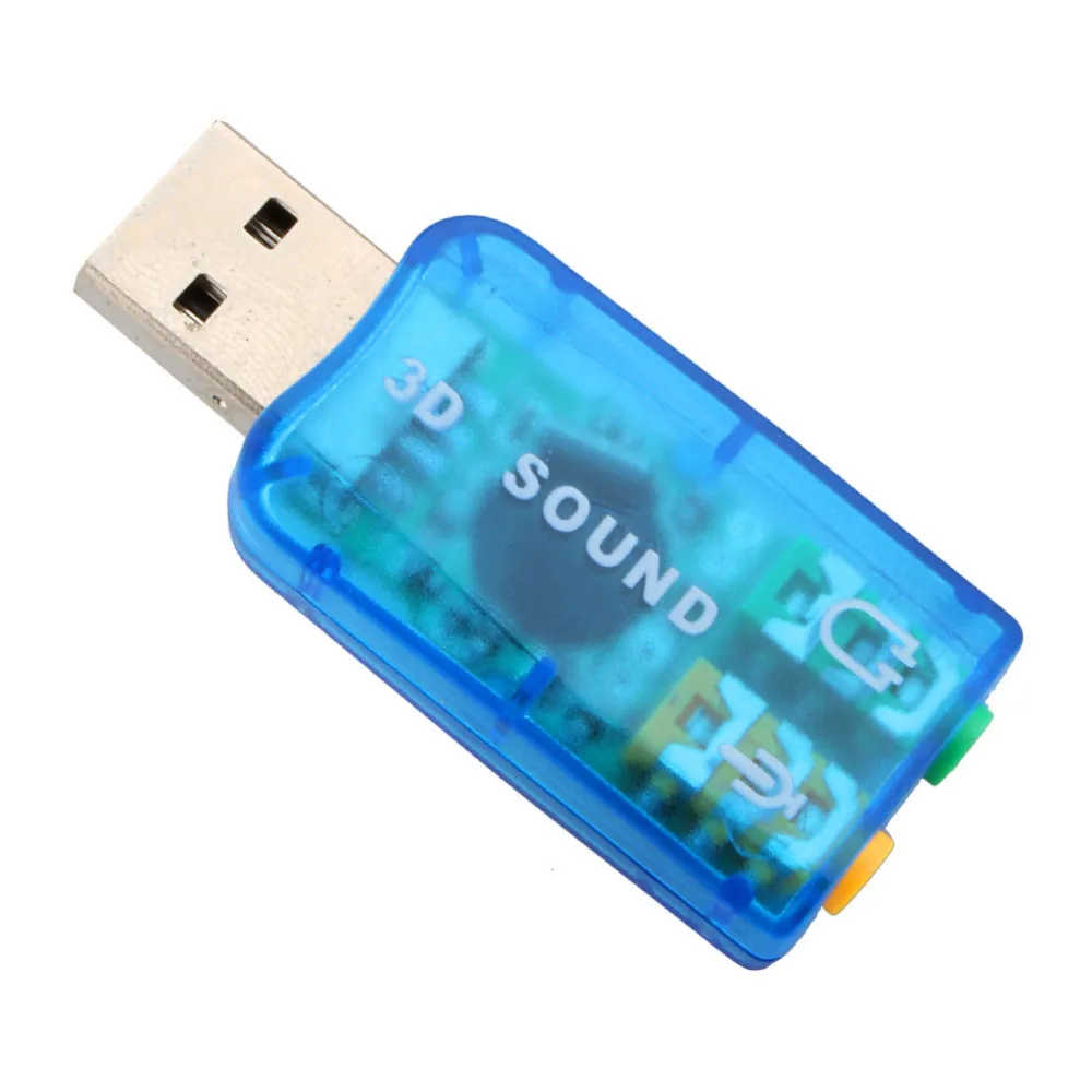

Is it possible to connect TM4C129 with CC3200 Audio BoosterPack ?
or connect TM4C129 with USB sound card via USB OTG cable ?
I want to record voice then use TM4C129 send the sound data to web sever by HTTP Post

  • Hello Khoa
    No, it is not possible to connect the CC3200 Audio Booster Pack as it requires I2S connection which is not supported. We have a TI design for audio via ADC and Timer
    www.ti.com/.../TIDM-TM4C129POEAUDIO
    It is however possible to use USB sound card. Examples for the same are available in TivaWare software.

    2/ And the Example you mentioned is in SW-TM4C-USBL or  SW-TM4C-USB-WIN ?
    I found usb_host_audio_in  in C:\ti\TivaWare_C_Series-2.1.2.111\examples\boards\dk-tm4c129x .  Can I use this example with ek-tm4c1294xl board
    thank you and regards,
    Khoa
  • Hello Khoa
    Yes, you can download SW-TM4C and it will take care of all the other packages.
    The path of example I mentioned, you have already found. It is not directly workable on ek-tm4c1294xl as the dk-tm4c129x example uses the Touch LCD screen and SD Card of the DK-TM4C129x. However the basic USB code should work if your remove the LCD code and are able to connect a SD Card to the EK-TM4C1294XL.
