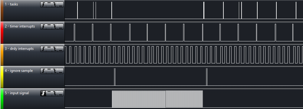

    The only issue remaining is that all my RTOS tasks cease functioning while DMA Channel 14 is enabled. Here is what I observe on my logic analyzer (GPIO's being toggled upon entry and exit of any task, timer ISR function, and GPIO ISR function, as well as an indication of the start and end of bursts i detect on the input)
    Here is the code relevant for the burst detection:
    void initMainLaserSuppression() {
    	if(0==GPIO_read(MLS_BOARD_GPIO)){
    		//pin is actively pulled down
    		initMLSFallingEdgeDetection();
    		GPIO_enableInt(MLS_BOARD_GPIO,GPIO_INT_RISING);
    void ISR_GPIOPortE(){
    	GPIOIntClear(MLS_GPIO_PORT,MLS_GPIO_INT_FLAG);
    	g_mlsDirtyFlag=1;
            Timer_start(g_mlsTimer);
    	GPIODMATriggerEnable(MLS_GPIO_PORT, MLS_GPIO_PIN);
    	uDMAChannelEnable(UDMA_CH14_GPIOE & 0xffff);
    void ISR_Timer5(){
    	g_mlsDirtyFlag=1;
    	uDMAChannelDisable(UDMA_CH14_GPIOE & 0xffff);
    	GPIODMATriggerDisable(MLS_GPIO_PORT,MLS_GPIO_PIN);
    The tasks don't get executet as long as DMA channel 14 is enabled, not depending on the DMA actually getting triggered by the GPIO peripheral or not. If I don't disable the DMA channel in ISR_TIMER5 , the tasks never get executed again.
    Do you know by what this could be caused? Can you point me in any direction where to continue debugging this issue? Any help is greatly appreciated!

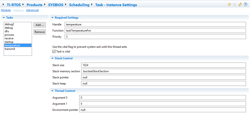

    The issue I have is that any tasks configured in the context of the TI-RTOS or more specifically in the SYS/BIOS cease to be executed while the DMA is running. I fail to see the connection between the DMA and these tasks getting triggered for execution. I also can not imagine that these tasks get starved during that time, since I don't change the processing load at all.
    Here is the example code of such a task:
     * @brief task used to read the temperature.
     * collectTemperature() is doing the reading/processing.
     * @param arg0 argument 0
     * @param arg1 argument 1
    Void taskTemperatureFxn(UArg arg0, UArg arg1)
        while(runtime)
    	RegisterGPIOToToogle(START, TOOGLE_ALL_TASKS);
            collectTemperature();
            UpdateHeater();
            RegisterGPIOToToogle(STOP, TOOGLE_TEMPERATURE);
        	Task_sleep(100);
    Configured as follows:

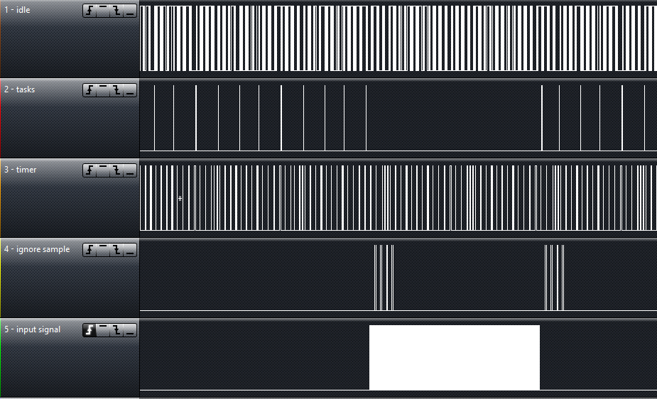

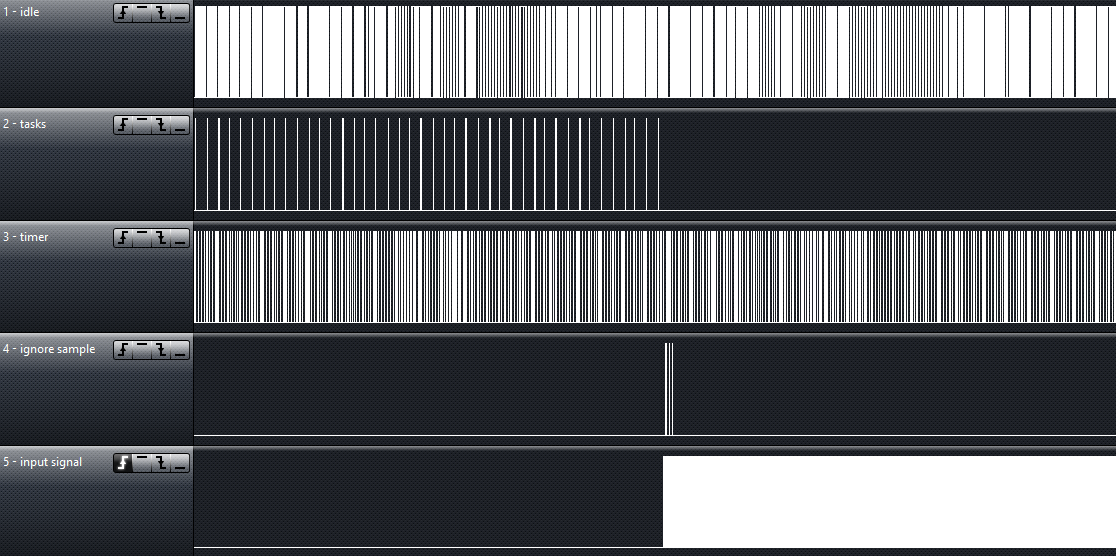

  • One more thing:
    For debugging purposes, I registered an idle function to be executed when all tasks are blocked:
    Idle.idleFxns[0] = "&_c_idle00";
    Task.allBlockedFunc = Idle.run
    The Idle function does get executed while the DMA channel is enabled:
    It therefore seems that the DMA channel being active is somehow inhibiting the tasks from getting unblocked. I have however no clue how these two could be connected.
  • Hello Roman
    Do you mean the GPIO toggle for the signal marked "tasks" and "ignore sample" do not happen, when the "input signal" starts toggling?
  • Hi Amit
    Only Tasks don't get executed (visible on the LA by the missing toggling of the GPIO on the "tasks" signal). The "Ignore Sample" toggles just indicate that I correctly identified the start and end of the toggling burst on "input signals" (this gpio toggling is caused by an execution of ISR_Timer5 or ISR_GPIOPortE)
    Roman
  • Hello Roman,
    And what is the rate of the GPIO toggle?
  • "input signal" toggles in that screenshot with 25kHz. In the final application it can be anything between 20kHz and ~500kHz (edit: preferably it will work up to 2Mhz).
  • Hello Roman
    That is a very nominal rate for UDMA. The only thing that can be happening is somehow the DMA interrupt handler is getting triggered via the peripheral causing it to go the interrupt handler all the time till the DMA channel is not disabled.
    The triggering peripheral has an interrupt mask for the DMA done interrupt. If the condition is not being cleared then the CPU may just be entering and exiting the interrupt handler.

    In the meantime I have spent some more time debugging and tried forcing RTOS to use Timer3 instead of Timer2 for its task scheduling by occuping Timer2 with a dummy.
    The result is positive in the way that it gives me a workaround for the time being:
    As you can see, the tasks keep getting executed even while the dma channel 14 is active.
    My only explanation for this behaviour is that just because Timer 2 could be configured to trigger DMA Channel 14 transfers, its interrupts are blocked from reaching the NVIC whenever DMA channel 14 is enabled (with GPIOE assigned to it).
    Is this conclusion correct? And is that supposed to be this way?
    Roman
  • Hello Roman
    Yes, that would be correct interpretation.
