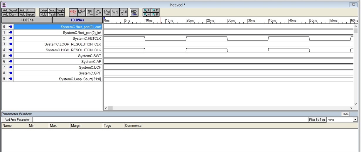

I was going through the sample program for HET IDE. I am not able to get desired o/p at pin HET[0]. Can you help me out? Here's my waveform

Thank you in advance.

Suyog,
In your screenshot you only ran for less than 100ns.. Try running longer. I don't think the PWM is that fast that you would see it toggling in 100ns. Try running for milliseconds.
