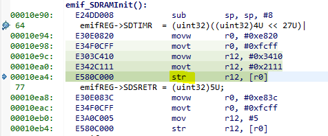

Hi TI team,
I'm currently using a HDK board modified with a socket to test multiple TMS570LC43 chips.
I have a simple program used to R/W some data in the embedded SDRAM via the EMIF.
But, on some chips, the software does not pass trough the emif_SDRAMInit() function.
to be more precise, the code goes in DataEntry error when accessing  the first register emifREG->SDTIMR. (see ASM attached)
I did some tests, and it seems that all the "Registers/Memories under PCR2 (Peripheral Segment 2)" are not accessible and cause the abort.
On other chips, the code goes well and the emif is initialized.

  • There are some TMS570LC4357 parts that were incorrectly configured. Can you provide me an image of the memory window showing address 0xF0080140 through 0xF008019F?
  • Hi Bob,
    thanks for the quick answer.
    here the memory image from a non-working chip :
    • 0xF0080140 7FF8FFFF FFFFFFFF FFFFFFFF FFFFFFFF 001001F8 1ADA1AAA
    • 0xF0080158 00108303 01511000 77169302 00063443 7A180024 00140013
    • 0xF0080170 22222A2A 030221A1 02540200 0200F019 012A0020 00FF0014
    • 0xF0080188 07D00010 00000FA0 01BF01EA 008E071B 09040BFF E563A18F
    • 0xF00801A0 FFFFFFFF FFFFFFFF FFFFFFFF FFFFFFFF E51CF6B0 1410012C
    • 0xF00801B8 46EB0C22 290004FF 00120012 0012FFFF 0003FFFF 0014FFFF
    • 0xF00801D0 FFFFFFFF FFFFFFFF FFFFFFFF FFFFFFFF 544D5335 37304C43
  • Yes, that is one of the mis-configured devices that has the EMIF disabled. I have sent you a friend request so that I can e-mail you instructions for returning those devices.
