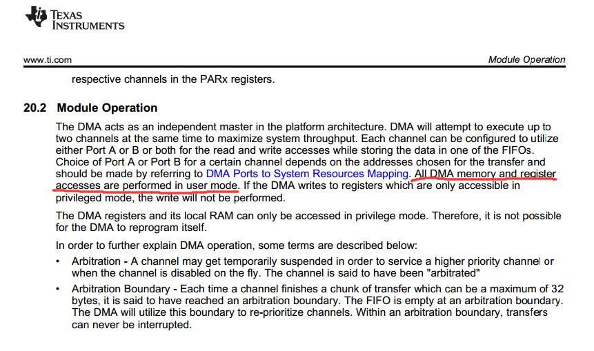

Can anyone confirm that the EMAC DMA component access is in user mode? I can see for RM4x( from the thread below), it is yes, what about for RM5x? Can you show me the evidence in the TRM? I can see that the normal DMA access is in user mode in the TRM.
