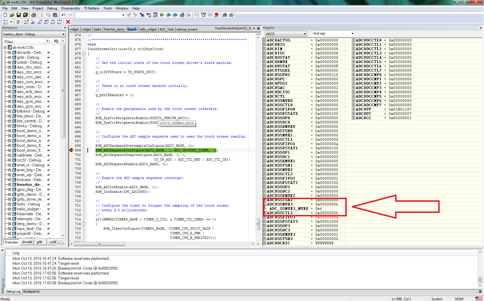

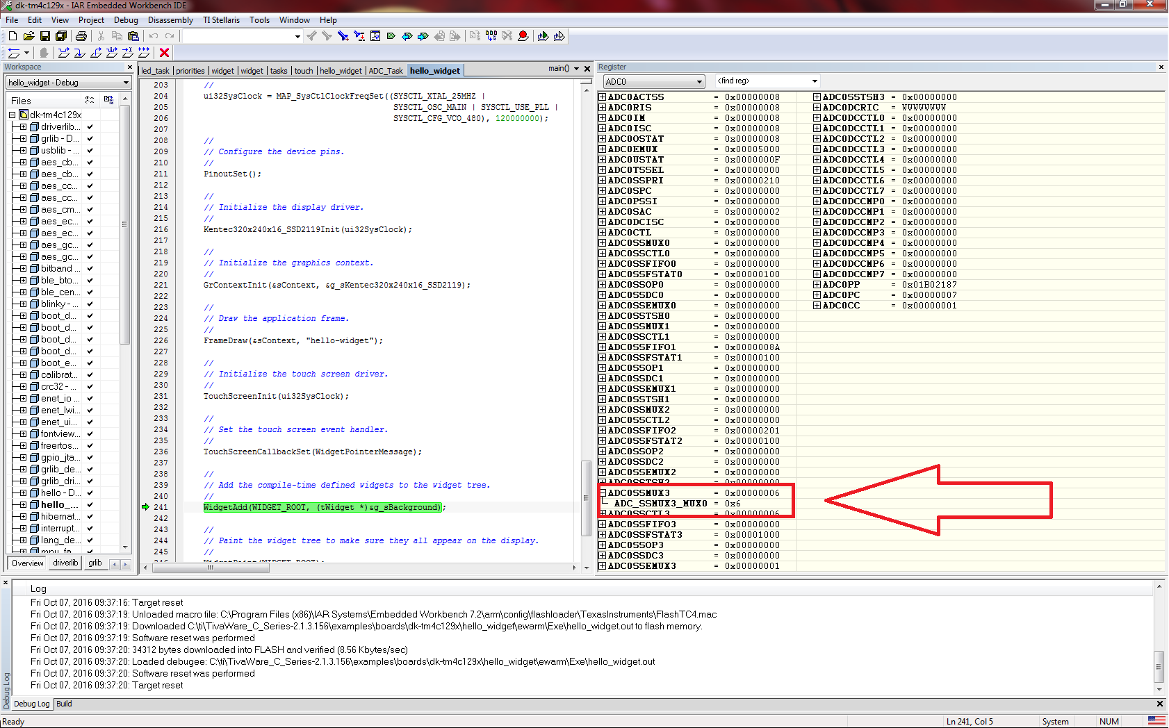

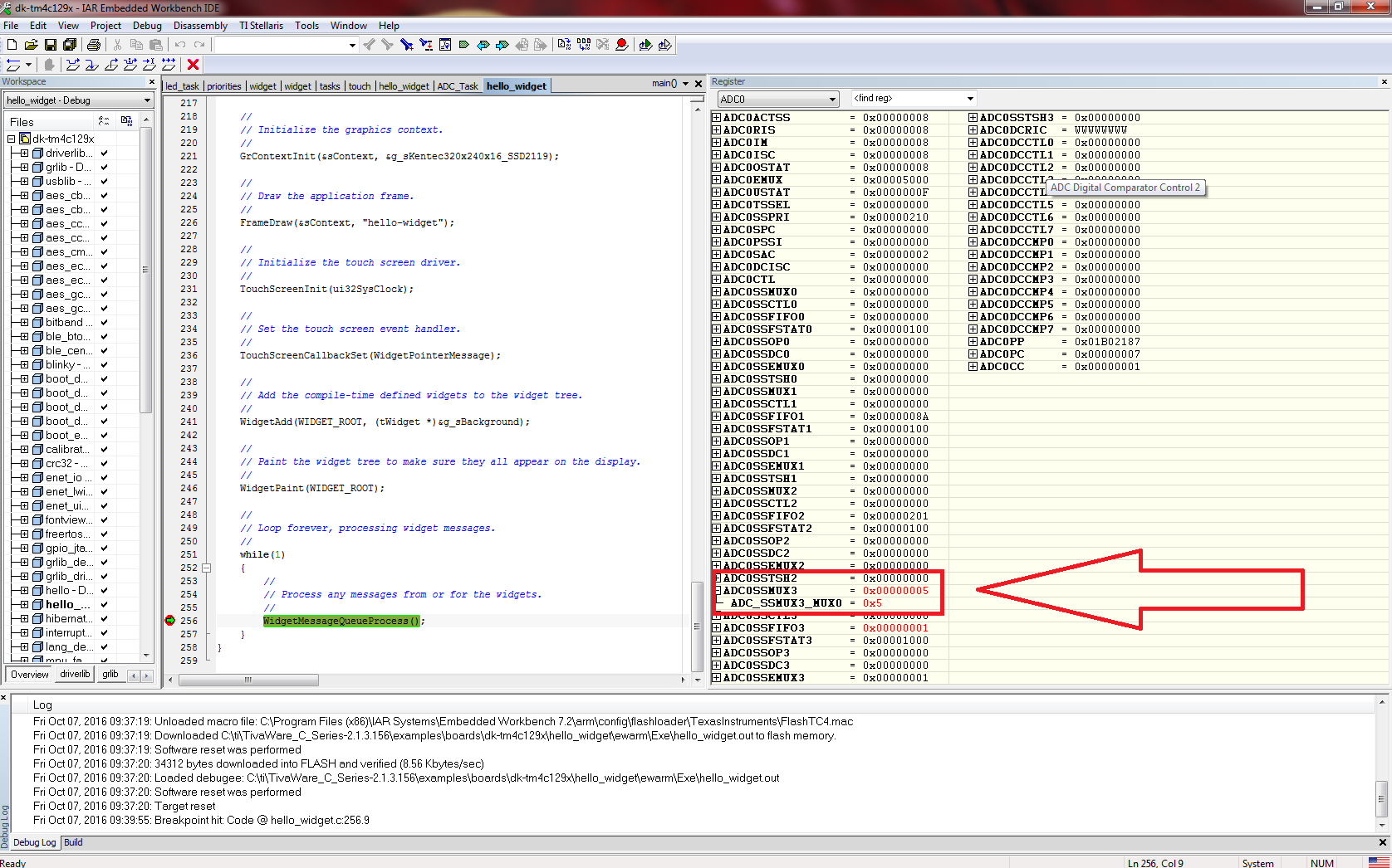

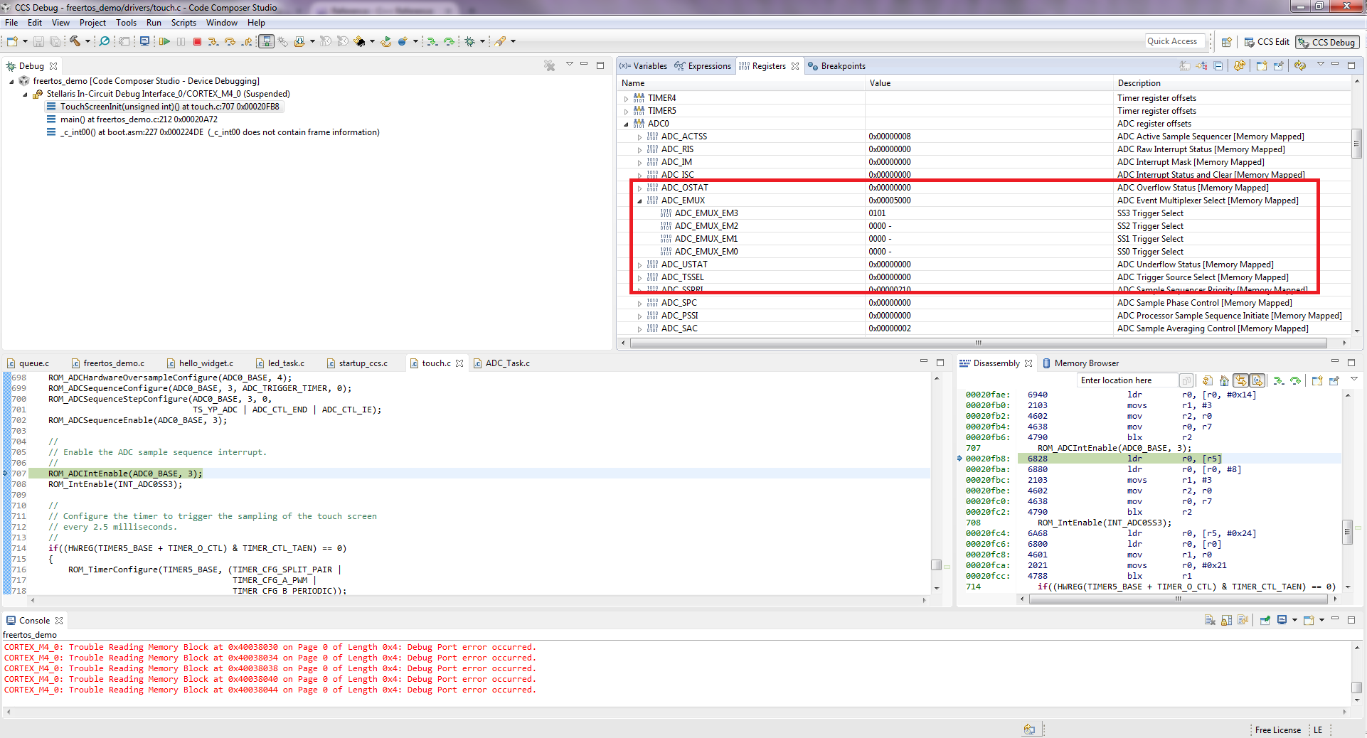

  • Hi Amit
    Do you know what could be doing that?
    I let you some screenshots
    This is after initialize the touch library
    As you can see the register has the value of 0x6
    After some Go/Pause:
    Some times the value is 0x5 and another is 0x6 and this is from the hello_widget example.
    If you can suggest me more ideas it will be great, by the moment I'll keep doing some tests
  • Hello Juan
    Create a HW breakpoint on the register so that when the MCU accesses the register again the program execution halts. That way you will be able to see which code causes the change/update.

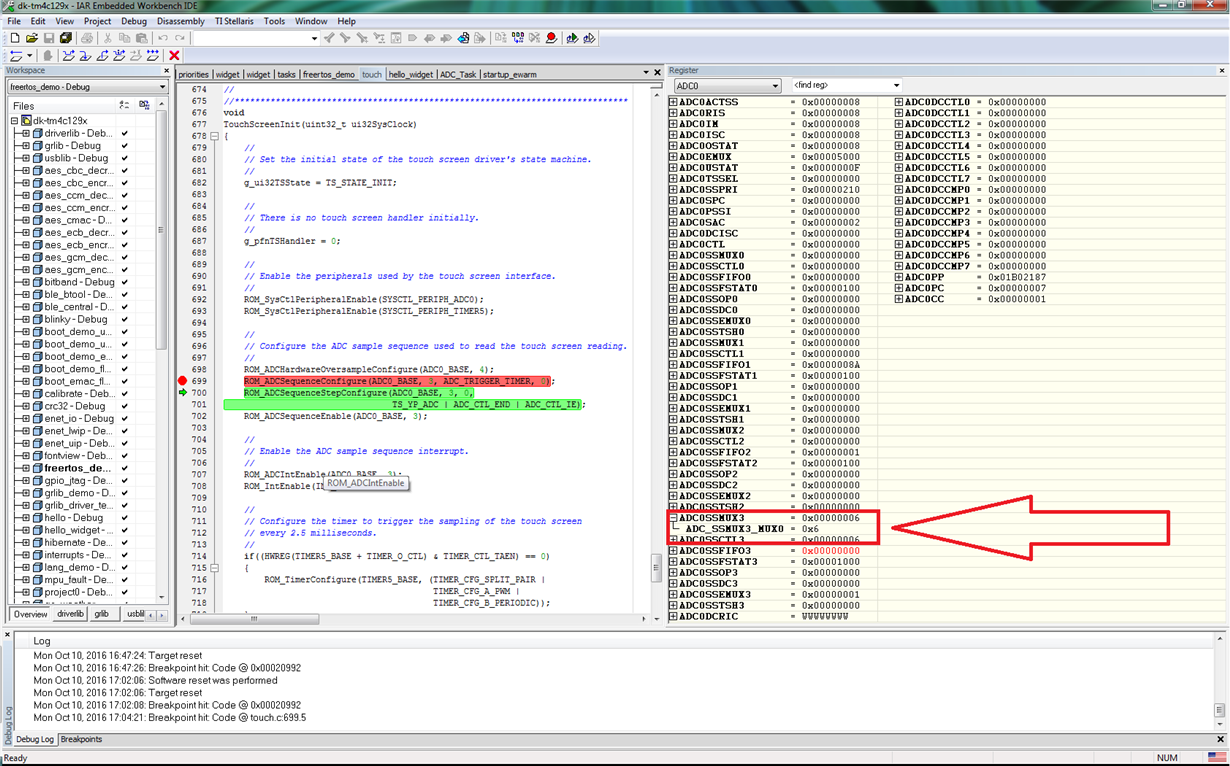

  • Hi Amit
    I'm working on it because I normally work with IAR, give sometime and I let you know what happend.

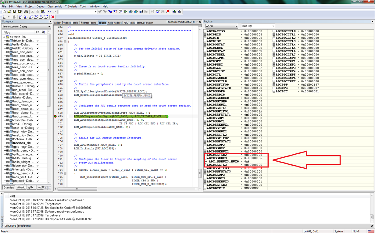

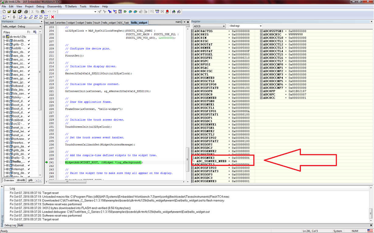

  • Hi Amit
    I can't install CCS but I find how to make a hardware breakpoint on IAR.
    The code just stops in the call to the function ROM_ADCSequenceConfigure(ADC0_BASE, 3, ADC_TRIGGER_TIMER, 0); in the line 699 of touch.c as expected.
  • Hello Juan
    And that time it gets configured as 0x5 (Timer) and later somehow it gets configured as 0x6 (PWM)?
  • Hi Amit
    Yes it keeps doing that, maybe is a mistake on IAR, maybe the hardware breakpoint is not well implemented on IAR, actually sometimes I get some strangers errors, I don't know if the debugger is bad implemented on the IAR (I don't know a lot about the matter), but well thats a complete different subject.
    If I run the code, IAR stops just after the call to function ROM_ADCSequenceConfigure(); and the register has a value of 0x6
    In the next images I put I break point in the call to the function that wrights to the register and after call it, the value of the register doesn't changes at all.
    After call the function you can see that the register doesn't changes
    I don't know if it is an IAR error, I'm gonna try with CCS again, although I don't like it at all.

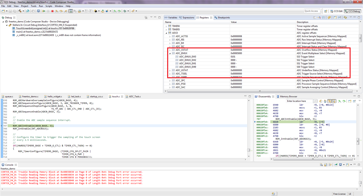

  • Hi Amit
    I put the hardware watchpoint in CCS:
    The program stops at ROM_ADCIntEnable(ADC0_BASE, 3); like you can see in the image, then never stops again.
    Also I pause the program to see the value of the ADCEMUX register and always is 5, even after severals pause/resume always is five, not like IAR that sometimes changes to 6.

    The X value always stay in low values close to zero while the Y value changes from low values to values near to 4000 (I guess that the limit of the 4096 value of the ADC). This happens just with my code, when I run the hello_widget example I can see how both values changes from almost zero to almost 4000, and the values increase when I go down and to the left respectively. In my code just the Y value increase, the X value remains almost zero no matter the position of my finger.
  • Are you asking all here to believe that the Touch hardware & software cannot successfully read the X Axis?    Can that (really) be possible?   And passed all of this time - w/out user notice and squawk?
    It should prove useful for anyone encountering this issue to temporarily "break" the factory/existing connections to the TouchScreen.    Applying 3V3 potential to one axis - while touching the screen - should enable a simple DVM to reveal the voltage upon the 2nd axis.   By changing the location of "touch" that voltage should vary.
    Your final paragraph is most confusing,  you write, "I can see how both values changes from almost zero to almost 4000, and the values increase when I go down and to the left respectively. In my code just the Y value increase, the X value remains almost zero no matter the position of my finger."
    How can you claim: "both values change from almost 0 to 4000" and in the next sentence claim: "the X value remains almost zero?"

  • Hello Juan
    The basic issue is that for some reason in IAR the value is changing from 0x5 to 0x6 for the trigger source for the ADC, which I can't say for sure as to why it changes.
