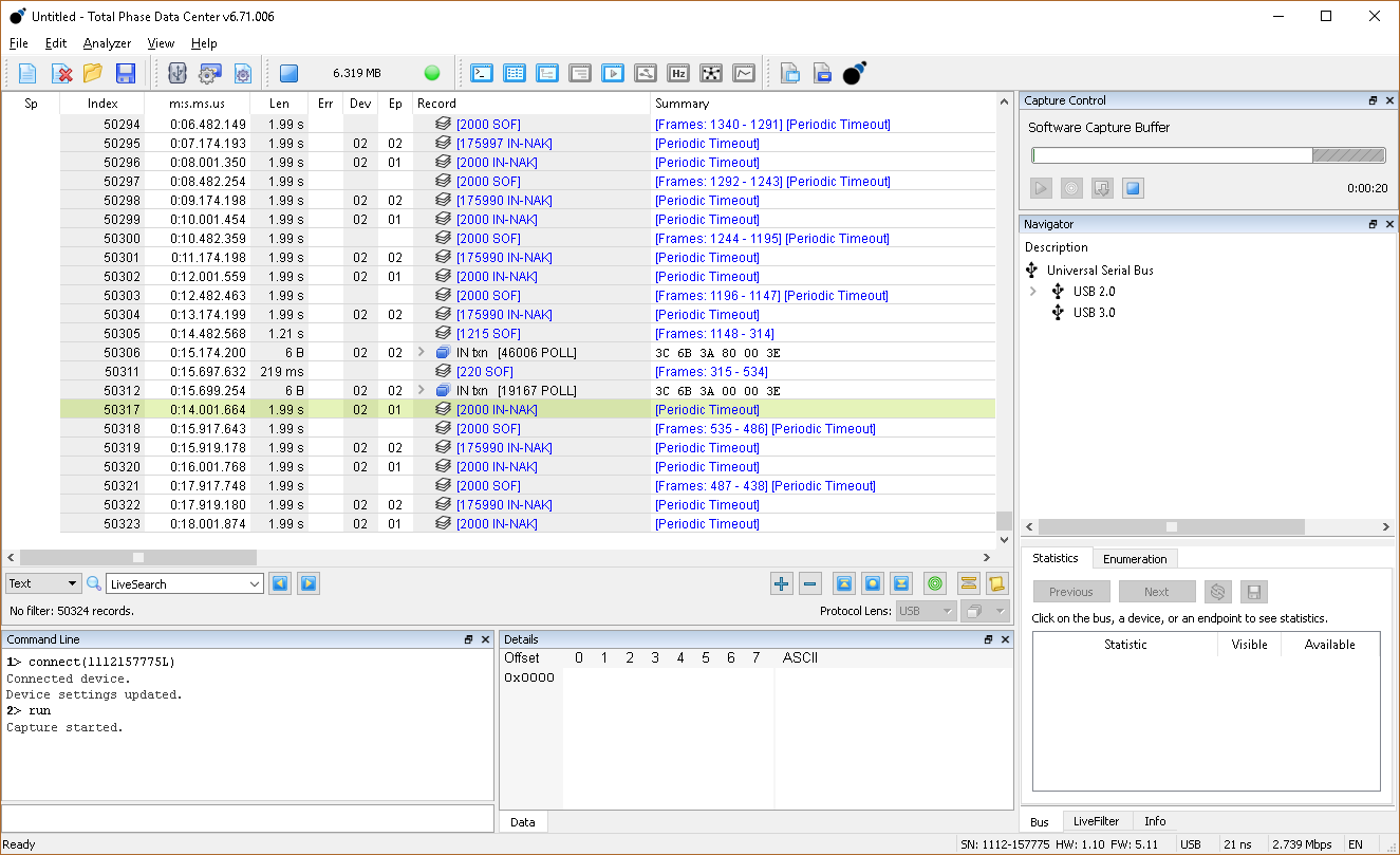

    I have the system tapped inline with my beagle and this is what I see:
    (when I push a button on the device and it says that it successfully queues up a send to the host)
    I pushed the button in there somewhere...  When I initiate the data transfer from the host side, the data all goes through and it continues with this behavior.

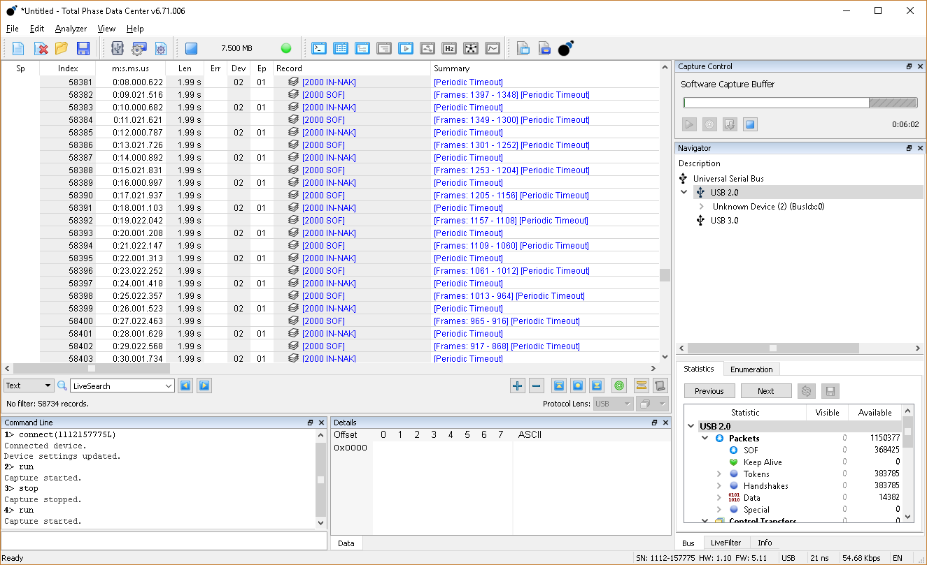

  • Hello Chris
    You would need to capture the failing transaction point where the issue begins.
  • Hi Amit

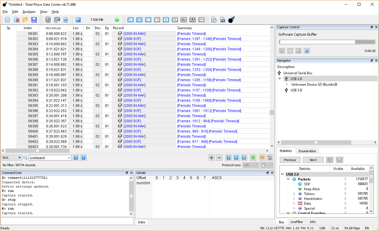

    That's what the reading looks like when I'm tapping the line and I push the button; it doesn't look like anything is done during the time when it's trying to send to the host that it has a little message.  For contrast, this is what I see if the button link is working:
    Chris
  • Hello Chris,
    It is tough to say since the two logs looks identical. And we are not sure where the device poll by the host stops reading data. Is it possible to run this with a PC as a host?
