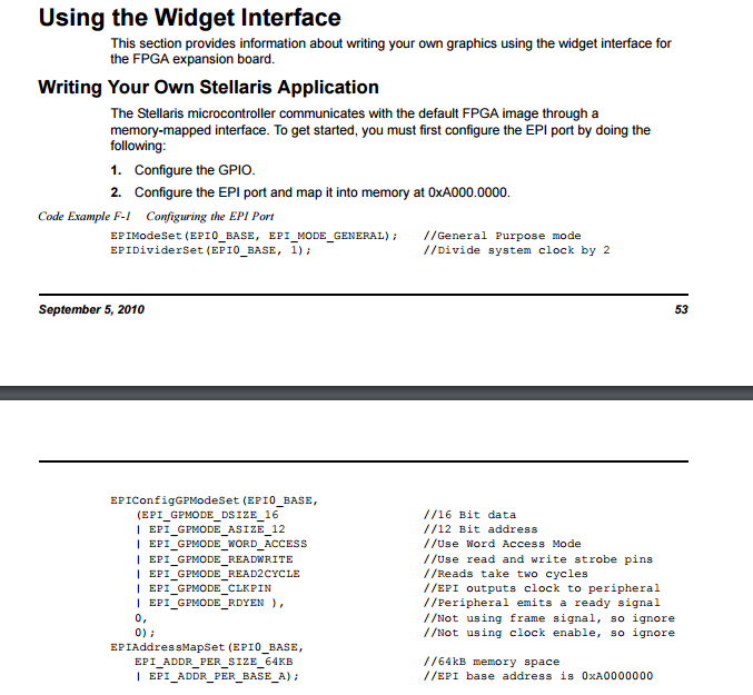

I have a 64KB SRAM interface to the EPI port that I want to initialize.
However, the data do not read the write and occur terminating execution
I wrote the code (see figure below)
#define SRAM_START 0xA0000000
#define SRAM_SIZE 0xFFFF
void Init_SRAM(void)
SysCtlPeripheralEnable(SYSCTL_PERIPH_EPI0);
EPIModeSet(EPI0_BASE,EPI_MODE_HB16);
EPIConfigHB16Set(EPI0_BASE, EPI_HB16_MODE_ADDEMUX | EPI_HB16_WRWAIT_0 | EPI_HB16_RDWAIT_0 | EPI_HB16_WORD_ACCESS | EPI_HB16_CSCFG_CS, 0);
EPIDividerSet(EPI0_BASE,0X1);
EPIAddressMapSet(EPI0_BASE, (EPI_ADDR_RAM_SIZE_256MB | EPI_ADDR_RAM_BASE_6));
