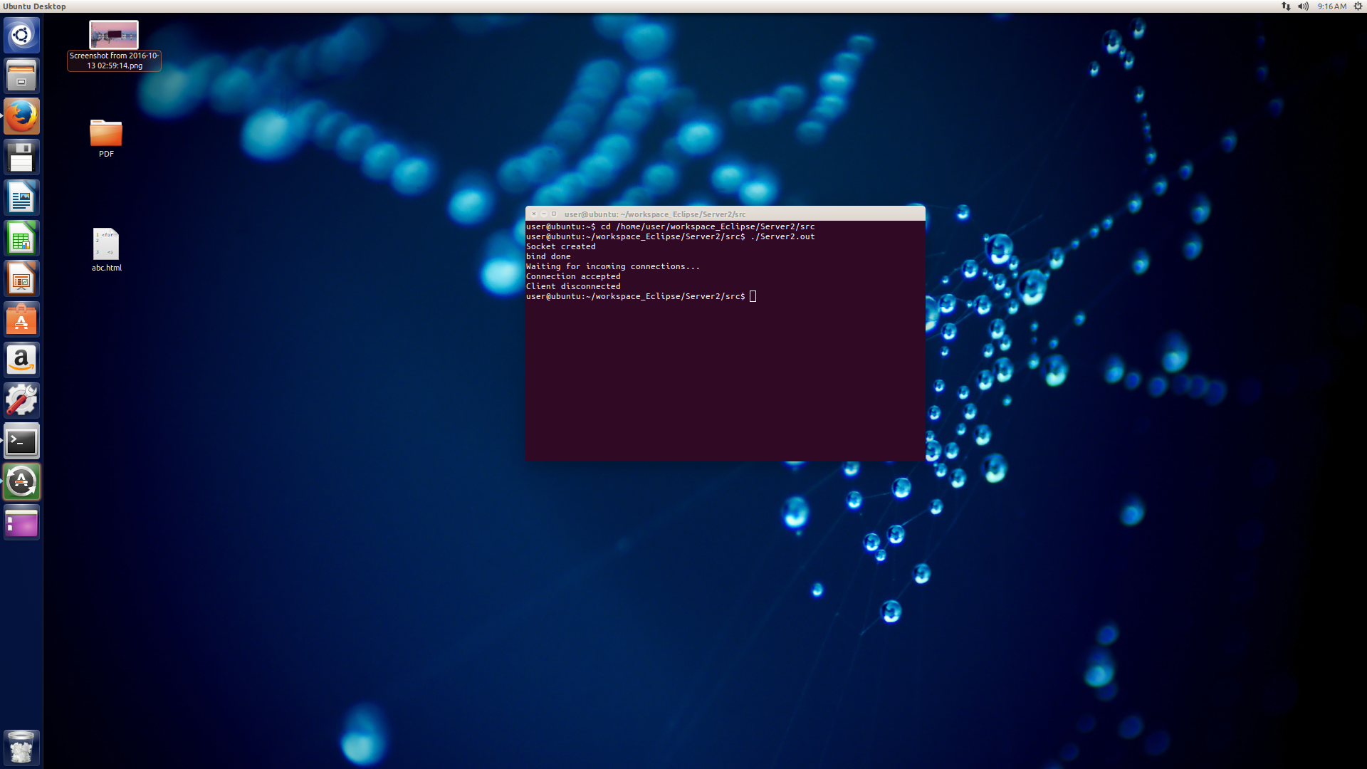

  • Thank you f.m for your reply.
    I have tested the server by sending TCP/IP packet using Packet Sender Tool click Here.
    It shows the Connection Accepted as this:
    But nothing happens when I run my program.
    Kindly help.
  • But nothing happens when I run my program.
    The output "connection accepted", as seen in the sceenshot, shows that the TM4C client application basically works.
    But neither do I have such a TM4C129 board, nor do I have the time to debug it for you.
    The WireShark application (on PC side, AFAIK available for Windows and Linux), is useful to trace the IP traffic during debugging.
  • The output "connection accepted", as seen in the screenshot, shows that the TM4C client application basically works.
    The connection established when I send data packet using Packet sender tool and the server remain shows "waiting for incoming connection...." when my client application runs.
