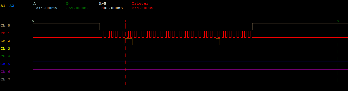

TM4C1294 connected with SPI to 23LC1024 SRAM
I'm back with another SPI question.
I am still using the TM4C1294 development board, but this time I am trying to get an external SPI SRAM chip to work.  The SRAM being used is a Microchip brand 23LC1024.
The issue I am having is that the SRAM chip is not sending data back to me under any circumstance. I am not sure if my issue is code or hardware at this point because both seem to follow what I can find every where else on the web. Code and Connections below. I use an oscilloscope on all four lines and I see exactly what i expect sent to the SRAM but that is all.
Any help is appreciated as I am stuck.
Connections to 23LC1024:
Pin 1: CS: Pulled up through 10k resistor, connected to PQ1 on board
Pin2: SO: connected to PQ3
Pin3: connected to 3.3V
Pin4: Vss: connect to ground
Pin5: SI: Connected to PQ2
Pin6: SCK: connected to PQ0
Pin7: connected to Vss Vcc
Pin8: Vss: connected to 3.3V  (Edit as Pointed out by Amit)
Pin8: Vcc: connected to 3.3V

    GPIOPinTypeGPIOOutput(GPIO_PORTQ_BASE, GPIO_PIN_1); //CS
    GPIOPinConfigure(GPIO_PQ3_SSI3XDAT1);
    GPIOPinConfigure(GPIO_PQ2_SSI3XDAT0);

    GPIOPinTypeSSI(GPIO_PORTQ_BASE, GPIO_PIN_0 | /*GPIO_PIN_1 |*/ GPIO_PIN_2 | GPIO_PIN_3);

    SSIConfigSetExpClk(SSI3_BASE, ui32SysClock, SSI_FRF_MOTO_MODE_1,
                       SSI_MODE_MASTER, 10000000, 8);
#else
    SSIConfigSetExpClk(SSI3_BASE, SysCtlClockGet(), SSI_FRF_MOTO_MODE_0,
                       SSI_MODE_MASTER, 1000000, 32);

    while(SSIDataGetNonBlocking(SSI3_BASE, &pui32DataRx))
    uint32_t Reset = 0xff;           //0b 1111 1111
    uint32_t write = 0x01;
    uint32_t write_2 = 0x40;
    uint32_t read = 0x05;
	GPIOPinWrite(GPIO_PORTQ_BASE, GPIO_PIN_1, GPIO_PIN_1);
	SysCtlDelay(ui32SysClock / (10) );
	GPIOPinWrite(GPIO_PORTQ_BASE, GPIO_PIN_1, 0);
//	SSIDataPut(SSI3_BASE, Reset);
	SSIDataPut(SSI3_BASE, write);                          //write to write mode register 0x01
	SSIDataPut(SSI3_BASE, write_2);						   //Write the mode 0x40
	SSIDataGet(SSI3_BASE, &junk);						   //Junk reads
//	SSIDataGet(SSI3_BASE, &junk);
	SSIDataPut(SSI3_BASE, read);							//write to read mode register 0x05
	SSIDataPut(SSI3_BASE, 0x00);							//Junk write
	SSIDataGet(SSI3_BASE, &junk);							//Junk read, watching osciloscope for responces
	while(1)
		//test write to the RAM at memory location 0x000002
		SSIDataPut(SSI3_BASE, 0x02);
		SSIDataPut(SSI3_BASE, 0x44);
		//test read from RAM at memory location 0x000002
		SSIDataPut(SSI3_BASE, 0x03);
		//See results on osciloscope but in the event that the string is to long catch it in UART as well
		int i;
		for(i = 0; i < 1; i++)
			UARTprintf("%x", junk);
		UARTprintf("\n");
