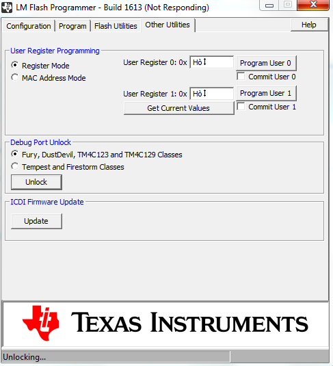

I want to unlock a TM4C129 on a custom board using the debug pins of Tiva C series EK-TM4C123GXL.
I have tried connecting the debug pins (TMS-TMS, TCK-TCK, TD0-TD0, TD1-TD1, RST-RST and GND-GND) of Tiva C to that of TM4C129  and by using the "Fury, DustDevil, TM 4C123 and TM4C129 Classes" feature of LM Flash Programmer utility I want to unlock the TM4C129.
But the problem is that LM Flash programmer utility crashes when I click on the unlock button.

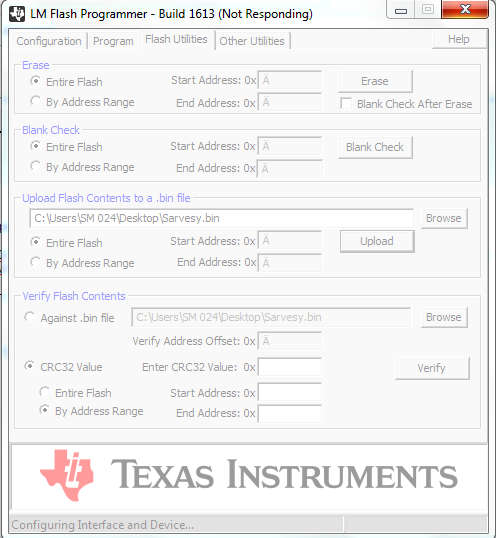

It also crashes while uploading .bin file(Screenshot attached)

  • Hi Amit,
    Thank you for your prompt reply!
    I do have referred to the above mentioned PDF before and have tried the exact same steps.
    But the LM Flash Programmer still crashes every single time whenever I press the unlock button.
    What is the solution over this? How do we resolve this?

  • Hello Sarvesh
    Change the PC and try it on another PC. Or install UniFlash application and try the same.

  • Hello Sarvesh,
    Can you please check the connection between the two boards and the change that needs to be done on the EK-TM4C123GXL to bypass the main MCU as given in the application note?
  • Hi Amit,
    I'm able to unlock now.
    I suppose the problem was with the drivers.
    What is I did differently this time is, on a different PC, I installed FTDI drivers (www.ti.com/.../lm_ftdi_driver) FIRST, for Stellaris A, and then the ICDI drivers (www.ti.com/.../stellaris_icdi_drivers), for Stellaris B.
    And then LM Flash Programmer was able to unlock successfully!
    The older PC's, however, are still not able to unlock. I tried to Update driver and give the local path to the FTDI driver, but Windows prompted that it had all the necessary drivers so couldn't really install the FTDI driver.
    Anyways, thanks for all the support. Thanks you! Really appreciate it!
