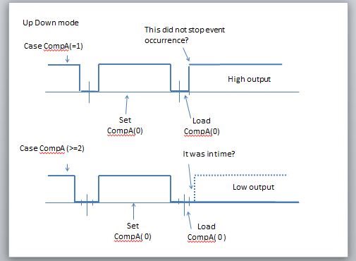

I have a question for the PWM control of TM4C129.
Set the PWM to the up-down mode, the LED will light up. (You can check the ek-tm4c1294xl)
CompA sets the Period value.
While the output of the PWM, it will reduce the value of CompA by one.
Then, the output of the PWM is changed to 0% from the duty ratio of 100%, LED will be black out.
However, if set a 0 to "CompA", it will be full lighting.
I where it was confirmed, the 1-> 0 and the output to alter the CompA will be next to High,
n-> 0 is varied and CompA Low. (n>=2)
1-> 0 change of only will be High.
CompA is 1, the next time is changed to 0, the rise of the PWM would be executed?

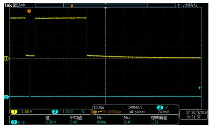

Capture PWM High
Capture PWM Low

  • When We changed the register A, we asked about the output of the PWM.
    As follows is for the register of change.
    Case 1.
    Change the CompA from 1 to 0.
    Case 2.
    Change the CompA from 2(or more) to 0.
    Result
    In case 1, PWM output is high fixed.
    In case 2, PWM output is low fixed.
    Load / Count should be set to 3 or more.

    When Period is changed from 2 or more to 0 => PWM output becomes low
    Does this operate of the PWM Module has been described in the manual?
    Da
  • Hello Da
    I checked the code today and
    Case-1: I type 1 and then 0 => The output of the PWM was low
    Case-2: I type 2 and then 0 => The output of the PWM was low
  • Hello Amit,
    Thank you for checking.
    I'm very thankful.
    May I ask you to help me?
    Did you use the API of TivaWare?
    If you use the API of TivaWare, you need to set the reverse of a number.
    Value when using the API
    Case-1: I type Period-1 and then Period => The output of the PWM was ___
    Case-2: I type Period-2 and then Period => The output of the PWM was low
    Value when looking the Register
    Case-1: I watch 1 and then 0 => The output of the PWM was ....
    Case-2: I watch 2 and then 0 => The output of the PWM was low
    If the you have done is correct, please tell me how.

    I used your code for the experiment.
  • Hellow Amit.
    Thank you for reply.
    To generate the problem
    0. Write Program Image.
    1. Open & Connect Console.
    2. Push Reset Button
    "PWM Duty" is Displayed.
    3. type "19<enter>"
    "0019" is Displayed.
    4. type "20<enter>"
    "0020" is Displayed.
    >>> PF0 is High, LED is turned on.
    5. type "18<enter>"
    "0018" is Displayed.
    6. type "20<enter>"
    >>> PF0 is Low, LED is turned off.
    Da
  • Hello Da-san,
    I have reproduced the issue now. Also an interesting thing is that it is happening for UP-DOWN mode and not for the DOWN mode.
  • Hellow Amit-san,
    I think ...
    Period-1 is set, when it user-modified, the next PWM waveform starting at Period-1, and end with changed value.
    (need check)
    Other value is set, when it user-modified, the next PWM waveform starting at changed value, and end with changed value.
    If the changed value is more Period( or 0), so Compare is not generated, starting at Period-1, to continue as it is.
    Thus, also occurs in up-down mode is also in the up mode.
    Da
  • Hello Da
    I checked with DOWN mode and it does not occur. The issue seems to be in UP-DOWN only.
