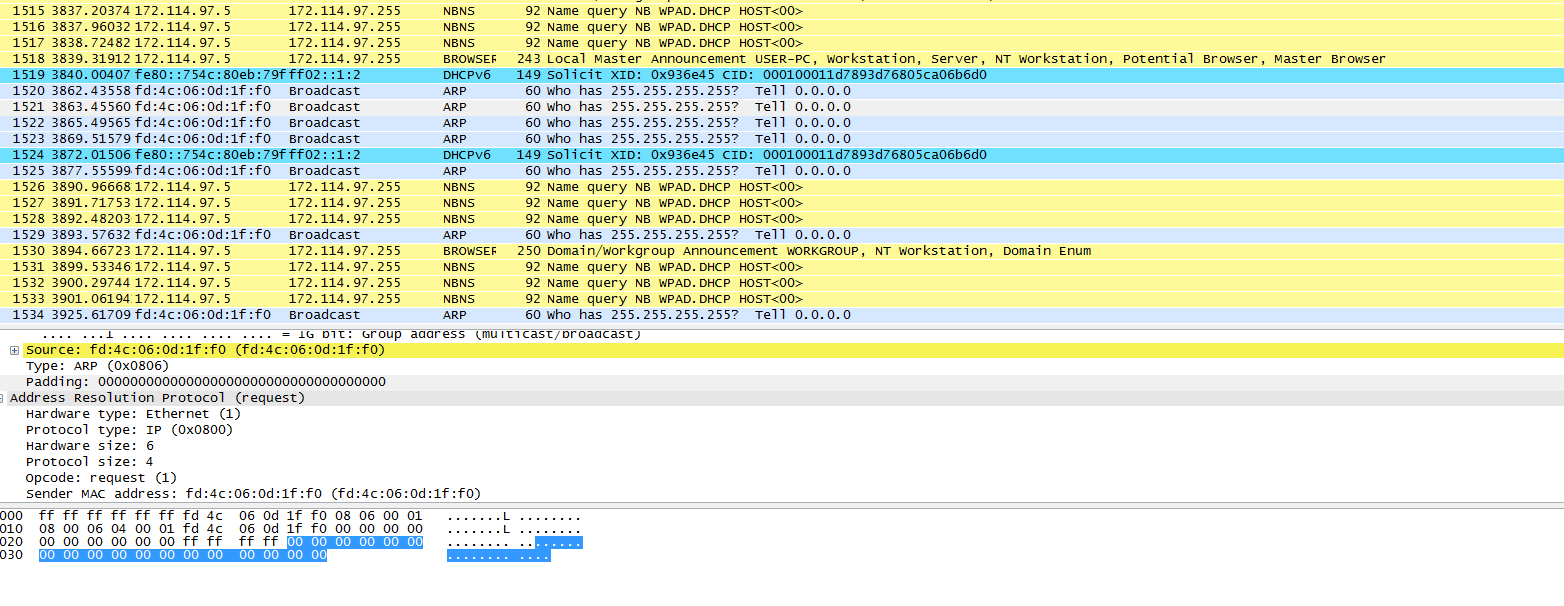

  • Hi Amit
    I havn't done it.
    I can see the ARP pkt used the default MAC address which is locate the fun EnetReconfig:
        if((ui32User0 == 0xffffffff) || (ui32User1 == 0xffffffff))
            // MAC address has not been programmed, use default.
            g_sMACAddr.addr[0] = 0x00;
            g_sMACAddr.addr[1] = 0x1a;
            g_sMACAddr.addr[2] = 0xb6;
            g_sMACAddr.addr[3] = 0x00;
            g_sMACAddr.addr[4] = 0x64;
            g_sMACAddr.addr[5] = 0x00;
    But if I change run = SRAM to run = FLASH, BOOTP works ok.

  • Hello user4461578,
    The Boot loader is stored on Flash and executes from SRAM after copying itself. If you do a power cycle and then does it show the BOOTP?

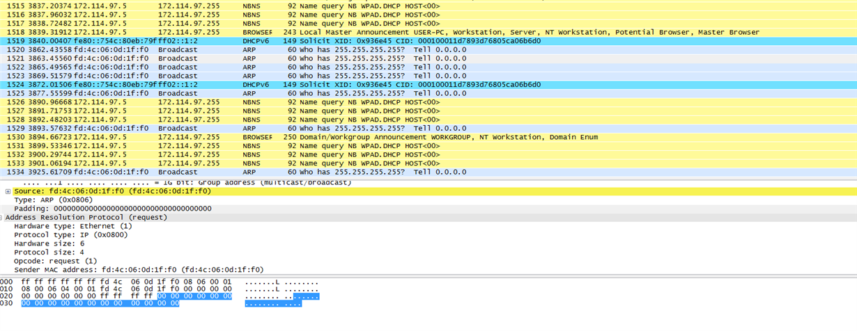

  • No , it show ARP, and the ARP pkt length is 60 not 42:
    Frames must be at least 64 bytes long, not including the preamble, so, if the data field is shorter than 46 bytes, it must be compensated by the Pad field. This is as per the Ethernet Standard.
