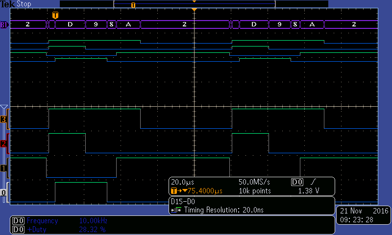

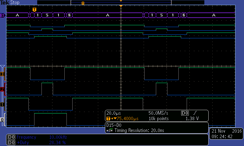

  • Our poster claimed that DeadBand INFLICTS UPON ALL Generators w/in a PWM Module Block!   This reporter challenged that (yet another, REACH) presented, as always - with NO/ZERO justification or support.    Such is (at minimum) curious - worse still - it serves to camouflage false advice/guidance!
    Below is a most effective counter to poster's ERRANT, unfounded (minus any justification (beyond hope/reach)) claim!
    DEADBAND IS NOT FORCED UPON EACH/EVERY PWM GENERATOR - MAY BE SELECTIVELY APPLIED!
    Kindly note that (digital) channels "0 & 1" display Deadband.   Channel "0" holds the prescribed duty cycle - Channel 1 is SLAVED to Channel 0 - it may NOT be independently Set when Deadband is enabled!
    Yet - contrary to our challenging poster's "belief/reach"  NO/ZERO Deadband inflicts upon the 2nd PWM_Generator!   That's proved by their signal overlap - and the ability to independently set duty cycle.   (yet not frequency)
    May we ask, "Why are such MISTAKEN claims made - when SO EASILY DISPROVED - and such data is so "quick/easy" to achieve?   (note too - NO Video is required!)
    DEADBAND HERE IS ENABLED UPON THE (SAME) TWO PWM GENERATORS.   (AS SHOWN ABOVE)
    Here Deadband has been enabled upon BOTH PWM Generators.  (Deadband value has been increased upon the top 2 channels)   Signals, Scope Attachment are exactly the same - only change has been the enabling of the "Call to PWMSetDeadband" for that 2nd PWM Generator - as explained in my post, above.
    House of cards - built upon a very flimsy foundation - occurs when one's "hopes/dreams/REACHES operate outside REALITY!"   Pity that...
    All of the above may be quickly/easily replicated.   Findings were made on (standard) TM4C123 LPad operating under "StellarisWare 9453."   (that's demanded by my firm's clients - newer version does not enjoy the security/robustness of (long) past version...)

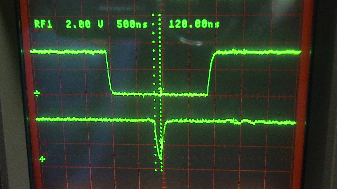

    50ns/cm can not include the falling edge pwmA and 200ns delay could not be witnessed by the human eye at such slow speed.
    But easily seen with an oscilloscope when used by someone who can handle triggering competently. cb1 has shown you captures before and again in this thread. It's quite easily doable. No video, jut a simple trigger. It's even doable with an analog 'scope. A digital 'scope will even give you a fairly easy measure of the jitter. I could have done it with oscilloscopes I have to hand 30 years ago.
    BP101 said:
    The figure below shows a center aligned signal produces a second current pulse configured for
    No. it shows a test waveform and setup used by Infineon/International rectifier to measure shoot through and the energy absorbed in the FET as a result.
    You left off 21c which shows the energy absorbed during the pulse.
    It has nothing to do with TM4Cs and their PWM generators.

    Really - then your understanding is FAR WORSE than (so many) here believed!
    Look again!  PWMGen0 outputs upon Scope Channels 0,1 below.   And clearly - to all with even the most basic knowledge - Scope's Ch1 is deadband commanded to Ch0.   PWMGen2 - part of the same PWM Module - clearly shows independent PWM operation of each channel - thus is "Free from Deadband."   Which you claimed - (quite WRONGLY) was impossible!    Might it be - instead - that your acceptance of fact - and reality - is impossible?
    You remain "blind to fact" accept only your (own) views - in light of - and especially in light of - massive evidence to the contrary.   I've made time/effort to (correct) your mistaken proclamations - if you cannot accept that there's little (anyone) here can do further.
