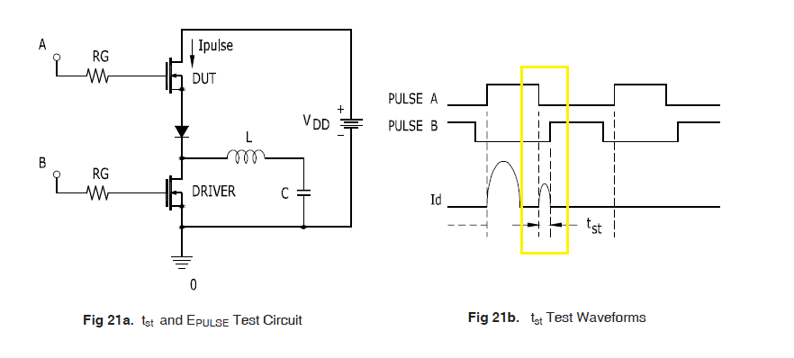

    Once again blown 15 amp fuse after 2 hours run time with 240ns dead band set PWMnDBRISE/FALL.  Additional padding sets 1us minimum pulse width well above FET blocking time 100ns.  The blown fuse error flag always sets DCUV (under volts) when that happens. Yesterday had several random PANIC flags with 200ns dead band one with faint pop sound others were silent. Today with 240ns dead band a loud pop heard from motor (fuse blew) and not a single M0nFault trip to indicate MOC (motor overcurrent). The odd thing is some days motor will run 4-5 hours without any issue so must be solar flares to blame. lol
    Seems like a FET shoot through occurs from dead band generator anomaly that randomly skips PWMnDBCTRL bit set directive for unknown reason.  That is odd because the PWM pulse period is vey low 80us (12.5Khz) and the duty cycle is roughly 78%.

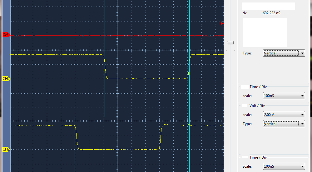

  • Hello BP101,
    Explain with a scope snapshot as to what is being added and where?

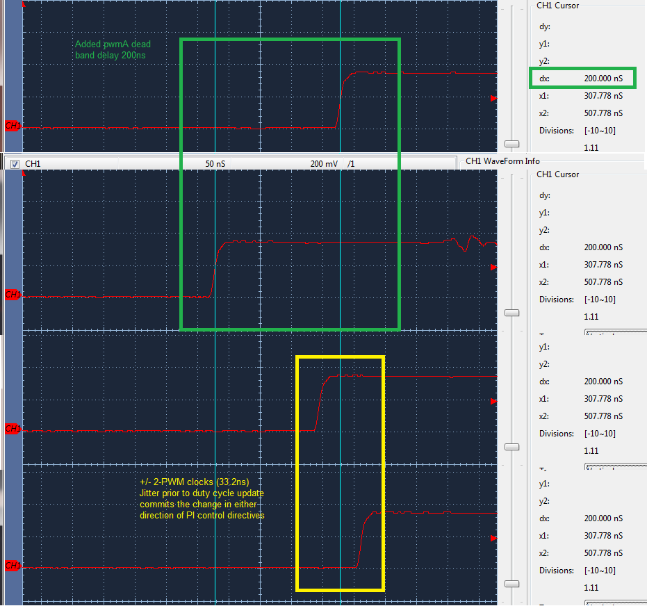

  • Hi Amit,
    Posted similar capture some time ago and observed something new occurring late yesterday on pwmA. Zoom reveals 50ns (3-PWMCLKS) delay between the PWMnDBRISE pulse and duty cycle changes of pwmA rising edge. The duty cycle change pwmA rising edge originate from the PI phase current and speed regulation SW. Had noticed space past was roughly 20ns and considered might be edge jitter or perhaps silicon latency, no big deal or was it?
    The 3 PWM clocks delay added to the minimum pulse is likely required PWMnDBCTRL set/clear enable bit setup time plus any latency.  Those edge positions are real time relative pwmA duty cycle and requires video to show. Will try later in the new week to capture evidence of the 3 PWM clocks delay.
  • Hi Amit,
    It was actually closer to 2 PWM clocks (33.2ns) measuring 50% slope. The pwmA new edge position asserts on either side (yellow box) of the existing position (green box) and jitters a while (33.2ns) prior to committing the new PI and duty cycle 4ms in the synchronous generator updates. So the new position of dead band in the pulse width of pwmA jitters in the duty cycle before steady state occurs. I don't believe such wide gap (33.2ns) prior to adjusting formula a bit more and it simply appeared as rising edge jitter with no gap.
    Sometimes it seems as if the jittering edge is only 1 PWM clock base falling edge trigger CH1 and the jitter is actually occurring on the rising edge. That scope capture is difficult to capture across the local network in 1 second updates. The real time event of edge movement is very constrained by PI in the duty updates.
  • 200mV/div? Something's not right.
    Also why are the traces all labelled channel 1?
    Finally what are the traces of?
    Robert
  • Scope software has bugs CH1 is actually 2v/div.
    What pwmA signal looks like relative to horizontal time events occurring. The yellow box represents new edge positions pwmA in the duty cycle which at times may include 200ns delay (green box) though shifted to the right side off the screen. These are high speed edge changes and require real time video to show absolute behavior.
  • BTW: I was calling the gap between the first occurrence of rising edge pwmA and additional edges in the gap jitter (not shown). Upon widening +/- gap (33.2ns) reveals it might be required setup time (2-PWMCLKS) for dead band generators rising edge delay as it presented in the duty cycle pulse width update. The gap time acts more like a minimum required edge time for dead band generator 10 bit counter setup reflective of PWMnDBCTRL enable bit being rapidly set and cleared.
    The delayed edge (33.2ns) flashes on/off many times in the same position before going solid prior to the next update and edge movement in the duty cycle.

  • You've not yet explained why all the traces are labelled channel 1, or what the traces actually are. Or what triggering you used for that matter.
    As far as the order of magnitude on the vertical division, that looks like you have set up the probe incorrectly.
    Robert

  • Hi Amit,
    Upon review after having several panics increasing dead band 220n to 240ns and having (*20, *120) in minimum pulse width formula the fuse blew. And (*30,*130) formula with dead band (200ns) a gap 33.2ns occurs assume in (4ms) gen sync local global updates of the duty cycle. Only had one silent panic last night after 45 minutes and none at all several hours of testing morning hours.
    I suspect the 33.2ns gap becomes the minimum pulse width at certain times in dead band and duty cycle updates. Any thoughts?
    The 33.2ns gap might actually represent the remainder of the minimum pulse (400ns) after HW subtracts required setup time or propagation delay of pwmA signal asserting dead bands occurring later in PWM output control block local synchronous updates. The odd part is pwmA off time hovers near 9-10us in the duty cycle and the minimum pulse width constrains minimum off period in the duty cycle. Any thoughts?
    My gut tells me to again make the formula multipliers even higher but don't know why logically that should matter?

    Update 11.11.2016: PWM_GEN_MODE_NO_SYNC controls how center aligned signal pairs are created and where produced into PWM output control block. Especially when more than 1 generator is configured and (PWM_GEN_MODE_SYNC) across several generators. Simply to say a pair of center aligned signals can be produced does not infer any single generator in ALL sync modes of the PWM module will produce center aligned signals by its self. That is a fact!!
  • CH1 is pwmA edge times in the 50ns grid. One has to consider the 2 vertical lines (200ns) remain static, all the grids align. The left right side vertical line establishes the update time of each successive real time edge position. That is the thing about pulse width changes occurring temporary point in time, they don't hang very long in the same position order to make a point in a forum post relative a SW code piece asserting and constraining them. lol

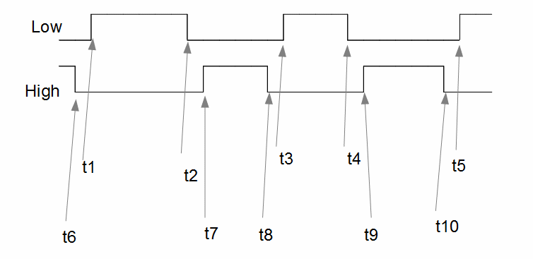

  • So far no panic faults 2 updates 5 hours running. A gap of 15-20ns pwmA (CH1) edge times is required in the dead band generator asserts (not shown) not sure why though. How is that possible?
    Answer: The PI control speed loop control is not maintain a steady state so the rising edge moves to small speed changes.
    Any thoughts??
    Interestingly pwmB (CH2) below capture seems to have dynamic duty cycle changes. Yet not sure how that is possible since the SW generator global synchronous update value pwmB never changes. Notice how a 200ns delay exists between 0.6us minimum pulse width setting in the changing duty cycle. The 200ns delay is some what explainable but not the dynamic duty cycle changes (not shown) as if magically being filtered down by pwmA in dead bands delay times.
    Update 11.22.16: A dead band delay (100-200ns) is only appended to the pulse width. So the original pulse width returns on pwmA/B when it is disabled for any single generator block in the sequence being all 3 generators are always cycling in 3 phase 120 degree motor commutation.

  • BP101 said:
    I believe it not as important how the edges are measured
    Not important how a measurement is taken!?? This may be silliest thing you've said yet.
    BP101 said:
    rather a GAP being identified and when or how often GAP occurs in synchronous updates pwmA. The SW is updating the duty cycle every 1ms plus requested accumulated updates assuming pwmA/B never drops below DBRISE (LM3S errata #10 prohibited occurring).
    We've yet to identify that a gap actually exists. You won't share the information needed to determine what your screenshots mean.
    So yet again lets see if we can determine what you are measuring, a repeat of the questions you have yet to answer.

  • Robert answered your question several times, 1st capture posted (CH1) was falling edge, second post (CH2) likely rising edge. Again it is your opinion as to trigger polarity when It really don't even matter. The words steady state was mentioned several times implies the edges (pwmA) after dead band delay control should not be creating a moving (GAP). Hard to show that real time event happening with only screen capture when video would right away have removed questions from your thought process.
    After patching the update period count tracking routine SW (not posted) then noticed PI controller speed loop Integral setting after some time arrests random speed hunting in the 1's digit position of digital RPM. Monitored RPM should lock to the target setting at some point after rotor steady state, not forever remain hunting as it was 1-5 RPM around the target. Reason for pinging sounds was occurring from constant speed correction in pwmA edge moving so much after each dead band cycle. That gap occurred after 200ns dead band trailing edge and was moving in either direction relative to speed changes (1st capture) PI closed speed loop and should not remain hunting after the rotor load (63lbs+belt driven load) reaches steady state.
    Even after the gap stops moving disappears in a heavily loaded steady state, random inverter Panic can often inflicts MCU. Random MnFaults being tripped yet current was well below 12-14 amps peak at 130vdc @160v unregulated (sags). It seems to me hearing a pop sound during fault ain't good and signifies a random edge event of dead band timing may be to blame.
    Answer 11.11.2016: Synchronous updates of multiple generators must be made single directive, regardless if local dead band update mode is configured. Panic issue was covered in another post, for details search VDDA+ or VREF+.
    Contradictorily and this is the first time you've mentioned using different triggers. but I was only ever addressing your first image (your assertions with the second set of captures appear to have more issues at first glance, let's clear up whether your initial question has any basis first)
    There is no steady state in a running motor control.
    Nonsense, that's what oscilloscopes are routinely used for.
    Now let's take a look at what you can actually say from your first set of captures. I will assume you are correct in your 'most likely falling edge' assertion. I will also assume edge aligned PWM for simplicity since you appear not to be able to answer whether it is or not.
    Here is what the waveforms for high and low side will look like in a running motor control
    t1 to t3 is the PWM period which will remain constant
    t1 to t2 is the duty cycle D which will vary as the control runs.
    You trigger on t6,68,t10 And show in the capture a portion of of the high side showing the rising edges t7 and t9.
    You are claiming that there is an evident gap shown by those captures.
    So what determines where the edge t7 and t9 are? It will be the low period t6 to t7 for t7 or the low period t8 to t9 for t9.
    What determines the low period? The duty cycle D (t2-t1 for t7 or t4-t3 for t9) and the deadband (such as t1-t6).
    If we assume that the deadband is constant (as we would expect) do we expect the edge position to vary? Yes we do since the duty cycle will vary. There is no way to determine there is a variation in the deadband from these capture and indeed no reason to suspect that there is.
    Robert

  • Nope, that drawing is pretty much the definition of deadband. Sure the two deadbands don't have to be the same but they usually are and it wouldn't change the discussion even if they weren't.
    At this point all you've shown is that the edge of a varying PWM changes. Quelle Surprise
    Now there is a way of measuring the actual deadband. It doesn't require a video capture and it even lends itself to showing you any jitter visually and quite indisputably. It's not even difficult.
    Robert

    The data sheet suggests a center aligned signal can be created by the PWM generator, it don't say by what means or in all cases. In slow decay (pwmB kept near 100% duty or less), each generator then produces left or right aligned signals depending on trigger polarity (NOT center aligned). Actual center alignment occurs across 2 generators (pwmA to pwmB) of co-phase partners. Once a generators CMPB has been set less than 50% of CMPA count, CMPB then refuses SW directives to reduce the pulse width in global synchronous updates. Once PWM module enters slow decay it remains in slow decay (indefinitely) no matter the changes sent to the PWM module during synchronous updates. Seems to be an inerrant limitation of the PWM module or something is wrong in the time base.
    Have discovered each generators counts are not incrementing exact same values even after a time base synchronize. Or the PWM module is reset prior to setting the enable clocking bit in PWMnCTRL registers. Either way the comparators lock to the correct value but all 3 GENS are not producing synchronized counts (CCS debug) as expected.

    >Nope, those drawings are pretty much the definition of dead band.
    Centre or edge aligned, the definition of the deadband is identical. The drawing I made would not change although the reference point would. Though the fact you don't know if you have a centre aligned PWM is rather worrying.
    Robert

    Actually your signals infer center alignment in a (single) PWM generator producing dead band only configured with PWM_GEN_MODE_NO_SYNC. Your kind of signal is useful in H-bridge power supply design but not 3 phase commutation requiring PWM_GEN_MODE_SYN.  That changes center alignment to exist between generators and dead band distribution changes as well.
    Therefor your entire argument posted waveform being nonsense is busted. 50ns/cm can not include the falling edge pwmA and 200ns delay could not be witnessed by the human eye at such slow speed. The period end edge positions are all that can be captured in 50ns/cm.  Attempting to change the posters presentation to fit your idea of what is proper signal and generator alignment suggests you are a student in this post.
    The figure below shows a center aligned signal produces a second current pulse configured for PWM_GEN_MODE_NO_SYNC. Notice the H bridge circuit has no co-phase H bridge partner and reflects only PWM_GEN_MODE_SYNC. The LM3S/TM4C data sheet does not mention generator center alignment becomes distributed between generators in PWM_GEN_MODE_SYNC and should. Might be due to pwmB duty cycle being so high compared to pwmA also contributes to distribution occurring. For that reason pwmA must remain high above PWMnDBRISE to account for the distribution of enabling dead band generators during global synchronous (updates) in the (local updates) of the PWM control block changes sent to the MCU pins in a single itteration. Surely that translates into a specific number of PWM clocks in both SYNC modes. The question how many PWMCLKS in each mode?
  • I'm don't think there is anything in that post that is correct even if you correct for the bad usage of infer. (The diagram didn't 'infer' a damn thing)
    Robert
