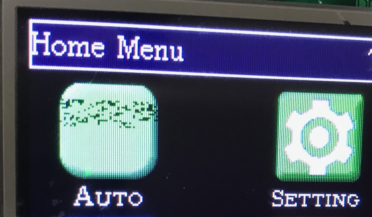

I am developing a touch screen based Application on Tiva TM4C123GH6PM and with kentec display. I am using Grlib for the application development.
I am using a quite a few images in the application which I am saving all Images as constant C array like " const uint8_t g_pucBlue50x50[] ". Initial stage of my application development everything was fine but as I have added more Images to application for next phase of development I could see some Pixels being missed on One Image.
can anyone let me know the cause/solution for this problem.
Observations:
- Tried to convert the Image to C array again hoping the problem with Image but it's not :(
- Flash Usage: 31% out of 262k
- SRAM Usage: 28% of 32768
Please find the Attached screenshot for reference. You could see some black spots on the first Image(AUTO) of screen shot.

    Are the pixels missing on the same place. Did you try to paint white to see if the pixels are correctly getting lit up.
  • Hi Amit, ya the pixels are missing in the same place. I didn't check painting white. But I tried replacing other image but same issue. At the same place when I go to next screen I couldn't see a problem.
  • Hello BNB
    So the panel is working fine. Which version of TivaWare are you using?
  • Hi Amit, I am using latest version 2.1.3.156 of tivaware.
  • Hello BNB
    Could it be a problem in the image itself? Did you replace it with another image, like swapping the "Setting" and "Auto"?
  • Hi Amit,
    Yes, I tried Exactly same. Replaced Auto Image with Settings Image and then also I could see pixels being missed on the image replaced with Auto. Then I believed there is no problem with Image.

    The Problem I was facing was not with Pixels. It's in code developed by me, Which is still not clear why it is Happening. The reason I was able to find out is:
    RectangularButtonStruct(GFX_Panels + Home, HomeMenu + 1, 0,&g_sKentec320x240x16_SSD2119, 15, 30, 50, 50,PB_STYLE_IMG|PB_STYLE_TEXT, 0, 0, 0, 0,0, 0, Home_Speed,0, 0, 0, OnHomeMenuPress)
    In the above push button definition, I have added style as PB_STYLE_IMG | PB_STYLE_TEXT but not specified font or any text. But it's taking some garbage text and filling it on Push Button which looks like pixels missing.
    Now, I want to understand, though I am not specifying any text  why it is taking some garbage data/text to put on Image??

  • Hello BNB,
    I have not used PB_STYLE_IMG with PB_STYLE_TEXT. If you need to use text, I would suggest
    PB_STYLE_FILL | PB_STYLE_OUTLINE | PB_STYLE_TEXT

  • Hello BNB
    I use PB_STYLE_IMG when the push button contains the information. PB_STYLE_TEXT is when i want to change the information. As an example a regular keypad I would draw with PB_STYLE_IMG, but an unlocking randomized keypad, I would draw with PB_STYLE_TEXT as the content is only what I need to change.
