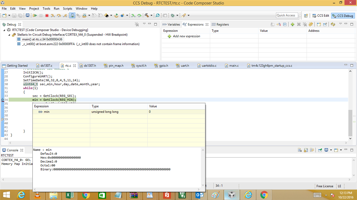

No values being red from my DS1037 on TM4C123G Launchpad

I am facing the problem given in the picture. No value appears on the console.
