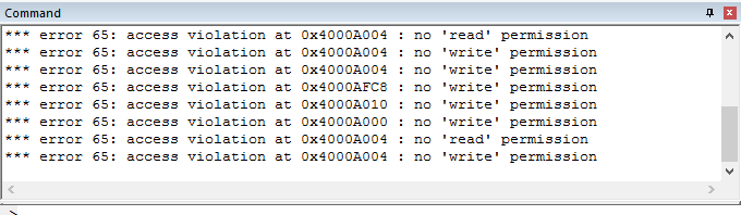

Hi All,
I'm trying to use the SSI2 module (PB4-7) to talk to the MCP3008 ADC peripheral via Freescale SPI. I am using the Keil Compiler/IDE. I used this youtube video to give me some guidance on how to set everything as well as the instructions from the datasheet (copied into my comments).
However, when I try to set up all the SSI registers in a debug session, certain ones exhibit error 65: no read/write permission seen here:
I followed the instructions exactly when writing the code (see below) as the datasheet said so I'm a bit confused as to what the problem could be. Any tips?

//1. Ensure that the SSE bit in the SSICR1 register is clear before making any configuration changes.
SSI2_CR1_R&=0xD; //clear bit 1 (SSE bit) of the SSI2 Control Register 1
//^^^error 65: access violation at 0x4000A004: no 'read' permission
//2. Select whether the SSI is a master or slave:
//a. For master operations, set the SSICR1 register to 0x0000.0000
//b. For slave mode (output enabled), set the SSICR1 register to 0x0000.0004.
//c. For slave mode (output disabled), set the SSICR1 register to 0x0000.000C.
SSI2_CR1_R=0x00000000;//configure for master mode
//^^error 65: access violation at 0x4000A004: no 'write' permission
//3. Configure the SSI clock source by writing to the SSICC register.
SSI2_CC_R=0x0;//use system clock with divisor factor enabled
//error 65: access violation at 0x4000AFC8: no 'write' permission

  • Hello Jim
    I have not seen such as an issue so far. Only thing I can think of is that the SSI clock enable has not been executed when the registers were being accessed. Can you check RCGCSSI bit for SSI-2 is set to 0x1 before the debug registers are accessed.
  • Hi Amit,
    I'm a bit confused about the wording of your request. As was pasted in my code above, I set SYSCTL_RCGCSSI_R=0x04; which should set bit 2 of that register. According to the datasheet (page 347) that is indeed the SSI enable bit for module 2 which is the module I am trying to use. Perhaps your theory could be applied to the next line when I tried to set the SYSCTL_RCGC2_R|=0x00000002 in order to give Port B a clock. I'm a bit confused about whether I should be using this one or SYSCTL_RCGCTIMER_R. Could you clarify that? I tried setting bit 2 on both and that doesn't seem to work either.
    Jim
  • Hello Jim,

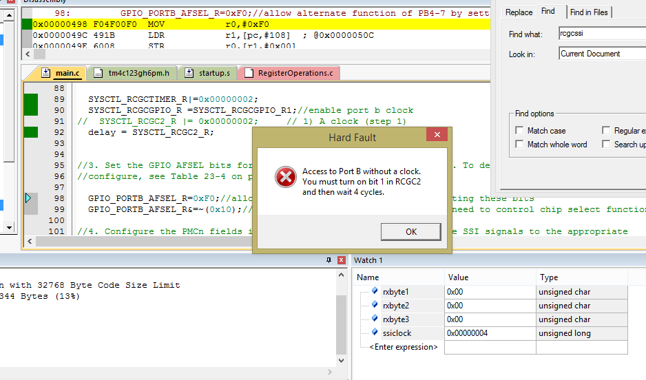

    I would first not use the RCGC0, 1, 2 registers at all and instead use the RCGCGPIO, RCGCSSI and RCGCTIMER register. Second of all instead of using the DRM style of coding, move it to proven TivaWare.
    Since I have not seen the error earlier, I am curious to know if this is due to the Register debug window being opened when the peripheral is not enabled or being generated by IAR based on something that the code is doing?
  • Amit,
    I followed your advice and I tried setting up those three suggested registers and commented out the line where I set up RCGC2. The result I got was the following error in Keil: "Access to Port B without a clock. You must turn on bit 1 in RCGC2 and then wait 4 cycles".
    I am apprehensive about using TivaWare for this application because the peripheral I'm using has very specific requirements about the sequence it goes through in serial communication. I looked through the TivaWare software and it did not look like it had anything I could use.
    -Jim
  • Hello Jim
    First of all check the Register RCGCGPIO and make sue that the bit-1 is set for Port B access. Secondly, the TivaWare API follow the same sequence as you are doing and has additional checks also built, so I would not worry on that aspect.

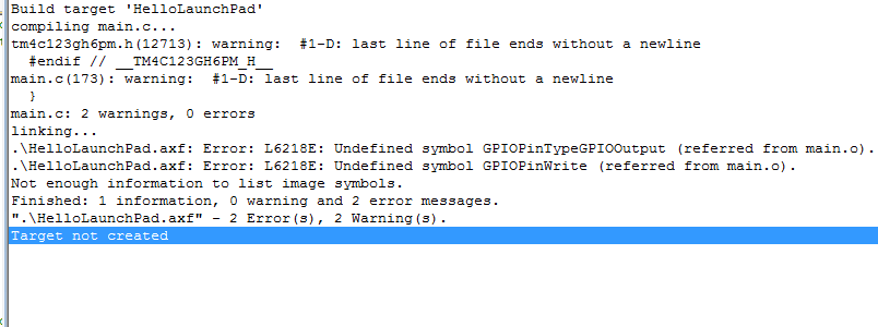

  • Ok. I am following your advice and now I am trying to just do a simple example where I blink some LEDs just so I can figure out how to properly use the API. Here is literally all of my code:
    #include "tm4c123gh6pm.h"
    #include "driverlib/gpio.h"
    #include <stdint.h>
    void Delay(void);
    void
    GPIOPinWrite(uint32_t ui32Port,
    uint8_t ui8Pins,
    uint8_t ui8Val);
    void
    GPIOPinTypeGPIOOutput(uint32_t ui32Port,
    uint8_t ui8Pins);
    uint32_t GPIO_PORTB_BASE_ADDRESS=0x40005000;
    uint8_t GPIO_ALL_OUTPUTS=0xFF;
    uint8_t GPIO_ALL_HIGH=0xFF;
    uint8_t GPIO_ALL_LOW=0xFF;
    int main(void){
    GPIOPinTypeGPIOOutput(GPIO_PORTB_BASE_ADDRESS, GPIO_ALL_OUTPUTS);//set all to outputs
    while (1){
    GPIOPinWrite(GPIO_PORTB_BASE_ADDRESS,GPIO_ALL_OUTPUTS,GPIO_ALL_HIGH);//set them high
    Delay();
    GPIOPinWrite(GPIO_PORTB_BASE_ADDRESS,GPIO_ALL_OUTPUTS,GPIO_ALL_HIGH);//set them low
    Delay();
    void Delay(void){unsigned long volatile time;
    time = 727240*200/91; // 0.1sec
    while(time){
    time--;
    I ran into a couple weird compiling errors  where uint32_t was not recognized in the gpio.h file that I alleviated by using #include <stdint.h> in the gpio.h file. I think I'm almost there but now I'm running into the following linking issue:
    Any advice you could give would be much appreciated.
    Jim
  • Hello Jim,
    The precompiled driverlib has not been added to the linker stage
  • Forgive my ignorance, Amit but I am fairly new to this (clearly). What exactly do you mean "has not been added to the linker stage" and how would you recommend I resolve the issue in order to get code that compiles and accomplishes my goal?
    Thanks!
    Jim

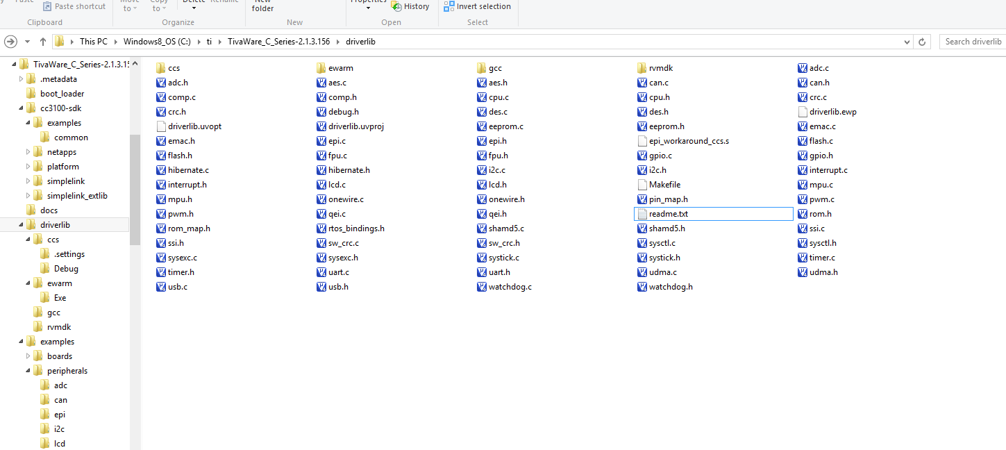

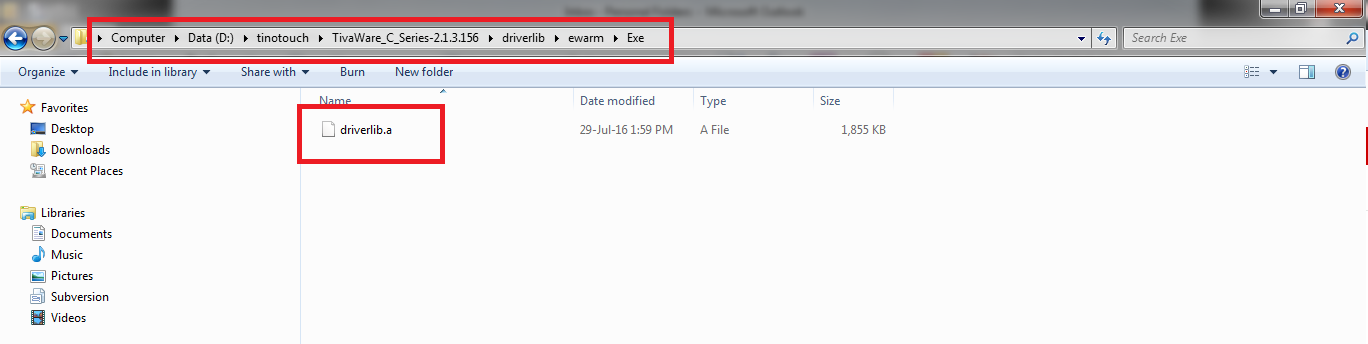

  • Hello Jim
    The driverlib has a precompiled archive file under TivaWare installed path/driverlib/iar
    You need to add the same in the Project options under linker.
  • I don't see an IAR folder here:
  • Hello Jim,
    Under TivaWare as shown in the snapshot below.

  • Hello Jim
    It looks correct to me. Do note one thing is that the Read access is in a while loop. Some devices require a certain amount of wait time between CS deassertion and assertion. You may need to add a delay loop after the CS is made high.
  • Ok. I will keep tinkering.
    In the meantime, a new issue with debugging. Somehow during a debug session I had some kind of failure that locked out the device.Whenever I tried to download code I got the message "Error! Unable to initialize target. Power cycle the device and try again". At the behest of other threads, I was told to use the LM debugger tool to do a debug port unlock. Doing this allowed me to download code but now when I try to debug I get kicked out after a second or so. Any tips on how to resolve this issue??

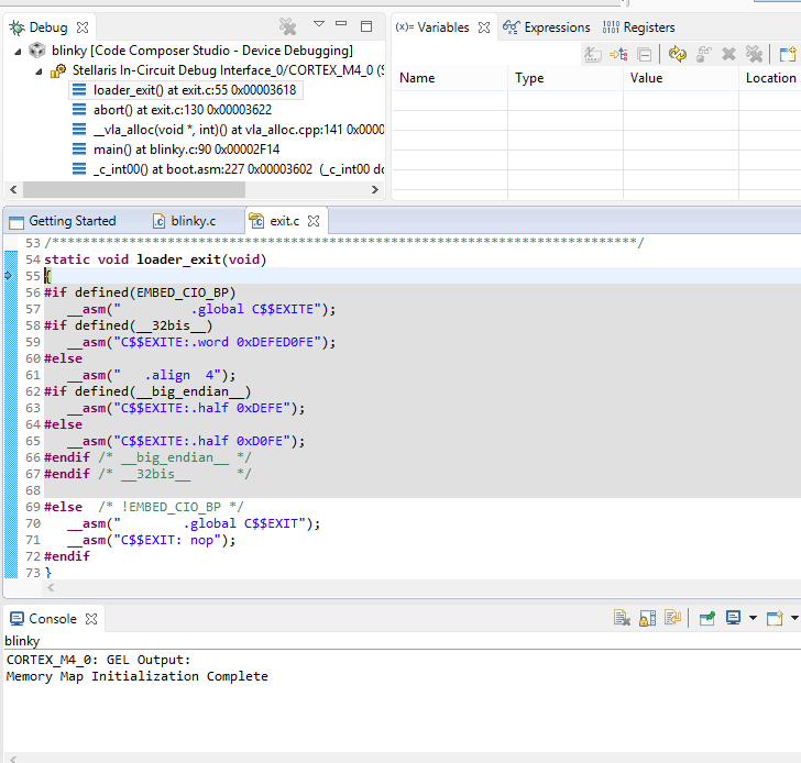

    As soon as I try to hit "run" in debug, exit.c pops up and blocks the program. My screen looks like this:
    I am very perplexed because, before, when I compiled and downloaded to flash with Keil, I verified on oscilloscope that at the very least I was getting a clock output from PB5. However, now when I try to just let the program run, this happens. Does this information give you any clues as to what might be the problem? I'd really appreciate the help.
    Thanks for your help so far and I hope to hear from you.
    Jim
  • Hello Jim
    Put a while(1); statement at the end of the main so that the CCS does not compile in the exit routines for the CPU.
