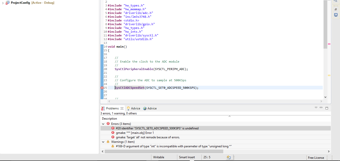

    void main()
    // Enable the clock to the ADC module
    SysCtlPeripheralEnable(SYSCTL_PERIPH_ADC);
    // Configure the ADC to sample at 500KSps
    SysCtlADCSpeedSet(SYSCTL_SET0_ADCSPEED_500KSPS);

    but errors occurred shown in the snapshot below
    please advice thank you
  • Hello Mohammad
    The parameter is SYSCTL_ADCSPEED_500KSPS and not SYSCTL_SET0_ADCSPEED_500KSPS
