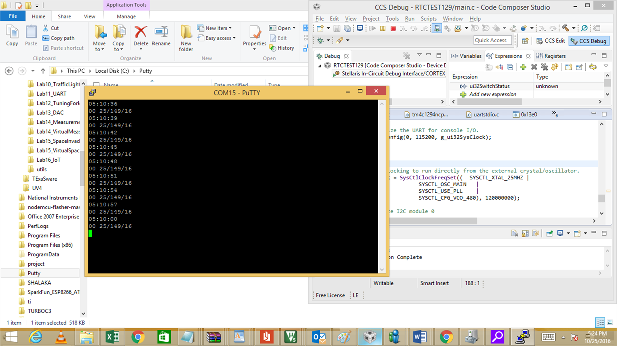

Hey guys, I am successful in initialising and interfacing the ds1307 with with TM4C1294NCPDT. I can see value  on the serial monitor. I can see the correct hour, seconds,date and year but the day , minute and month displayed are wrong. Here is the code I am using.

SetTimeDate(00,47,11,3,26,10,16);
unsigned char sec,min,hour,day,date,month,year;
while(1)
sec = GetClock(SEC);
min = GetClock(MIN);
hour = GetClock(HRS);
day = GetClock(DAY);
date = GetClock(DATE);
month = GetClock(MONTH);
year = GetClock(YEAR);
UARTprintf("%02d:%02d:%02d \n%02d %02d/%02d/%02d\n",hour,min,sec,day,date,month,year);
SysCtlDelay(g_ui32SysClock);
