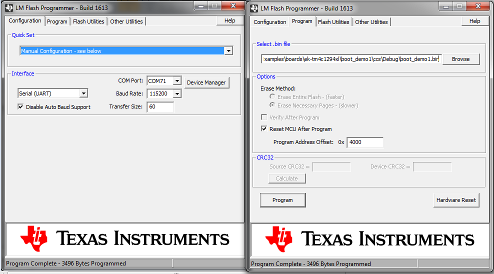

  • Hello John,
    I tried the same on my side and it works as expected.
    1. Program the boot_serial.bin on a launchpad which is erased. Except for the COM Port number specific to your PC setup, all others should be identical as below.
    2. Now Program the boot_demo1.bin as shown in the image below
  • HI Amit,
    Thank you it's working with 0x4000 start adress, but with 0x20000 it's not, it was the issue here for the UART Bootloader.
