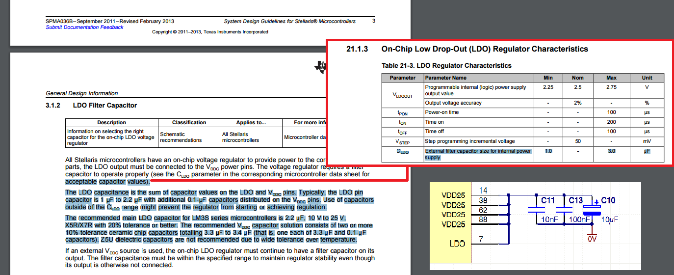

I have recently inherited a design at a new company and there is an issue I'm debugging where a LM3S1968-IQC sometimes fails (goes to an almost dead short and starts to draw 0.5A on the 3V3 rail, never to work again) on power-up. I think I have tracked this down to an incorrect capacitor value used in the design, but wanted to check if my reasoning seemed valid.
The capacitor in question is the bulk decoupling for the core voltage provided by the internal LDO. The application note/datasheet suggest between 1 and 3uF but a 10uF Tantalum capacitor was used instead. Taking into account the tolerance of the capacitor, this could, on some boards, lead to about 10x the charge that was specified - on start-up this might well overload the LDO. Could this potentially be causing the failure we see?

  • Hi both and thank you for your replies,
    There are indeed a number of boards with the issue, and test fitting the lower value cap does seem to prevent the failure - but as it's an intermittent issue, it's hard to tell if it's a real solution, or if we've just been lucky. I was hoping someone from TI might be able to make an educated guess - based on the internals of the on board LDO - as to whether this overly large capacitor could cause a full blown failure of the chip, as we are experiencing.
    Below is the part of the design that is suspect. The 10uF cap is commonly used in other parts of the board so presumably was chosen for convenience/cost saving.

  • Hello Charlie,
    Is that an electrolytic cap of 10uF?

  • Hi Amit,
    Poster noted that 10µF cap as Tantalum...

    On LM3S series we have used 1uF X7R ceramic multilayer capacitor with no problems. Tantalum capacitors are known also for high leakage current (depends...).
    Check/verify also for current on micro pins, depends on your additional hardware around.
