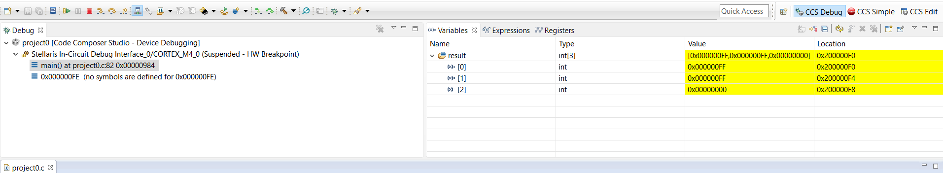

Hello guys, im having a problem on my code. Im currently using the Launchpad Tiva TM4C123 connected to a BMP085 sensor throught I2C bus trying to read the temperature.
Basically i can build it just fine and when i go to the debugger and open the register I2C_MDR_DATA, i keep getting 0xFF which means that im not connecting to the sensor. ALso created a pointer so i could get the info since the answer comes in multiple bytes. I should be getting something different from 0xFF...

int result[3] = {0,0,0};
SysCtlClockSet(SYSCTL_SYSDIV_4 | SYSCTL_USE_PLL | SYSCTL_XTAL_16MHZ | SYSCTL_OSC_MAIN);
InitI2C0();
I2Csend(slave_register);
I2Creceive(result, slave_register);
