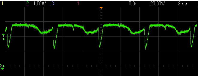

Hello everyone,
I have one question regarding reading value from the optical sensor, it is not quite a trouble as I would like for you to give me advice about the best approach to this issue. I used ADC hardware oversampling with the rate of 64x. And after that again I use the median value of 10 values read from ADC and use that the median to check whether it is above some value (for example 1500 (ADC)->0.6V)  and according to read value is above or below that border value I generated frequency output. Now in testing borderline cases I got signals in the images. In this cases, I'm not sure my approach is good. Maybe to use fixed value as a border for signal on and off is wrong. What do you think? Maybe some different approach in the calculation if the signal is on or off.

    Are you aware that SAR ADC's (the one's the TM4C has integrated) require a current to flow ? It doesn't matter here <<what>> the sensor measures, rather <<how>> it is interfaced to the ADC (impedance). Looks like you might have a problem there ...
