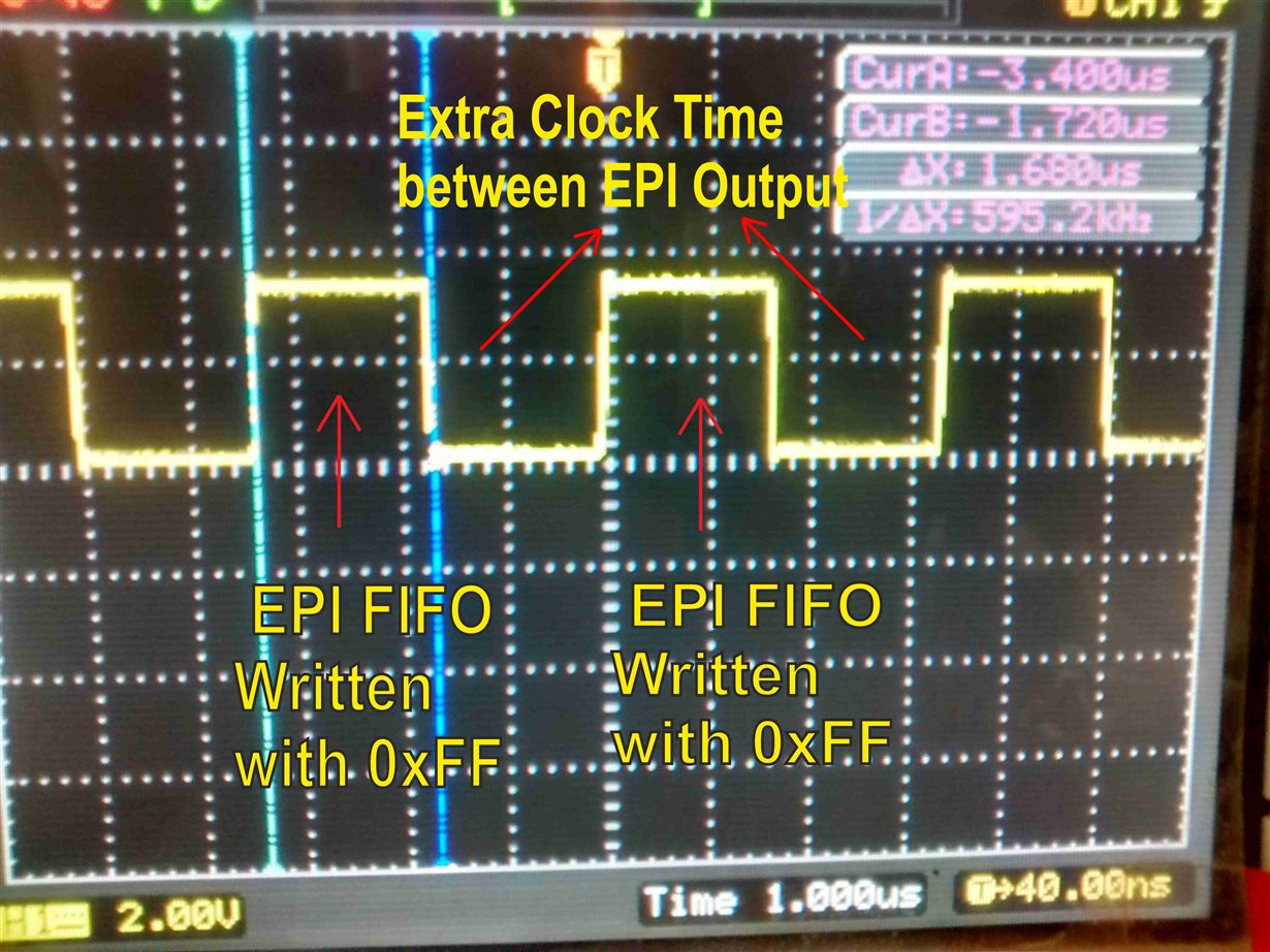

I tried configuring EPI for GPIO mode. EPI is supposed to generate interrupt at a rate of 600KHz. Instead, EPI generates interrupt at the rate of 300KHz. Attached is the code. Please let me know the issue.

    EPI is configured to generate interrupt when only one word or none is left in FIFO. We fill the FIFO with one word on every interrupt. So it needs to generate interrupt for every word shifted out of FIFO. EPI Divider is configured for EPI clock of 600KHz =120e6/200. i.e. Interrupt should occur for every EPI clock at the rate of 600KHz. I measured the frequency by toggling PM0 pin and found the toggling rate to be 300KHz.
    Today we probed the EPI outputs using CRO. The observation is that extra one EPI clock time is added between subsequent clock outputs. During extra clock time, Outputs are low. Please find the attached snapshots epi_ouput1.jpj( FIFO is written with 0xff and 0x00 as in uploaded code) and epi_ouput2.jpj( FIFO is written with 0xff and 0xff). Why is this extra low output is coming in between 2 subsequent outputs?

  • Hello Thangavel
    If you check the datasheet, there is always one clock cycle between any 2 accesses in GP mode. So what you are seeing is as expected.
  • Hi Amit,
    Solved the issue by setting 32 bits Data Size as given below:
    EPIConfigGPModeSet(EPI0_BASE, EPI_GPMODE_CLKPIN | EPI_GPMODE_ASIZE_NONE | EPI_GPMODE_DSIZE_32, 0, 0);
    Additional clock cycle is because of address even though Address size set as none. When Data size set as 32 bits, additional clock cycle is removed. We are now trying to configure DMA along with EPI. We will come back in case of any issue
