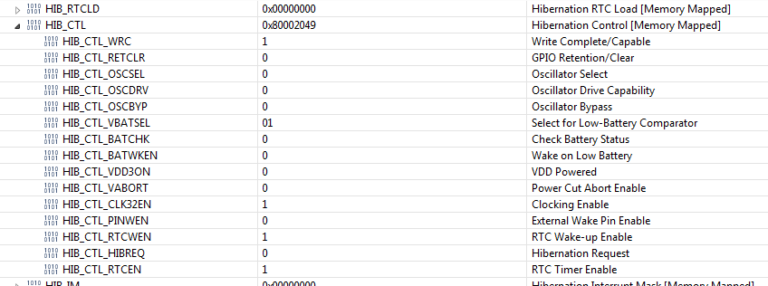

  • Hello Eric
    So the configuration of the device is for VDD3ON i.e. the 3.3V supply will not be shutdown. Now can you take a snapshot of the Hibernate configuration before the HibernateRequest is function is executed.
    You would need the VDD3ON bit set in the control register HIBCTL.
  • Hi Amit,
    It was for VDD3ON until I modified the circuit board this morning.  I haven't updated the schematic yet, which still shows the original configuration.  I now am using the HIB signal to switch VDD off.  This is the configuration with which I'd like to proceed.  Attached is the screen shot of the control register associated with the current configuration for VDD3OFF.  I'm still only seeing the HIB signal asserted for about 20 us.  Because this pulse is so short, VDD is never actually cutoff.  Is it normal for HIB to assert for only 20us and then reset if the power conditions don't match the configuration ( in this case, is it normal for the Hibernate module to automatically come out of hibernation if VDD isn't removed within 20 us?)  If so, I'll need to modify the circuit to ensure VDD is removed within this time period.

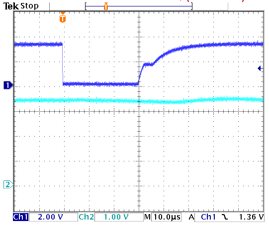

  • Hello Eric,
    Before making the change, can you please show me a scope snapshot of HIB and 3.3VSWITCHED supply when HIB is asserted low?
  • Hi Amit,
    Please see attached.  Dark blue is the HIB and light blue is 3.3VSWITCHED.
    By the way, I did reconnect WAKE to VBAT instead of 3.3VSWITCHED and didn't see any improvement.
    Eric

  • Hello Eric
    I ran the test case on my side and I got the following image. It is different from what you have. The HIBn signal remains low.
    I am not sure why it is the case that for your board HIBn comes back up

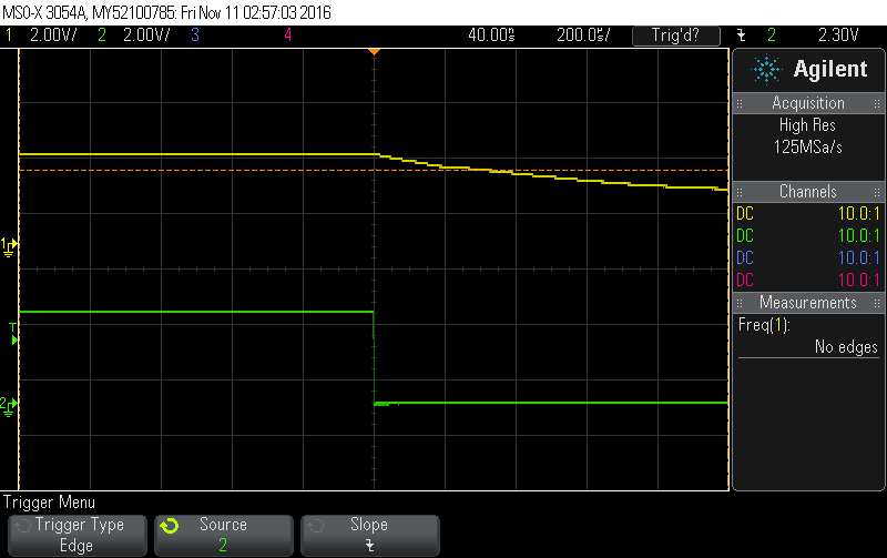

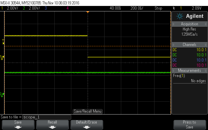

  • Hello Eric
    OK. Let me try something very simple for VDD3OFF mode.
  • Hello Eric
    Attached is a simple RTC wake only with VDD3OFF. I have tested it and it is working for me. The code attached can be used on your device to test if VDD3OFF is working as expected or not. The manner in which the code is written, is such that it goes into hibernate for 10 seconds and on wakeup it will be stuck in a while(1) loop of the default interrupt handler. Attached is the scope snapshot as well where the VDD supply ramps down. Clearly there is no 20 us time where the HIB comes back up.
